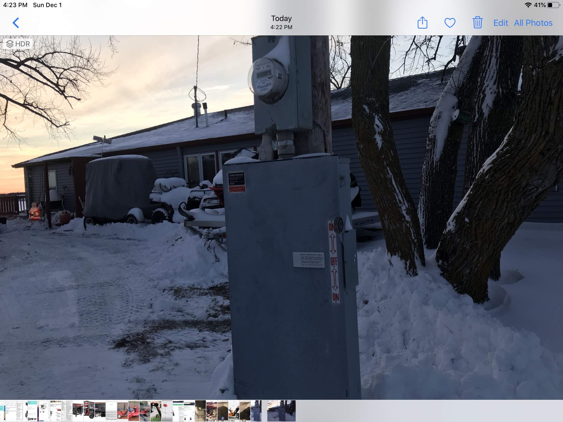

Here is what I run my generator into for my home, had it added to my service back in 98 after a 4 day power out in the winter, would be nice if it had a auto switch but it works for us for what use it gets. I have a 40ft cable that is plugged into the bottom of the 200 amp box and then the cable runs down to my basement door, just have to start the gen and plug it in after I move the switch. When I see the power back on around us I go and shut the gen down, unplug it and go to the pole and move the switch to is proper spot.

Here is what I run my generator into for my home, had it added to my service back in 98 after a 4 day power out in the winter, would be nice if it had a auto switch but it works for us for what use it gets. I have a 40ft cable that is plugged into the bottom of the 200 amp box and then the cable runs down to my basement door, just have to start the gen and plug it in after I move the switch. When I see the power back on around us I go and shut the gen down, unplug it and go to the pole and move the switch to is proper spot. Up is on Grid power and Down is for off Grid power.
