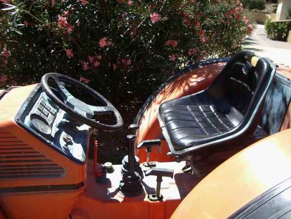

Egan and really everyone, Many thanks for your help. Do to the time difference, there is a delay in my response. I will post some photgraphs I just took. It will take me a couple posts to get them all on here. This first one it the tractor. It is a Goldoni 3050 DT, it is a Diesel. My husband does not know if it is 4 wheel drive. He says the farm worker already told him to back up and down hills. Didn't see any seat belt in the tractor but perhaps it is in the barn.

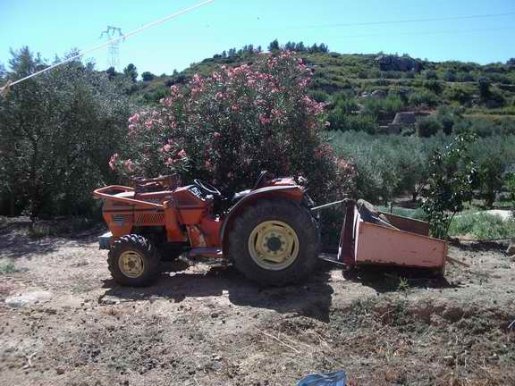

Micro Pilot and all, here is a closer vier of the tractor.
