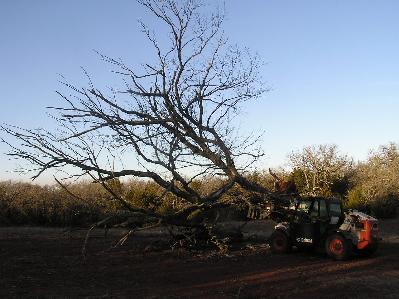

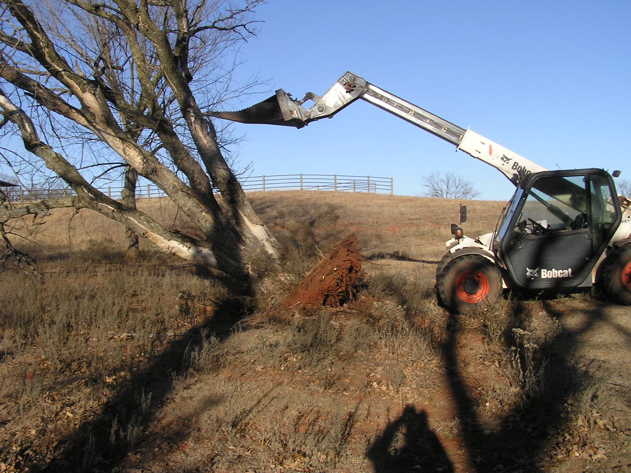

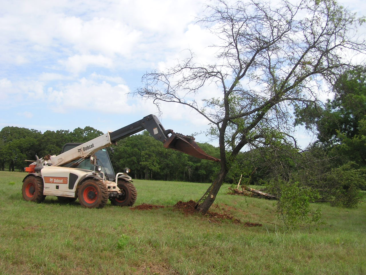

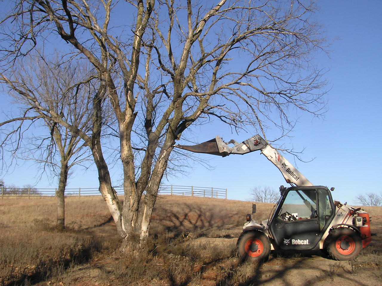

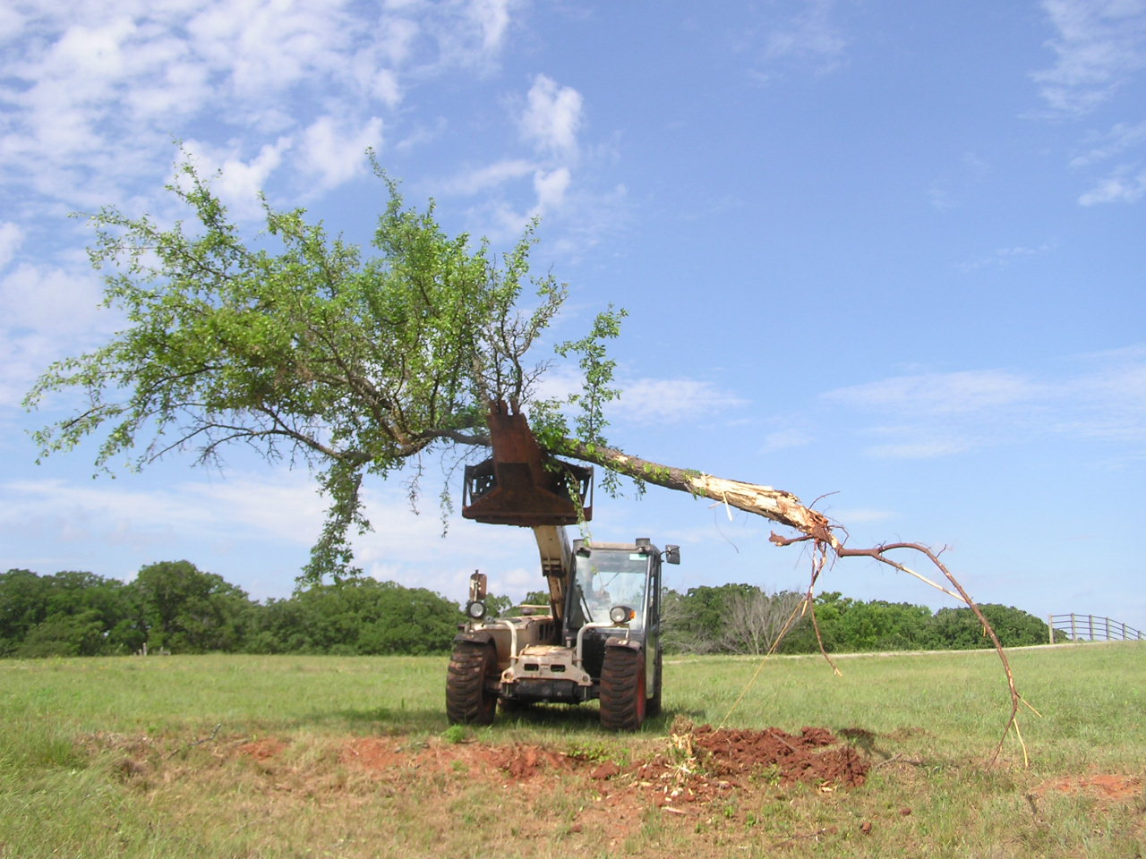

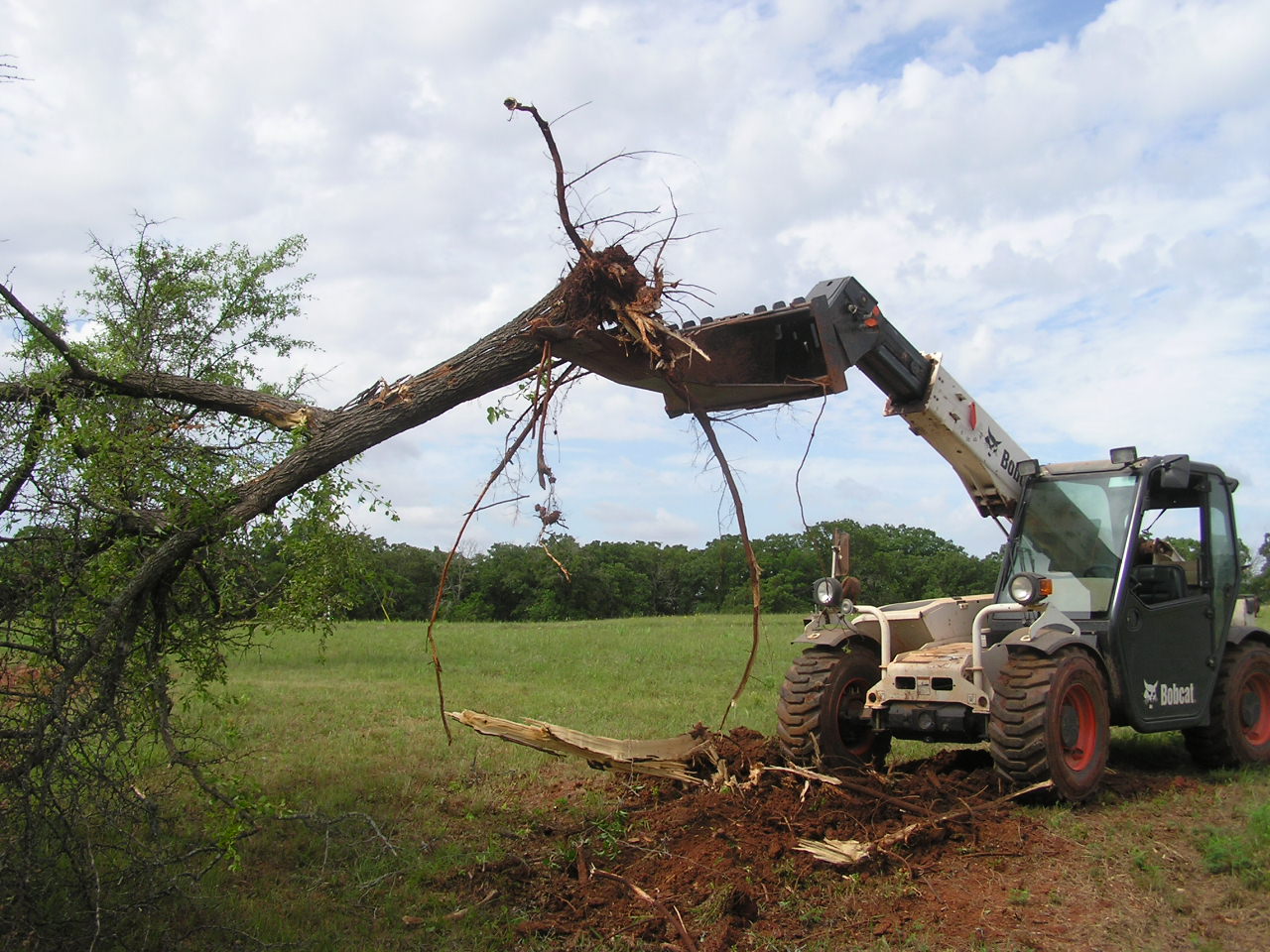

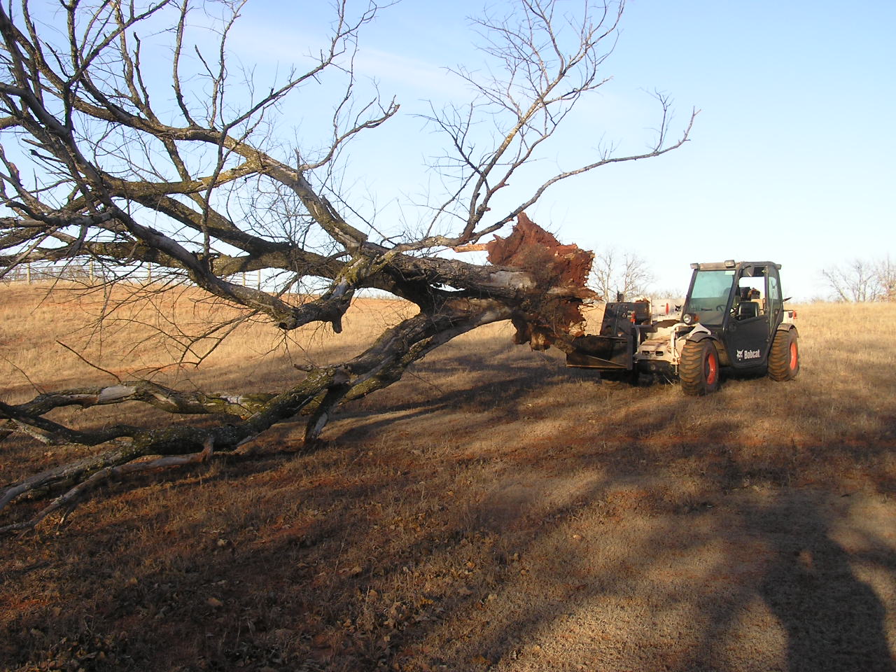

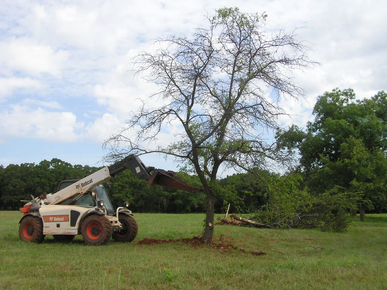

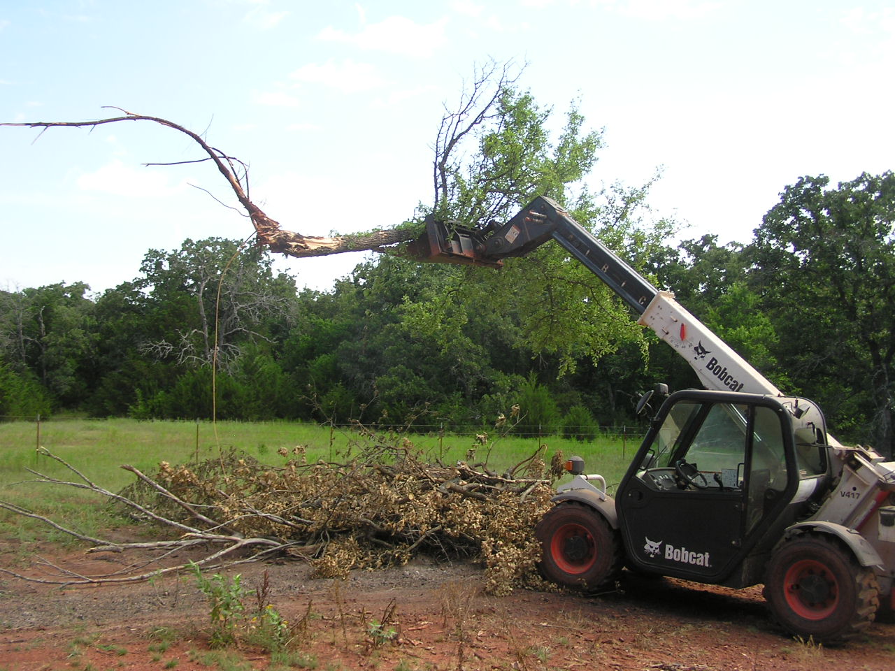

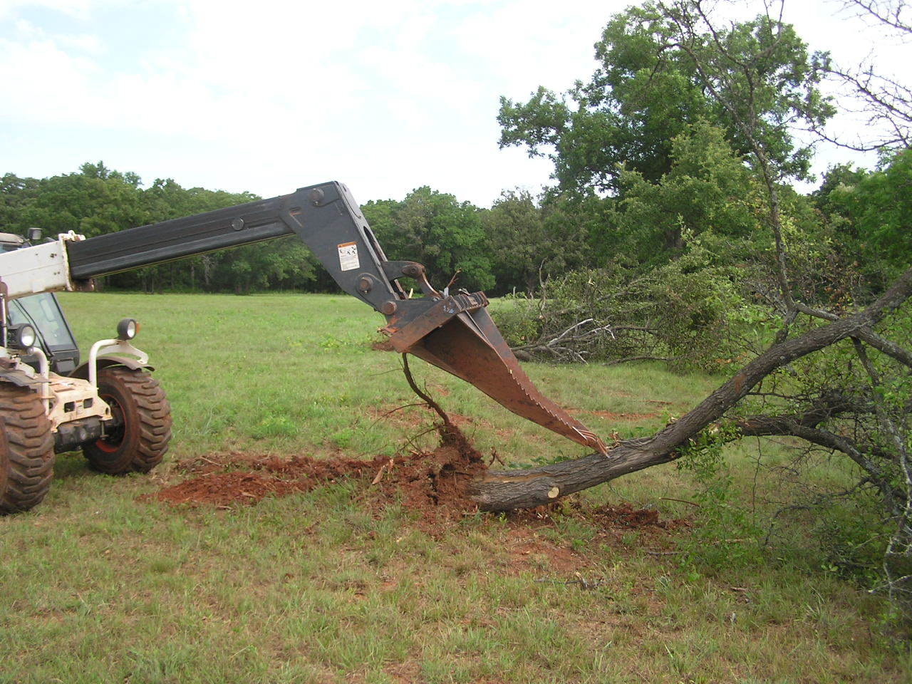

Using the stump bucket to get rid of some trees in the pasture.

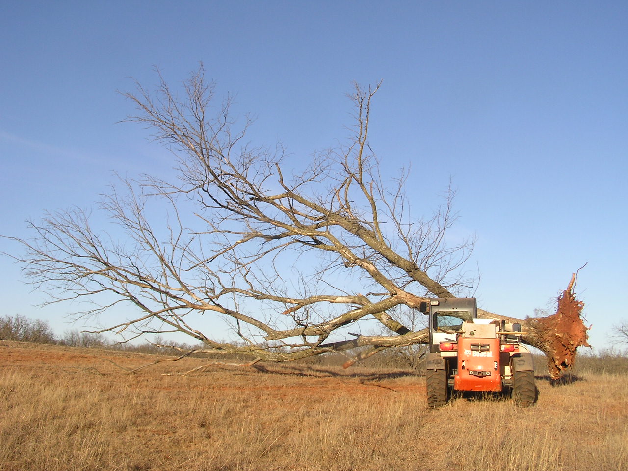

Pulled up the roots, found the balance point and no-grappled it to the pile that is in the background in the first picture.

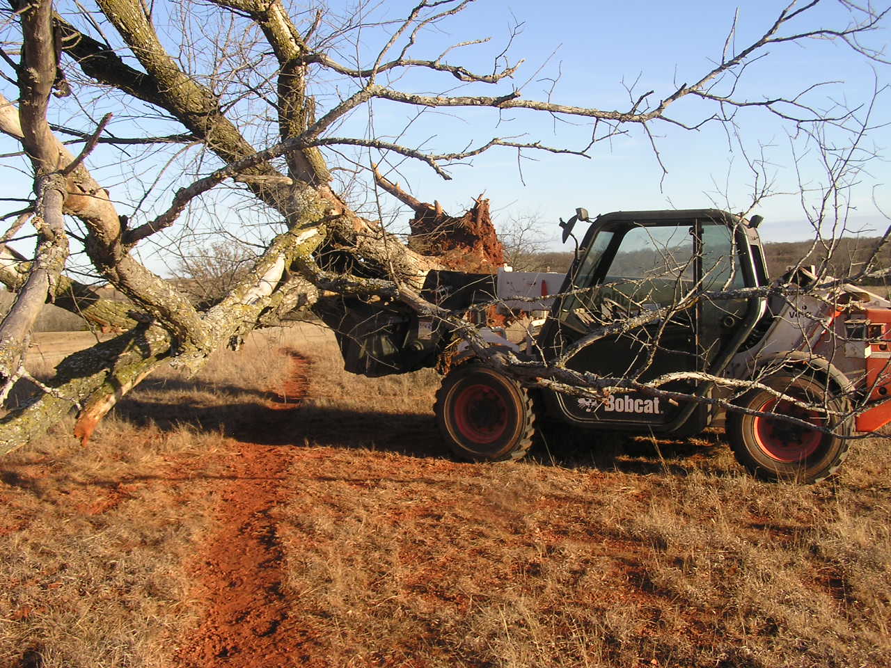

This one I no-grappled to the burn pile.

Using the stump bucket to get rid of some trees in the pasture. <img src="http://www.tractorbynet.com/forums/attachment.php?attachmentid=472941"/> <img src="http://www.tractorbynet.com/forums/attachment.php?attachmentid=472942"/> <img src="http://www.tractorbynet.com/forums/attachment.php?attachmentid=472943"/> Pulled up the roots, found the balance point and no-grappled it to the pile that is in the background in the first picture. <img src="http://www.tractorbynet.com/forums/attachment.php?attachmentid=472944"/> <img src="http://www.tractorbynet.com/forums/attachment.php?attachmentid=472945"/> This one I no-grappled to the burn pile. <img src="http://www.tractorbynet.com/forums/attachment.php?attachmentid=472946"/> <img src="http://www.tractorbynet.com/forums/attachment.php?attachmentid=472947"/>
Just wicked.

Found the balance point on my "no lid grapple". :D
Put it on the burn pile
