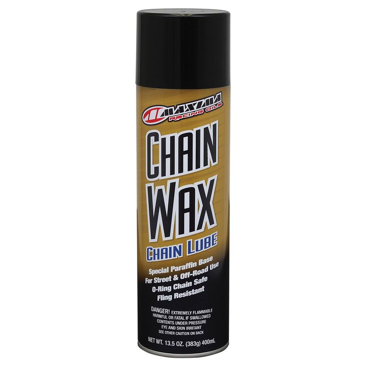

motor oil flings off in a very short time.
Bar and chain oil has "tackifiers" added to keep the lube on when the chain goes around the corners.
Motorcycle wax type chain lubes are the best. They penetrate into the rollers where the lube is needed, then the solvents evaporate, leaving a waxy film.
My Favorite!

That's what I always used to use on my dirt bikes. Maxima Chain Wax.
But then I watched some you tube tests like the one Fort Nine did testing chain lubes and I fell on the side of no lube at all on o-ring chains.
They last longer with no dirt stuck to them.

right!
o-ring chains are "sealed for life". Any additional lube only sticks on surfaces where it does no good.
But the OP did not mention O-ring chains< and Wax is better than grease. IMO.

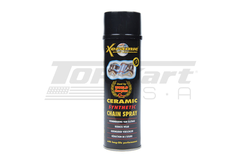

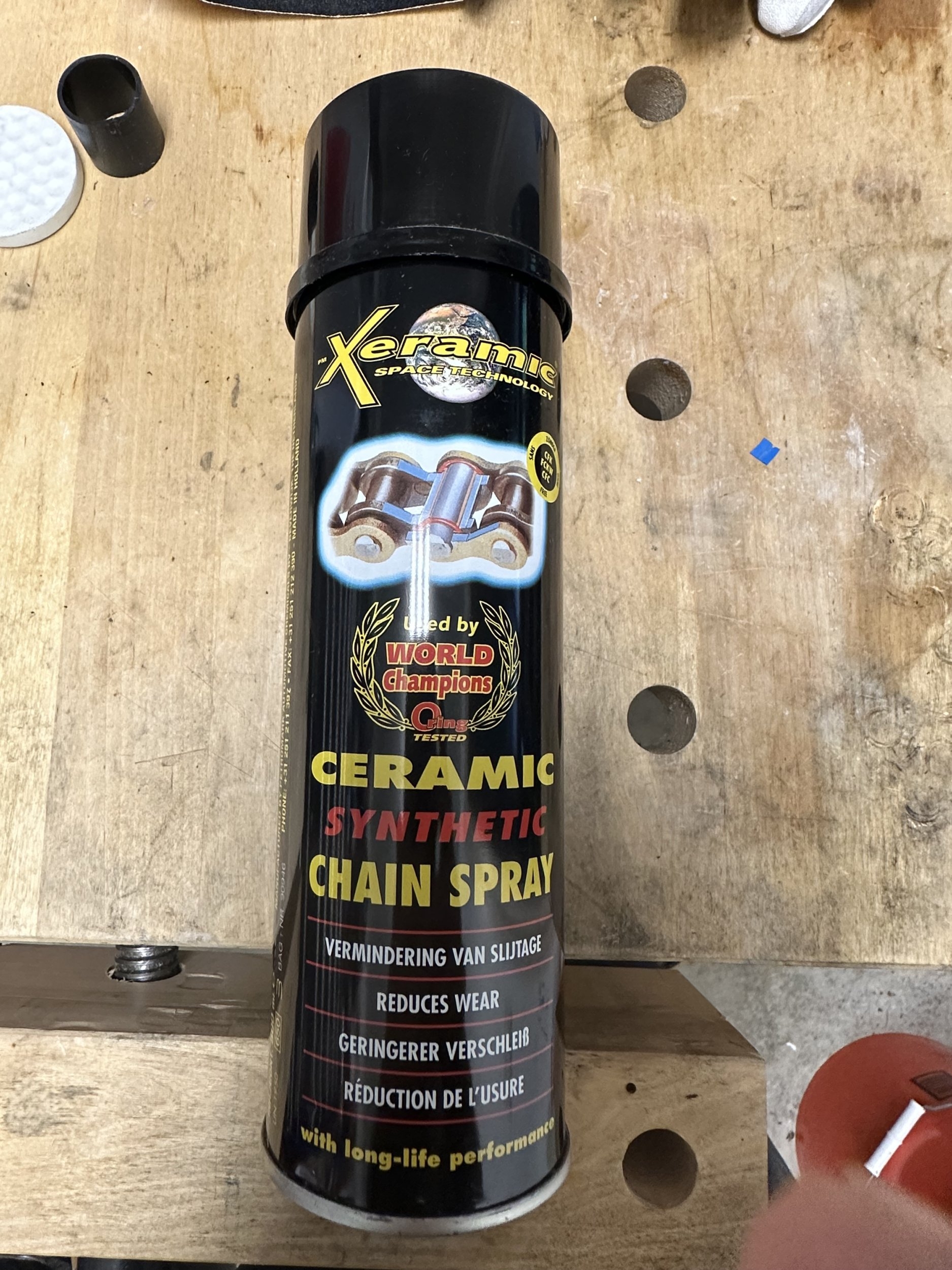

Good points and tricks raised here! Agree w OP that using motor oil for the most part is not very effective, as it flings off quite quickly, even at lower speeds.
From the world of high speed chains where I liked to play, like motorcycle roadracing and karting, one of the most favored lubes out there is a ceramic based lube made in Holland, called “XERAMIC” It is compatible with traditional links as well as O-ring links, and it lasts a long time, even at speed. Very little throw-off, and no gumminess. It’s available at motorcycle shops and online
I have also used the MAXIMA and that’s good, too.
