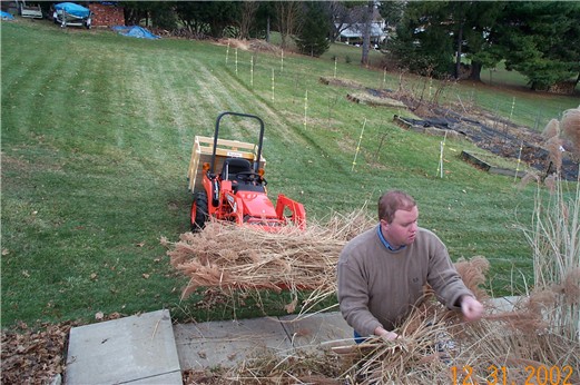

I battled the deer for many years. I tried everything from egg concoctions to Iris Spring soap but nothing worked for me (the IS works fairly well). One of the problems with repellants is that they wash off when it rains. Finally I installed an electric fence around the fruit trees and the garden and that solved the problem. For the past four years I haven’t had any damage to areas that I have fenced. My fence is three strands with the highest strand about 40 inches off the ground. I have it on a timer that activates it at dusk and turns it off at dawn. During the first month of installation I baited it with foil coated with peanut butter. The deer quickly learned respect for the fence. It is not uncommon for me to turn our spot lights on in the evening and the deer will be bedded down around the perimeter of the fence. I counted 12 one evening. Even though they could easily jump the fence they stay clear. Now if I could only find a way to keep the groundhogs out I would be set.
The attached picture shows the fence around some young fruit trees that I planted a couple of years ago.
The electric fence is inexpensive and very effective. I bought all of my supplies at TSC. Fence charger, wire and 60 in fiberglass posts.

I am quite interested in the fact that your fence is only 40" high, yet is stll effective. I may rethink my much more massive and complicated fending plans.

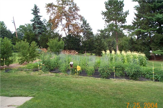

Maybe I'm just lucky or maybe Michigan deer are smarter than Pennsylvania deer. I fence an area about 60 feet by 70 feet and they don't touch my garden. You have to be careful to install and maintain them properly. Many people that install electric fences have inadequate grounding or have their fences shorting from weeds touching. If the deer find that it is not operating they will go through the fence. I think they periodically touch it with their noses. I have seen them cautiously approach the fence until their nose gets zapped. The other deer in the herd watch curiously to see what happens.
Several other people in my neighborhood have tried electric fences and have the same results that I do. It works here.
