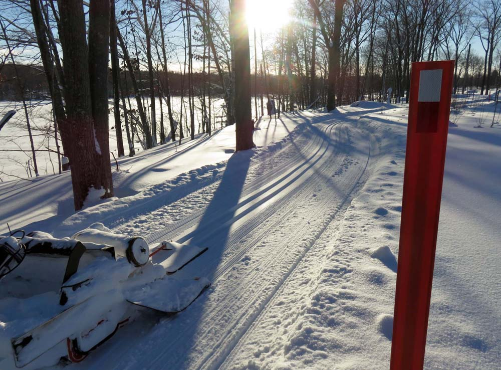

I'm not sure the OP wanted to get into the nuances, he just wanted to knock his snow down for walking without spending any $$. I'd say not spending any $$ seems like a plan to fail.
Levis mounds near Neillsville WI is groomed by a friend of ours.
Snow groomers.net does not make implements used by any serious XC trail systems.
Here is a photo I took a few years ago. Note the width of this trail.

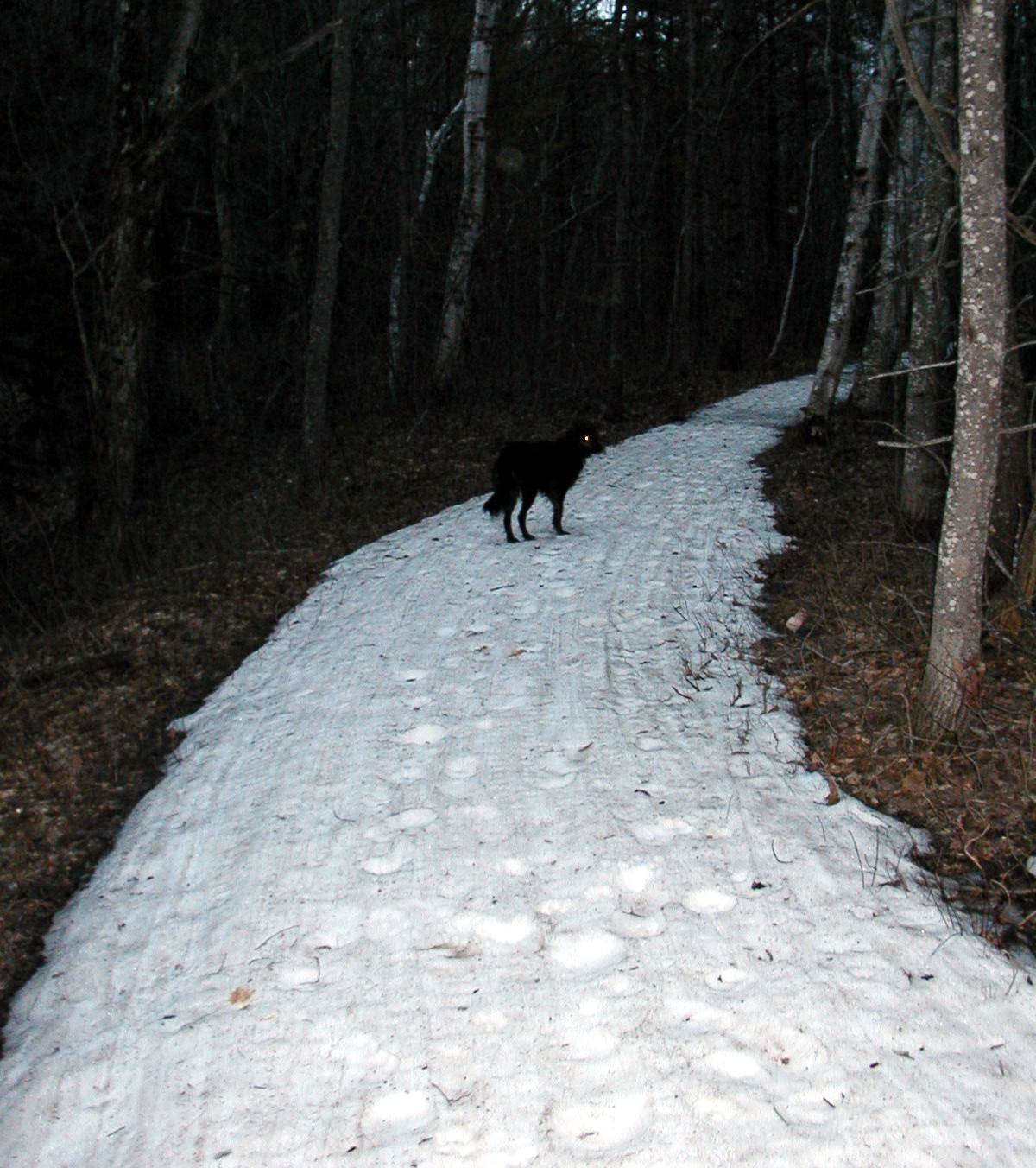

I'm not quite sure what you are saying. Leveled and packed snow does last well into spring and you should be able to walk on it. All the snow machines I operated for the past 10 years, did not require any snow.
   / How to maintain wooded walking trails #29
Depends on where you live.
I still have a couple hundred square feet of hard pack snow in my back yard here in the city. Just came in from shoveling the latest spring snowfall off of it. It’s basically ice due to the spring freeze-thaw cycle. However the rest of the yard is now soft wet lawn that I don’t even want to walk on.
So hard pack can persist and stay walkable quite a ways into springtime here.
