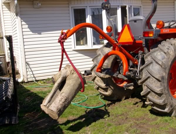

I too would would recommend a thumb. Doesn't need to be hydraulic at all for what you're wanting to do. But thinking along the lines of a sling is a cheap and safe way to handle rocks and boulders. Or a type of mechanical boom grapple would work great. You can buy or make one pretty easy.
It's sort of like a pallet puller or tongs concept, except for vertical lifting.
I never thought of it that way, you could make a set of sized down pallet forks for the bh bucket. maybe even have them set up to be reversable, just something to slide under the rocks and pick them up, hmmmmm

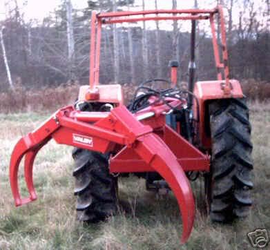

I would make one with 3 jaws instead of just 2 or have the tines be real "jaws" like a grapple.
I found this interesting and site for "Boom Grapples" Here is their Home Page They have jaws to stabilize the load. I think a guy could make a mechanical one fairly inexpensively using a pallet fork or log tong principle.
Here are some photos I borrowed.

I made my backhoe thumb mechanically articulating so I'm thinking it should work for what I'm planning to do. It took a little bit of work but was also a DIY project and relatively cheap to make. But maybe a boom grapple might be better? Here are some shots of my articulating backhoe thumb where I can pick up rocks or logs and place them with accuracy.
So it is pretty handy.

Those grapples are great !!! I was just thinking that instead of having a bucket on the BH you would have a small set of pallet forks, if you could somehow have the forks reversed, (forks facing away from the tractor) you could slide right under the rock, then dump into position. I agree this grapple would be a hole lot easier though.

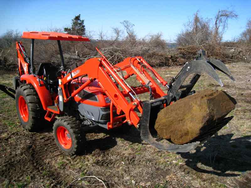

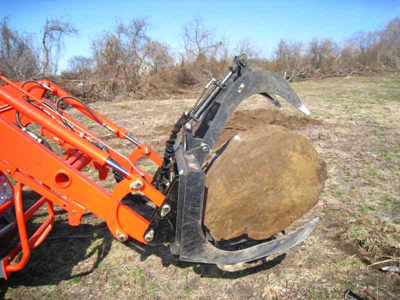

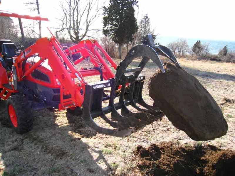

Here are a few more rocks from New England soil uprooted by a grapple. The big ones are not much trouble. Smaller than a foot or so across and they tend to bounce out between the tines when traveling.
They can be placed very accurately though with the FEL/grapple. I know some guys are excellent with backhoes but my FEL technique is a lot smoother than my BH so if I were trying to place one of these boulders in a tricky spot, I'd use the grapple.
Ed, those lower teeth look pretty impressive, I'm just not sure 48" will be wide enough for me. Sure would be nice to be able to push an area greater than my wheel width.
It'd be no problem for brush work, it's the dirt/rock/root stuff I'm thinking of..
So.. Spending extra dollars and getting what I think I need... vs getting something a little more affordable.:confused: Affordable and less weight to subtract from the maximum loader capacity.:)
