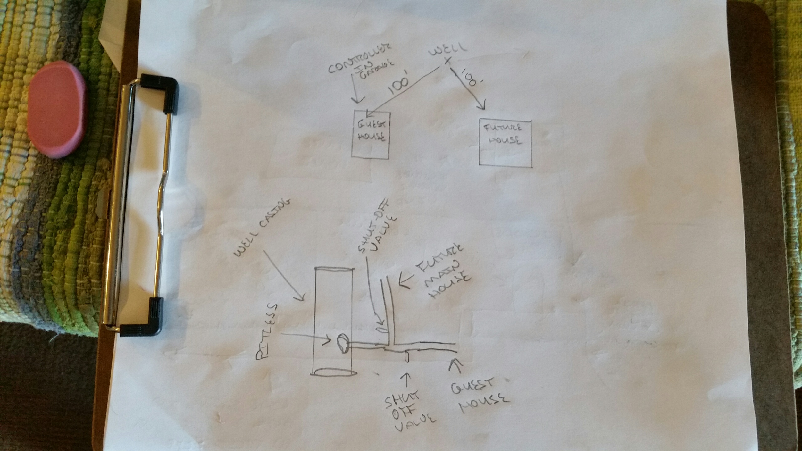

So I CAN run two separate lines from the well using a "T" valve to split them (one for the guest house and and one for the main house).
SEE ATTACHED DETAIL -
So being it's a closed hydraulic system, once I turn on the water in the future main house, the water will flow from the line from the well and then then the guest house line will begin to drain back and cause the controller in the guest house to sense the pressure loss and kick on the well pump.
Is that correct?
So there shouldn't be any problems or issues later if I do it with the above way, correct?
Yes, except the one line does not "drain back", the pressure in it drops but there will be no water flow. But be careful that you have no check valves on the lines after the "T"

Perhaps, to make it a little less confusing, you just need to look at it a little differently - it all seems to be in the "terminology"
You are actually going to run ONE mainline with two branches. At the point you "T" to take one line to each house they become "branches" of the same mainline - even if the "T" is right at the well.
Where is the pressure tank and switch?
Is the well at the garage or do you have to run from the well to the garage?

The pressure tank and switch are in the guest house garage. The well is 100 feet away and an underground water line will run to the guest house garage.
See this diagram:
Bingo.
Stop thinking of two different houses. It's one well supplying a bunch of outlets (sinks, tubs, toilets, faucets). The fact that they are in two different buildings is not really important.
And THAT is the all-important question. Decide where you want that, and all the rest of the decisions flow from that.
There are a lot of ways to do this. There are a handful of good ways to do this. There is no ONE right way, and no ONE best way.
Don't make this complicated. Water flows from high pressure to low pressure. Unless there are valves in the way (check valves or regular valves), the pressure equalizes everywhere in the system. You need ONE controller, but you can have multiple pressure tanks if you want to. You can also have booster pumps.
Take that basic information and figure out what works for you. It's that simple.

I'm confused now. Some are saying to run a single line from the guest house and then split it. Others are saying to run two main lines (one to each house) and just have the controller in the guest house garage.
With a normal pressure switch/pressure tank, you can tee off at the well to one house and have the tank and switch at the other house, as long as you don't put any check valves above ground.
But you should check with the manufacture, as I don't think you can do that with a VFD system. At least I know you cannot do this with the Sub Drive/Mono Drive type systems. The transducer is basically at the dead end of a line when the other house is using water, and the pressure will oscillate rapidly. I know this because I use a Cycle Stop Valve to solve this problem for people everyday. They go back and install a Cycle Stop Valve before the tee at the well head. The CSV1A is set slightly lower than the set point of the VFD. This keeps the pressure transducer from seeing the set point pressure, the pump just runs at full speed, and the CSV1A keeps the pressure constant no matter which house is using water.
I think with the VFD system you will need to bring all the water past the pressure transducer before you tee to the other house, or the pressure will fluctuate. At least I know it does with the Sub Drive systems.
