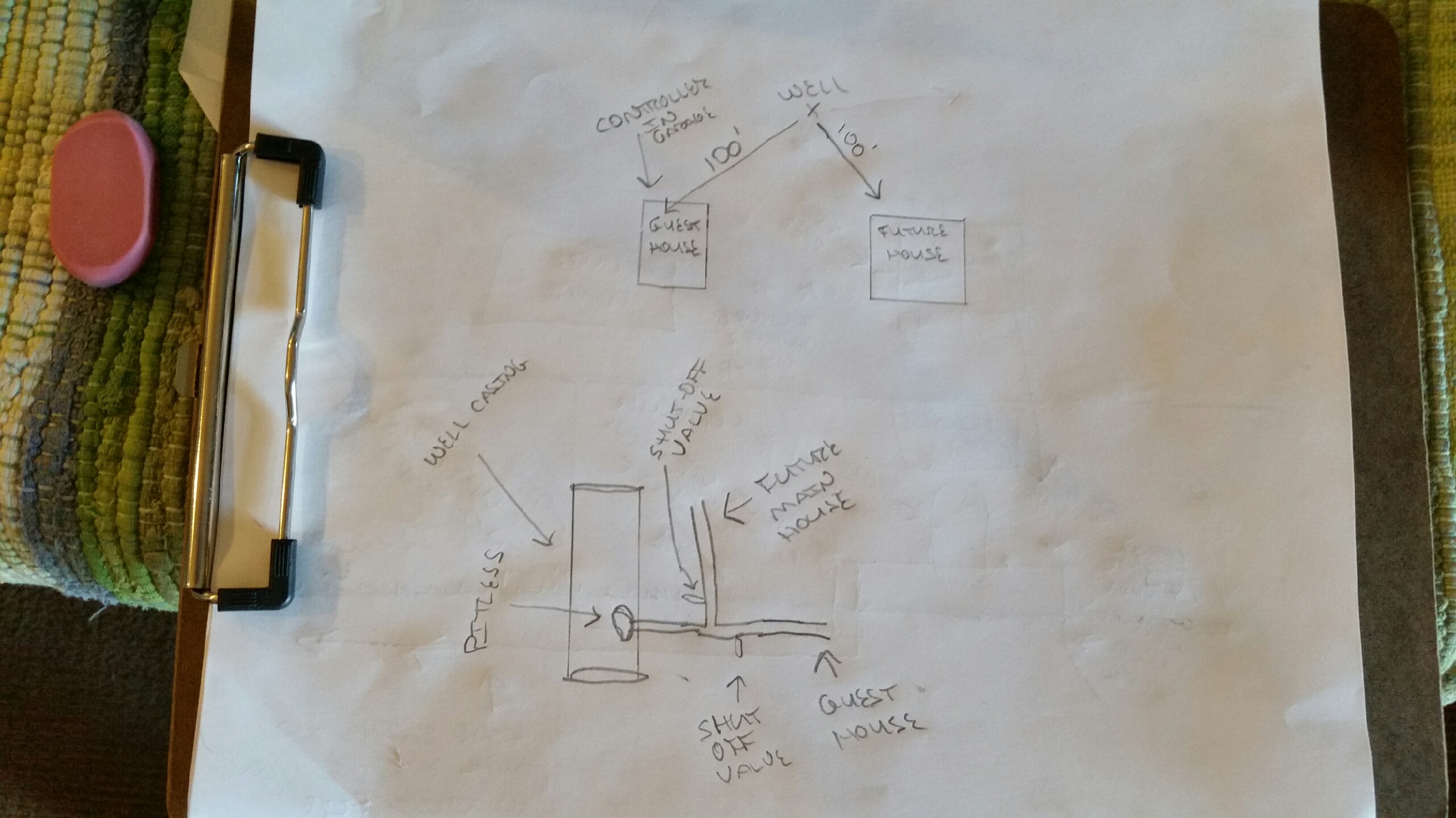

The future main house will be a few feet higher in elevation (maybe 5 feet).

So you are saying I can "T" off near the well and run one line to the guest house and one to the future house and still just have the controller sit in the guest house?
If you turn on the water at the main house, how will the pump know that it needs to turn on?
It's a closed hydraulic system, pressure is the same throughout (static), It may take a bit for the controller to see the pressure drop there when a tap it turned on but it would be inperceptable.

So I CAN run two separate lines from the well using a "T" valve to split them (one for the guest house and and one for the main house).
SEE ATTACHED DETAIL -
So being it's a closed hydraulic system, once I turn on the water in the future main house, the water will flow from the line from the well and then then the guest house line will begin to drain back and cause the controller in the guest house to sense the pressure loss and kick on the well pump.
Is that correct?
So there shouldn't be any problems or issues later if I do it with the above way, correct?

I live in Florida so freeze is not a problem. However, what we do have is four houses/buildings being fed from one well.
We have a 4" well with a submersible pump. In our case, since "basements" are not a common (or practical) thing in Florida, we have all the controls at the well. My house is 400 feet in one direction from the well and my Brother's house is 600 feet in the other direction - so, we have 1,000 feet of 1.5" mainline.
In your drawing it looks like you will have the controller in a free standing garage. Since the pressure switch sits on the mainline before it leaves the garage, and water drawn from it will be able to turn the pump on. If this is the case, feeding the other locations is simple, depending on how bad your areas freezes.
In the simplest way, just bring you mainline out and head toward the house(s). At some point, put a "T" and run one line to each house. Put a check valve where the water enters each house. Add an additional "T" in the mainline for any outside faucets/hydrants you would like.
If you don't have to great of a concern about in-ground freezing, you could place a "T" (or two) in the mainline just outside the garage and put a shutoff valve on individual lines running to each house and one for any outside watering. Put these valves in Irrigation Valve Boxes (the deep rectangular ones).
If ground freezing is a problem, you could always build a manifold in the garage (with cut-off's) and run each line out through the slab.
As long as the pressure switch is BEFORE the manifold or T's, the system will work fine regardless of where the water is used.
(think about it ... turning on the kitchen faucet downstairs or filling the tub upstairs makes no difference, the pump still works as it should. The same holds even if the kitchen faucet was in one house and the tub were in another)
BTW - we have had our system in and working for 40 years and we can never tell when water is being used in any of the other houses/buildings - and we only have one pressure tank ... it is at the well with the controller.
