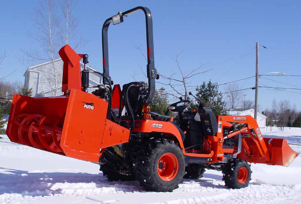

About driving backward with a snow blower.
1- Once you have a remote valve installed a snow blower mounted on a 3PH is not too expensive. You can choose which brand and width you want. Afterward, if you want to sell it, it's easier because anybody can connect it to a 3PH.
2- You are nearer the snow blower. So you have a better point of view. On a small tractor like a BX23, a front snow blower is ok too but with a bigger one it's harder to see over the hood the front of the snow blower.
3- At first, I didn't like it, but you get used to it very quickly.
4- With a snow blower connected to a 3PH you can lift it higher than a front one. Very useful when the snow plow gives you a 3 feet high hedging because you can still blow with the blower lifted at maximum (about 30 inches). I'll post a pic of the height.
5- With the snow blower mounted on the back of the tractor you keep the loader on it... very useful too.
6- With the loader (around 450 lbs) and the snow blower (about 405 lbs), the tractor is heavier... better in winter.
Yes I have a license plate on it.

On this pic, the height of the blower fully lifted. As shown on this pic, the bottom of it is 16" high and it has a cutting height of 24 1/2". So you can easily blow a hedging of 40". If you need more... use the FEL. /forums/images/graemlins/smirk.gif
About the license plate. If I use the tractor only on my property I don't need a license plate. But if I want to drive it on the road, then I need one. Here in Quebec we are liable for material damages only. You buy insurance from a private company to protect you against material damages. The private insurance company takes care of that bumped fender. If you have an accident, if you have injuries and you need medical treatments or surgery, the government will pay for that. Here in Quebec, license plate fees are splited in two: the first part is your registration fee (the right to be on the road), the second part is your insurance contribution (insurance covering physical injuries).
So to have the right to be on the road with my tractor I need a license plate. But if I stay on my property I can do as I wish without any license plate.
Exemptions apply to vehicles stored at businesses, farm machinery or recreational vehicles that come under the regulation. But I don't know much more because I'm not a farmer.
In facts it's simple, but I'm simply not the one to explain it in details. sorry
Enjoy the pic /forums/images/graemlins/grin.gif
