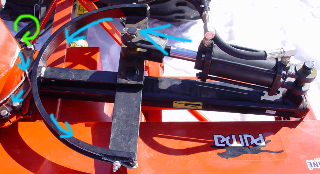

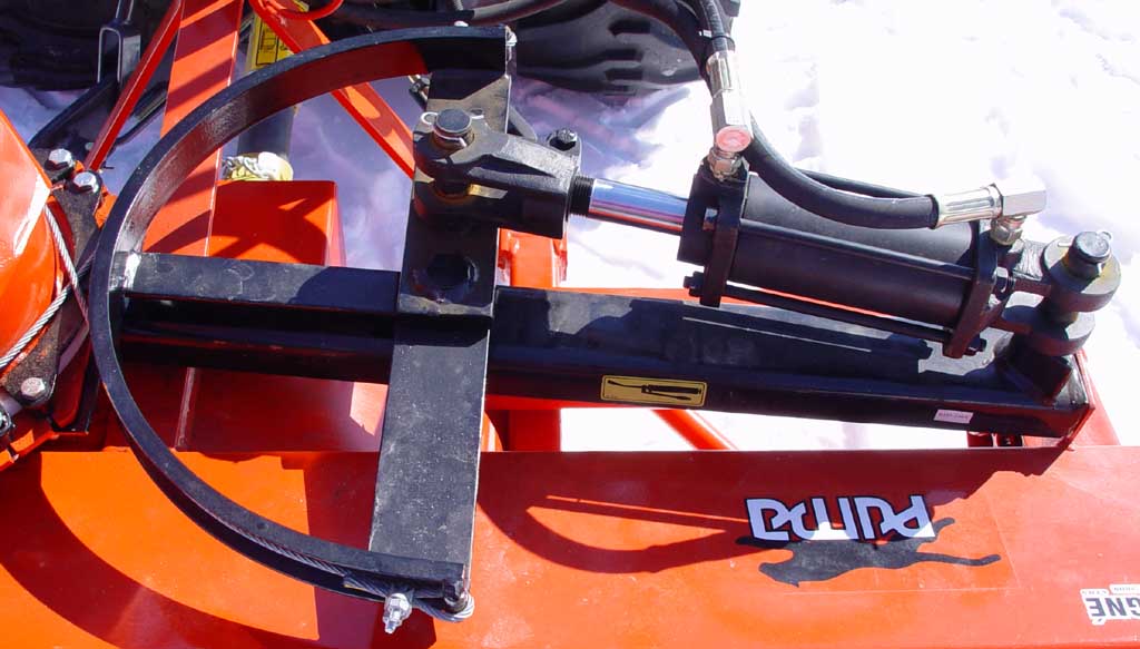

Ok, I have 3 pics for you. This one gives you a better point of view.

On this one, you can see what happens when the cylinder comes out.

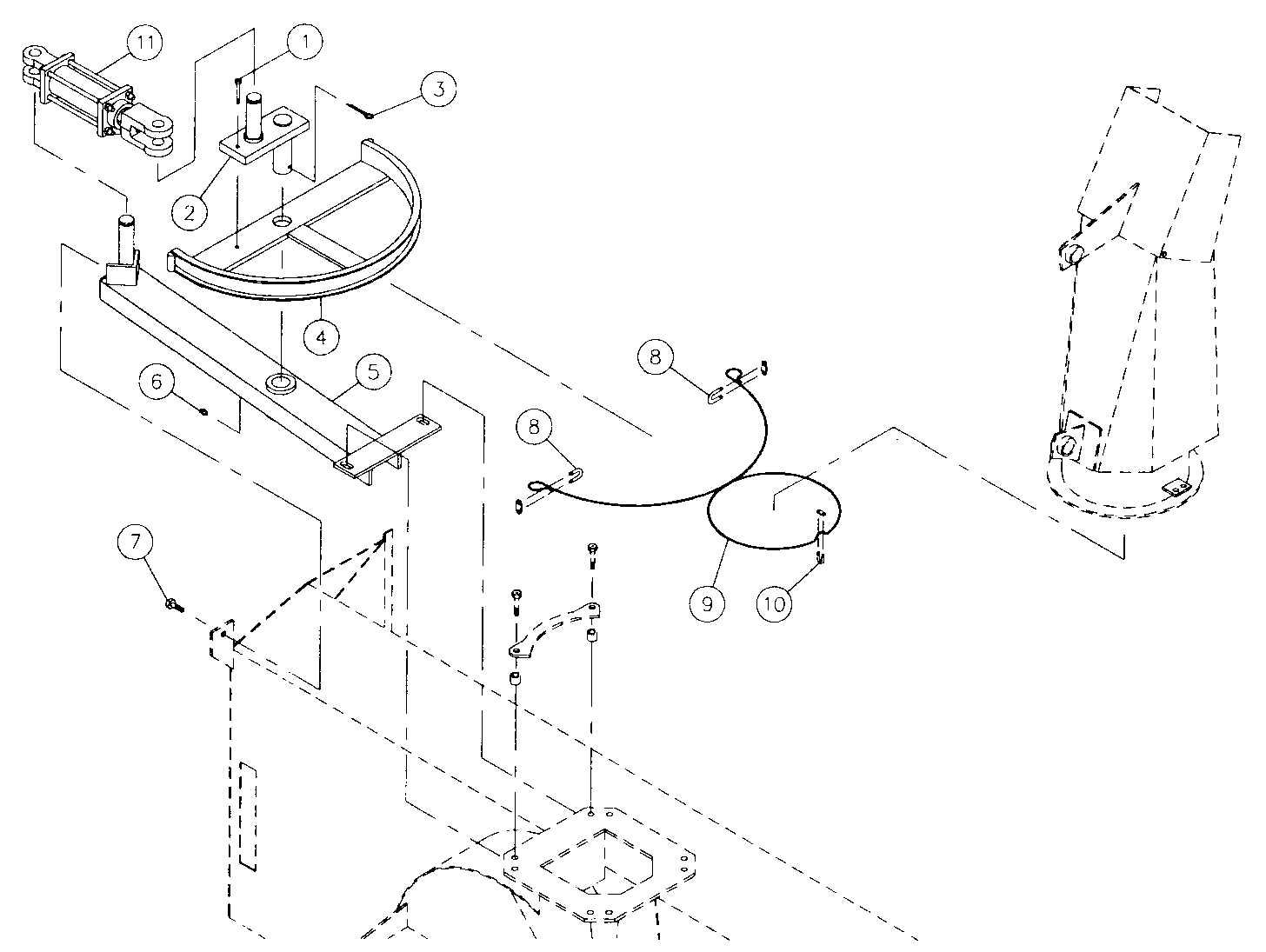

This one is not a pic but a diagram. /forums/images/graemlins/crazy.gif
(9) is the wire attached on each ends of the arc (4) and it goes all around the chute (eight pattern). Note the "U" bolt (10) in the middle of the wire on the other side of the chute: this bolt is very important to pull the chute on one side or the other. The cylinder (11) push (or pull) the arc and moves it because it's off center.
The mechanism is very strong and you don't want to put your fingers near it when it moves.
Enjoy the pics and the diagram /forums/images/graemlins/grin.gif

   / How to push a BX23 to the limit #26
Thank you for taking the time to take all those pics; they're great.
Enjoy your tractor, I know I enjoy mine...
