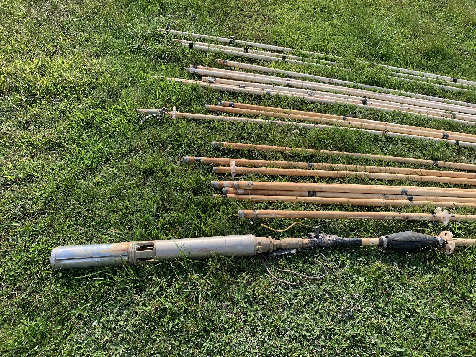

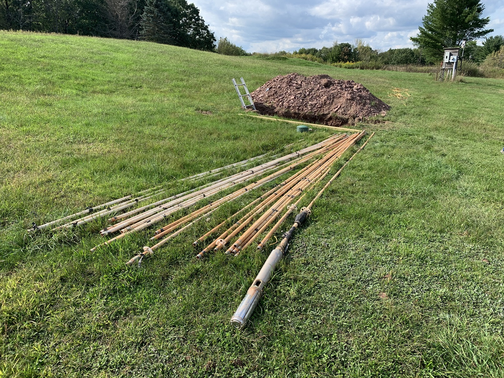

Success!
The well guys were able to use the camera to attach a tool to the recovery socket on the top of the broken pitless adapter.
It took them about 2 hours to pull 21 lengths of 20' PVC pipe and the pump from the well using a boom truck. It was touch & go for a while since the tape holding the wire to the PVC pipe had broken in many places. Had the wire fallen completely into the well alongside the pump, there would not have been enough clearance in the 4" packer to pull the pump & wire together. Luckily, the tape held on the 5th section of pipe and they were able to grab the wire.

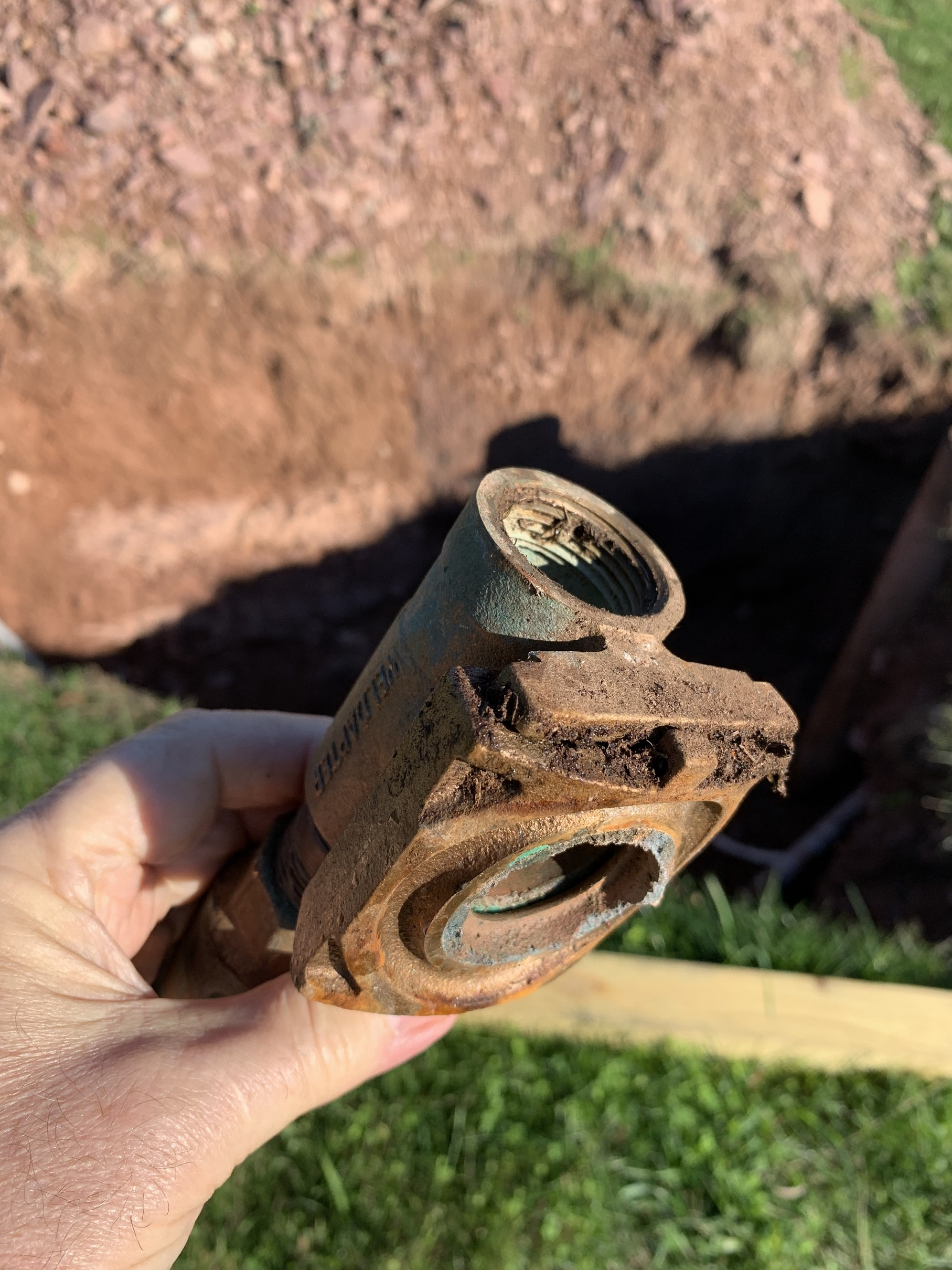

The culprit was the pitless adapter which cracked and began leaking over time. Eventually, the weight of the pump & pipe caused it to fail completely.
I'm having the 33 year-old 1 HP pump replaced and the 20' PVC pipe sections with black poly pipe as well. I should be able to re-use the 420' of 10-2 wire which will save a few $$.
IMO, in the end, it was better leaving the job to the pros instead of trying to do it myself. The bill will be around $4K which is certainly cheaper than a new well. It will also maintain the property value of the subdivided lot should I ever decide to sell.
Thanks to all who offered ideas, suggestions & moral support! (y)(y)(y)

Thanks for the pictures and glad to hear it worked out for you.

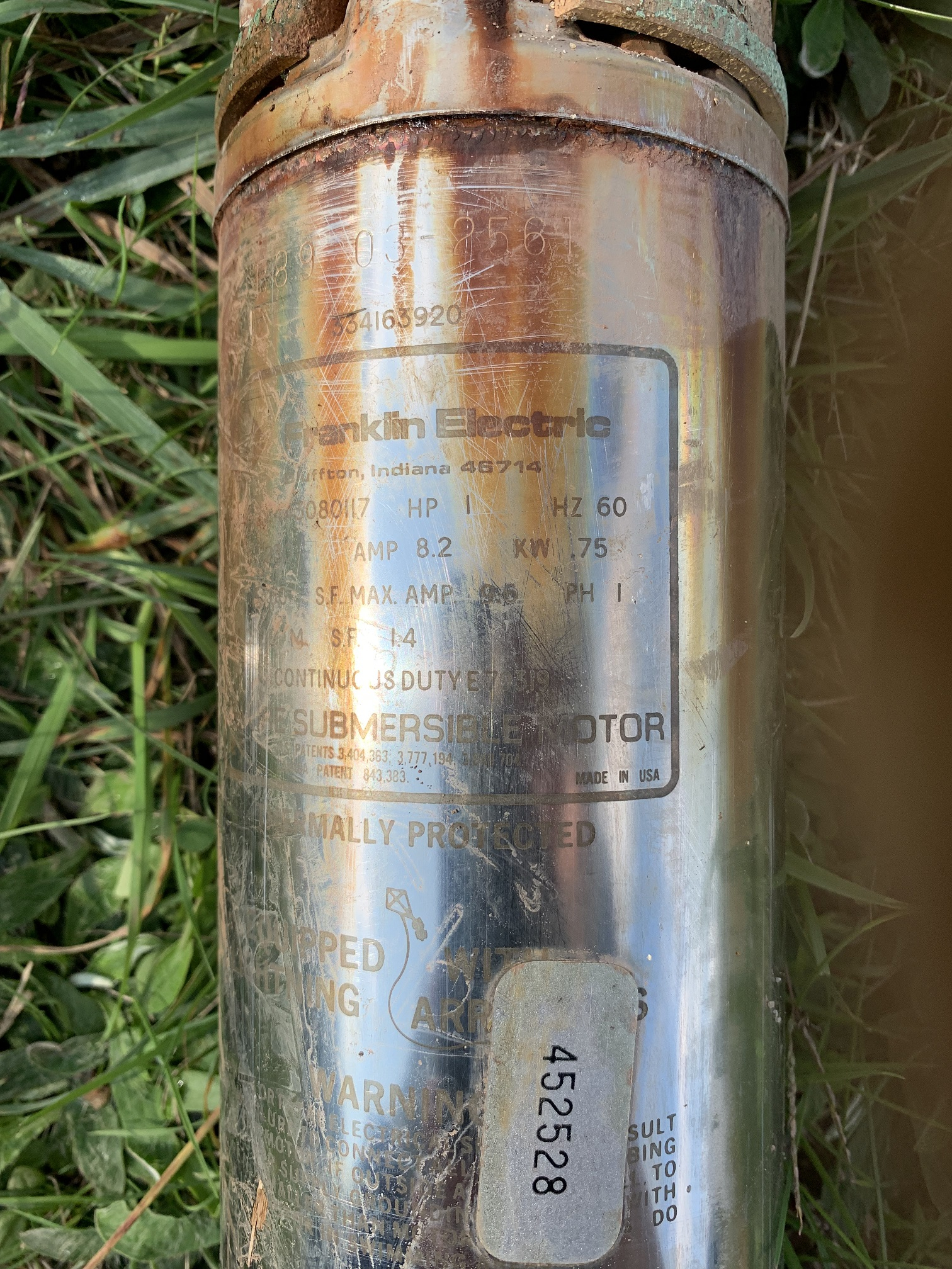

It would also be interesting to see if or how they will use a torque arrestor since you only have 4" of clearance around the packer so makes the arrestor really not function as intended but there is one on the old pump.
The wells in this area which use poly pipe don't have torque arrestors. I assume the single length of poly pipe just absorbs the twisting action when the pump starts. Plastic spacers are used instead to keep the electrical wire from chafing on the casing.
The threaded sections of the more rigid PVC pipe could fail from torque stress though. That's why the old pump had an arrestor. The old one you can see in the pic is pretty beat up but it had a design that allowed it to expand after it passed through the packer.
