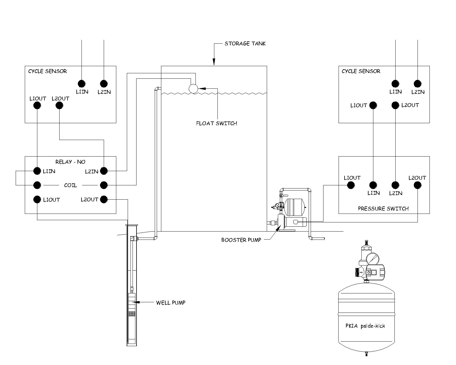

Sorry I missed that. It is unusual to have that many storage tanks ganged together, but I can see where it might be much less expensive than one huge tank. No matter if it is one big tank or a gang of small tanks there needs to be enough water in the storage tank(s) as needed. It is not like a well with an unlimited supply of water. When pumping from storage tanks or a well a pressure tanks only purpose is to limit the on/off cycles of the pump. The water comes from the well and/or storage tanks, not the pressure tank. So, the pressure tank can be very small if you have some other way to limit the cycling like a Cycle Stop Valve. Even with multiple pumps of varying sizes the pumps will either cycle off and on no matter how large the pressure tank, or can be made to deliver constant pressure without cycling the same way.
When pumping from storage tanks or a well a pressure tanks only purpose is to limit the on/off cycles of the pump. The water comes from the well and/or storage tanks, not the pressure tank. ..."
Wrong...at least with a standard, not cycle stop valve. Pump runs until the cut-off pressure is reached. Any water drawn until cut-in pressure is reached is coming out of the tank.
   / How to Recover a Lost Submersible Well Pump #192
A pump delivers water straight from a well or a storage tank to the taps. A pressure tanks only purpose is to store the excess water that the pump makes over what is being used. Then, as you said, the pump runs until the cut-off pressure is reached. At that point, water that "came from the well", is drawn from the pressure tank for a short time, to limit the on/off cycles of the pump.
When using a CSV or a VFD the output of the pump is changed to match the amount being used. Cut-off pressure is never reached while a tap is on. Water is going right past the pressure tank as if it wasn't even there. Water is coming from the source and a pressure tank isn't really needed at that point.
Water can also be supplied straight from the well without a CSV or VFD, but without a pressure tank the pump will just cycle on and off rapidly to supply what is needed.
The point is... A lot of people see a big 80 gallon pressure tank and think they have lots of water. In reality an 80 gallon pressure tank only holds 20 gallons of water. And that is when it has been filled with a pump from a real source of water, which is your well, cistern, or other supply. Having a huge pressure tank doesn't mean you have a good water supply.
