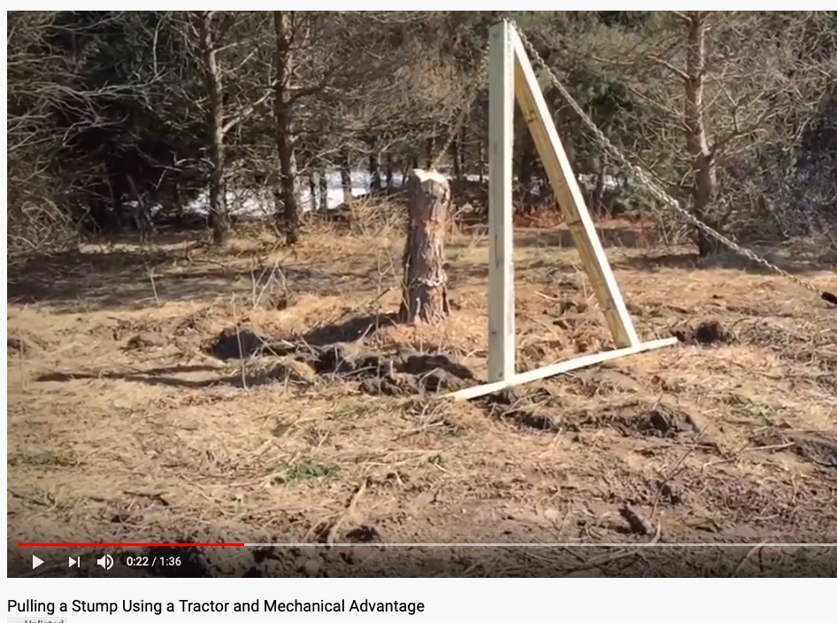

Pull it with a bipod, like a stump. But use a longer line so it can't fall on the tractor.
