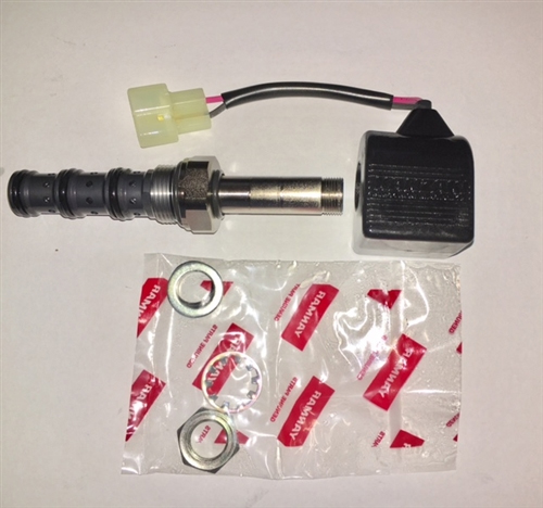

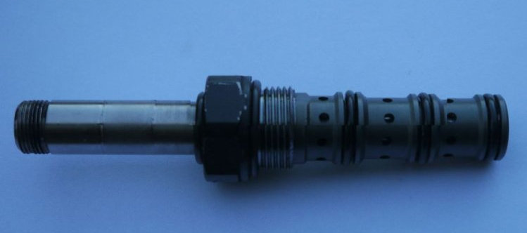

I appreciate the advice about the coil. But, let's assume that IF the coil is good, what I'm really wanting some input on is how the "shaft/valve" should react when it's energized by the coil.
Maybe there is a more proper name for it. What I'm calling the "shaft/valve" is the metal parts that inserts into the black plastic coil.
Here's a photo of a new complete Solenoid showing the coil and shaft separated...
