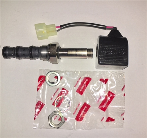

Here's a photo of a new complete Solenoid showing the coil and shaft separated...
Plunger... (also may be called armature).
Dale
   / how to test John Deere 2305 PTO Solenoid #26
I appreciate the advice about the coil. But, let's assume that IF the coil is good, what I'm really wanting some input on is how the "shaft/valve" should react when it's energized by the coil.
Maybe there is a more proper name for it. What I'm calling the "shaft/valve" is the metal parts that inserts into the black plastic coil.
The piece that you are calling the shaft is composed of more then one piece.
If you assemble those pieces (set the coil on the armature and secure it with the supplied nut)
when you apply 12 vdc to the coil you will see the inner piece move, that is actually a valve to allow hydraulic fluid
under pressure to flow to the pto clutch, when de energized it will allow fluid to return releasing the pto clutch.
Some solenoids will not move unless there is external pressure to drive it, this perticular one looks like it would.

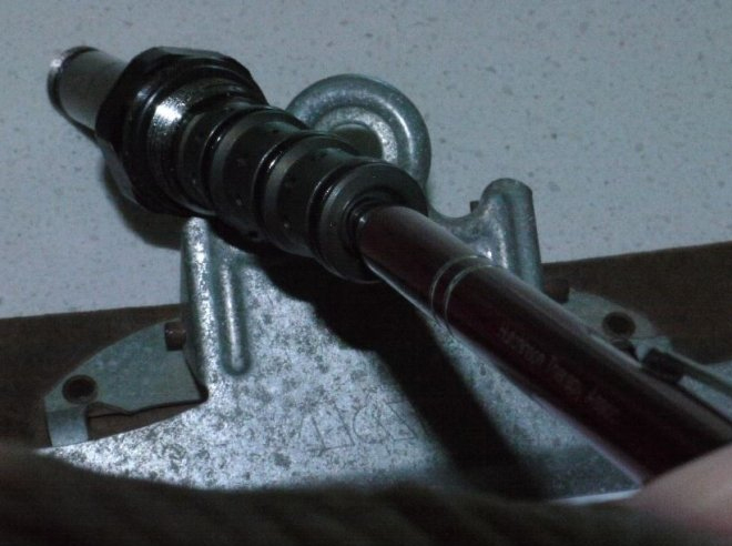

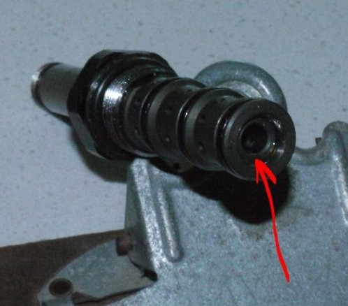

I found these photos posted by "Newbie 2" at tractorforum.com...
I'm so glad Newbie posted the photos because it was the breakthrough I needed in understanding how the solenoid operates.
In the first photo, the arrow points to the "piston" that rides inside the outer sleeve. You should be able to move the piston inward. In the second photo, Newbie is using a pen to push the piston inward. It will spring back outward on it's own, if operating as it should.
In my solenoid, the piston was stuck and would not move inward. To remedy that, I used the blunt end of a drill bit that was the right size to insert inside the outer sleeve and rest solidly on the piston. A few light taps on the drill bit with a hammer was all it took to free the piston. Once freed, it was easy to push the piston in and it would spring back.
I re-installed the solenoid in the tractor and the PTO was operating again!
Big thanks to Newbie for the photos, and to everyone on this forum who contributed to the thread. I'm NOT a mechanic, but I always try to see if I can make repairs when a problem arises. Having forums like this to search for ideas and get advice is a huge help.
