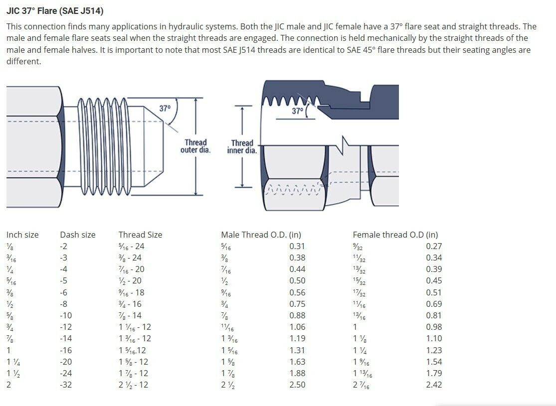

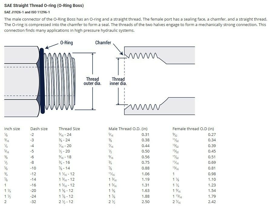

Just a few helpful charts

You're entirely welcome; BTW, the more pics the better - one of us "COFs" (CrankyOldFarts) may see something else that isn't helping you ;) ... Steve
BTW, the charts you posted aren't of the 90 degree adapters; all the 90 ORB/JIC's I've used/seen (a LOT) have the nut and washer behind the O ring. If you're using STRAIGHT adapters it isn't necessary because the JIC's can be tightened at ANY rotation so you can minimize any hose twists.
