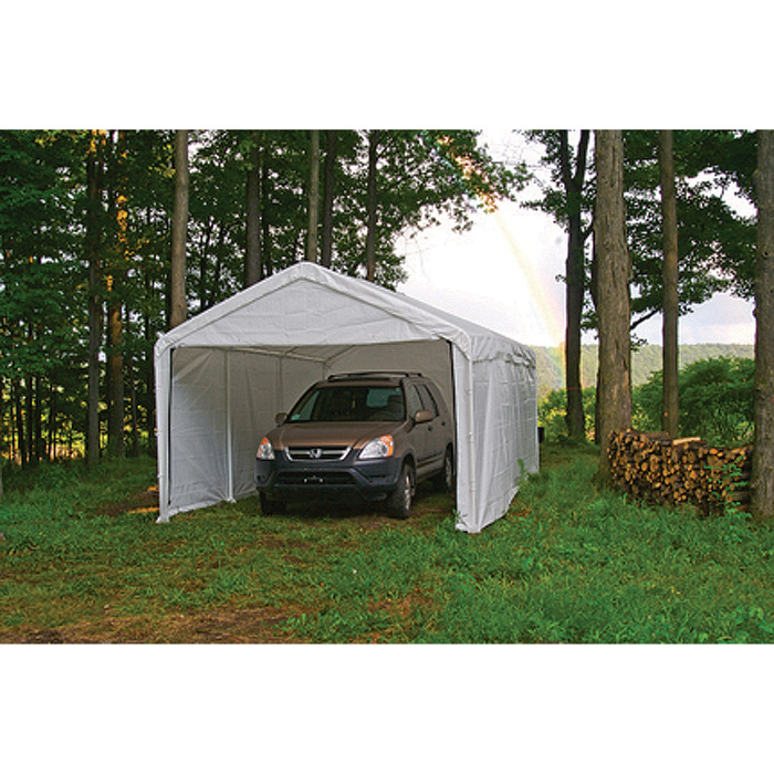

This was the type shelter I had that collapsed under the snow load. On this 10x20 there are only 4 supports (or rafters) spaced quite a ways apart. The pipe thickness is too thin and too far apart to support weight from the top. Not sure if a round top model would have been any better and I wasn't going to find out.

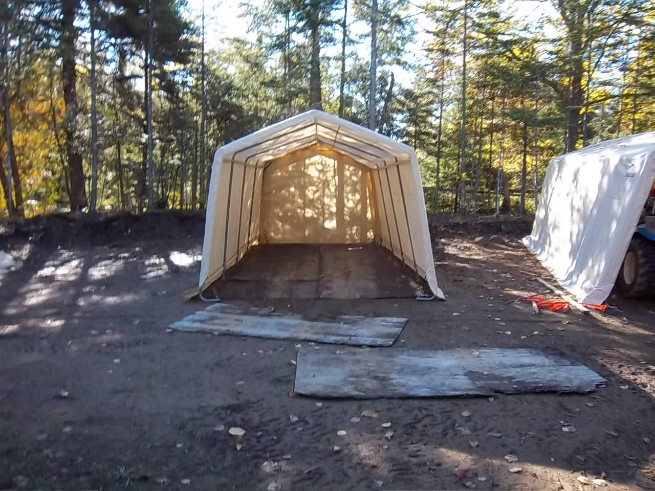

the one pictured below has been up for 6 years.

That is exactly the same size as the one that I had that failed. Fortunately it wasn't too expensive and was a lesson learned. If you live in a high snowfall area they are not necessarily that good.

Looking at yours, BM,,here's what i did with mine.....
2 inches of gravel on the floor inside, then a 2x4 layed horizontally, "flush" with the stone,
then on top of those I screwed in 2x4's vertically ( 14 footers )and now have a wood floor, you can paint them if you like, great to do work on.
