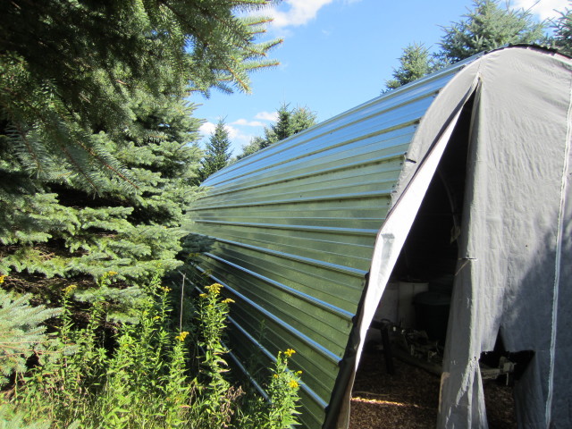

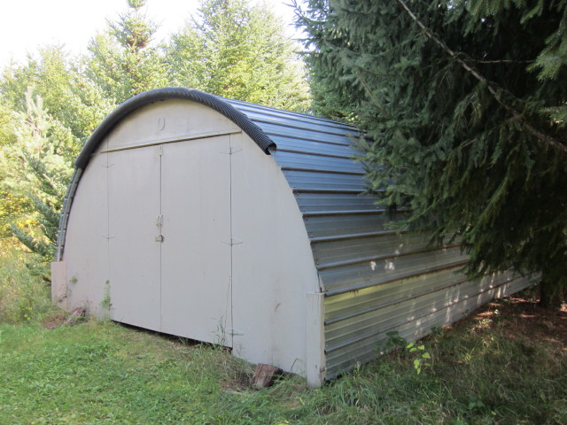

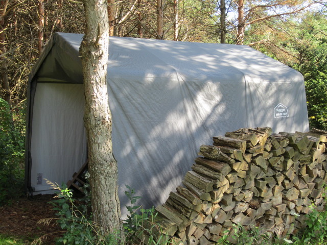

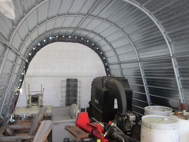

Here are the pictures. The little 10x10, the greenhouse hoops covered in metal with wood end walls, and the round top needing new end walls. The greenhouse hoops were too short so they are on top of buried 6x6 posts. I drilled 2" deep into the post tops for the hoops to sit into then fastened both together with angle brackets. One note, the more level and straight you get the hoops, the much easier and better results will be with the metal. Start at the top, with lots of measuring, then work down each side.
View attachment 390370View attachment 390371View attachment 390372View attachment 390373
Ruffdog, how does that type of roof handle the snow?
It would seem to stay on and not slide off because of the ridges....

It handles it better than the fabric did.
