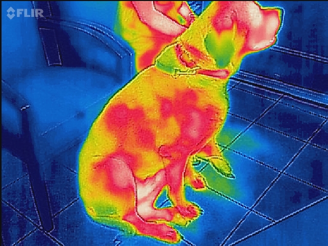

I have a FLIR brand IR camera attachment for my Android phone that's just wha flir_20160726T112055.jpgt you want to see tires with. $250. Works with the phone's optical camera and operating system. Plugs into the USB and power port.

I have a FLIR brand IR camera attachment for my Android phone that's just whaView attachment 577389t you want to see tires with. $250. Works with the phone's optical camera and operating system. Plugs into the USB and power port.
That's why I asked about the thermometer; it will achieve the same goals as your Android for a lot less money. The purpose isn't to diagnose the problem; merely determine the front end is out before trashing $500 worth of tires. (Which I should have noticed before they got to that point.)
