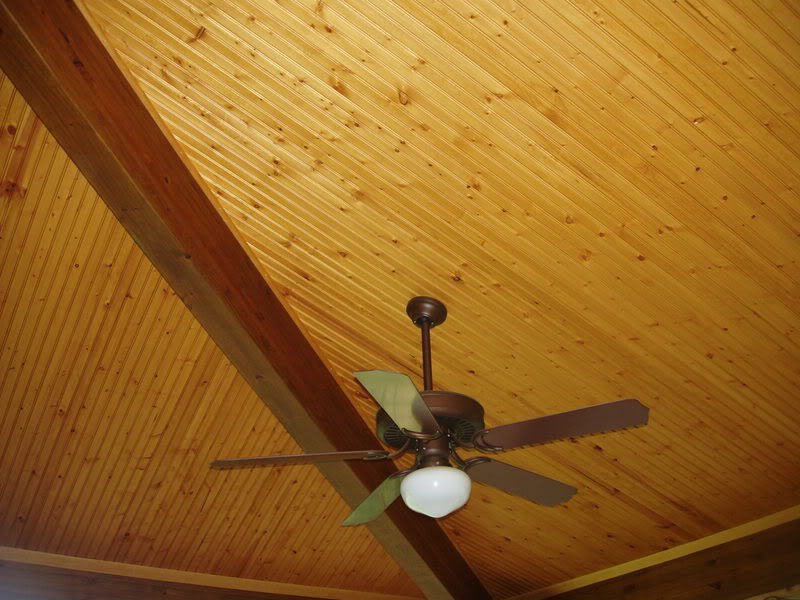

Glulam trusses are another good option. It will look a lot nicer than 2x trusses, and the glulam places can do all the engineering for you. If you don't know any glulam places, ask about glulam beams and trusses at a REAL lumberyard in your area. They'll either have access or know the firms that do them. They come regular or treated for outdoor exposure. The best way to handle these is to let someone with a boom crane hoist them in place. Way too heavy to handle otherwise.
This isn't the best pic, but it is the glulam ridge beam in the cathedral ceiling/roof of a screen porch I helped a friend build as part of his addition a few years back. It was finished with a simple Siikens 1-step stain/finish that is rated for outdoors.

/ How would you do this roof?
I would go with heavy timbers if they are available and not more money. We just moved into the new home we built, in March, and I JUST finished my 24x30 workshop. The spa pad and cover are the last (I think) building project. MANY landscape projects are on the horizon though, but that's another forum.
I wasn't aware glulams could be used outdoors. I was told they had to be inside a building. I really did consider them.
But using a glulam, would require a different approach. If I understand correctly, they are supposed to be supported from the ground up. Not possible in this design, since there is no center beam in the front of my pad.
Now if I could use say, a 6x12 header beam and place a verticle over it to support the glulam, that would work, but without paying an engineer, I'm guessing. I cannot afford an engineer.
That cathederal ceiling is beautiful, by the way. What I don't know either, at least not yet, is total cost, since in addition to the larger header, I would also need rafters every 24", and a ceiling paneling in addition to roof sheathing. I'd have to price that out compared to the trusses, and that is assuming it could be supported by just the header beam.

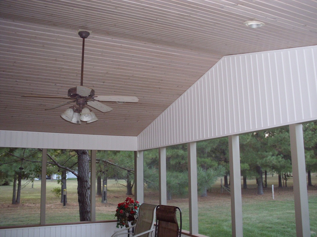

I used a cathedral truss system on my open back porch. It let me close it all in but still had the high ceiling. I put white washed pine tongue and groove boards on the ceiling. I put foam board above that. It keeps the heat from coming through in the hot summer. The gable is sided to match the house. Like they said, all screened it keeps the bugs out. I can pressure wash it all and it looks like new in short order every spring.
/ How would you do this roof? #15
