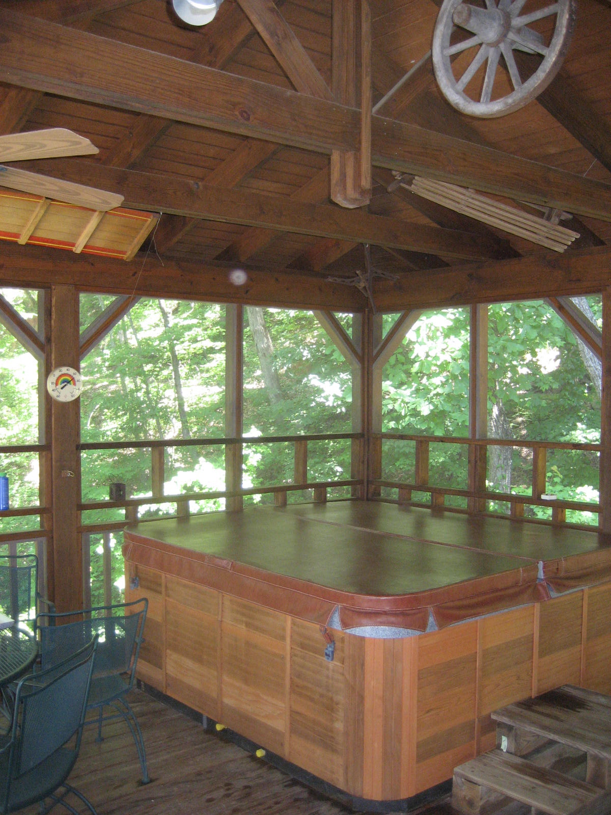

Nice looking setup there. I have given the rafters and collar ties some serious thought lately. You can even adjust them a bit higher from what I have read, anyway. Is your stained? Was that a spray on or brush on finish? If brush on, that would be a LOT of upkeep.
Yes I used a stain on our porch. We sprayed an oil base stain from an airless sprayer. As far as upkeep, I have never restained and the screen porch was first done 9 years ago. I do pressure wash once a year. This is a covered area which sounds like you are planning. I don't have a good photo but this may give you an idea of how it looks from the outside.

Ok I guess the onus is on us now. We'll decide on one of these designs, and when it gets going I will try to take pics and post the progress.
This WILL be painted underneath, so the std truss idea isn't a real big deal. I never planned on staining because the stain grade lumber will put this project way over budget.

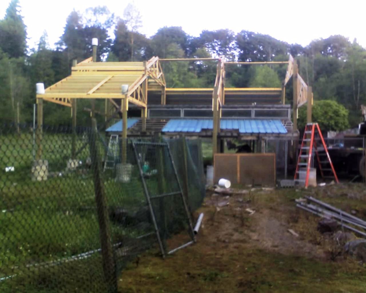

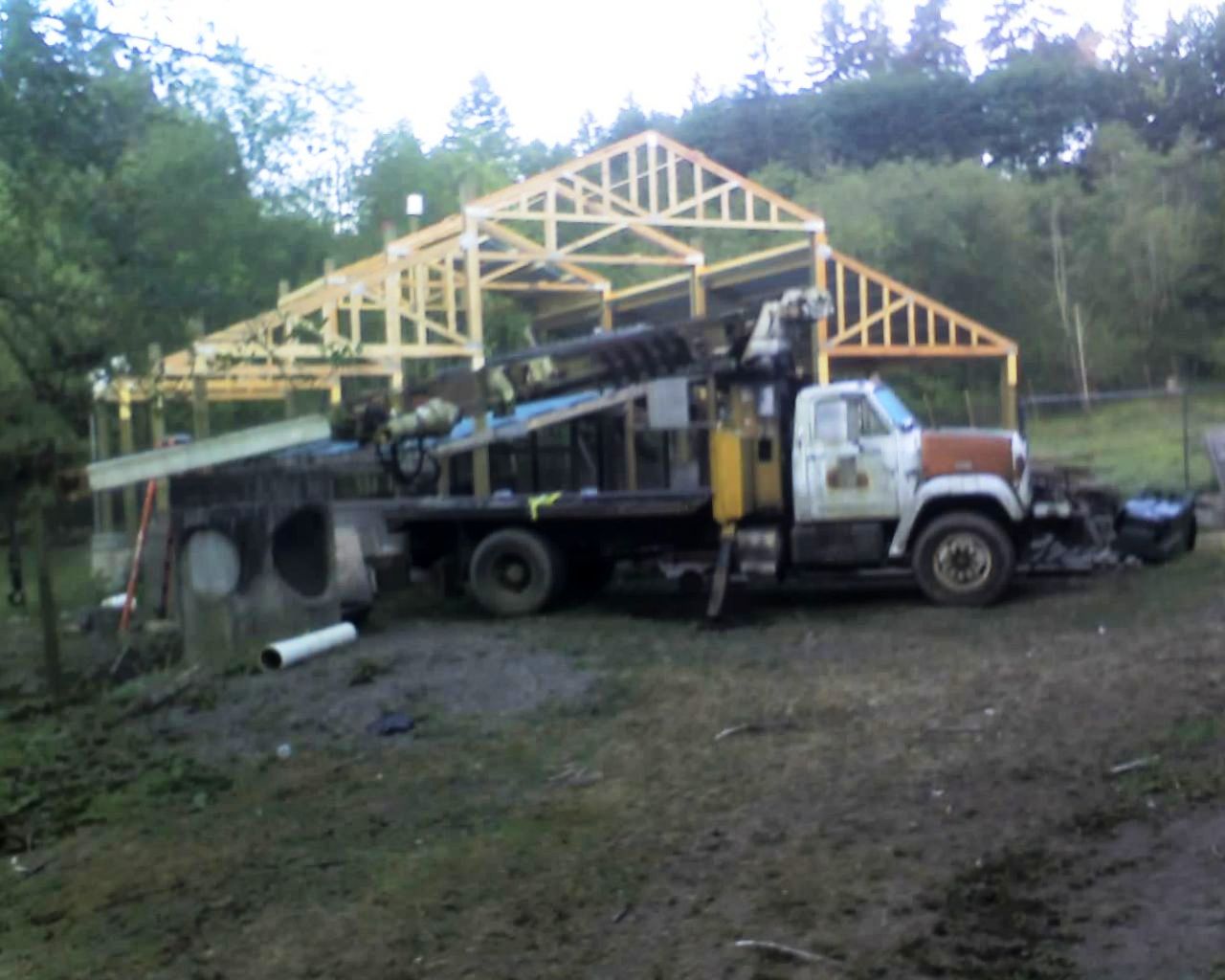

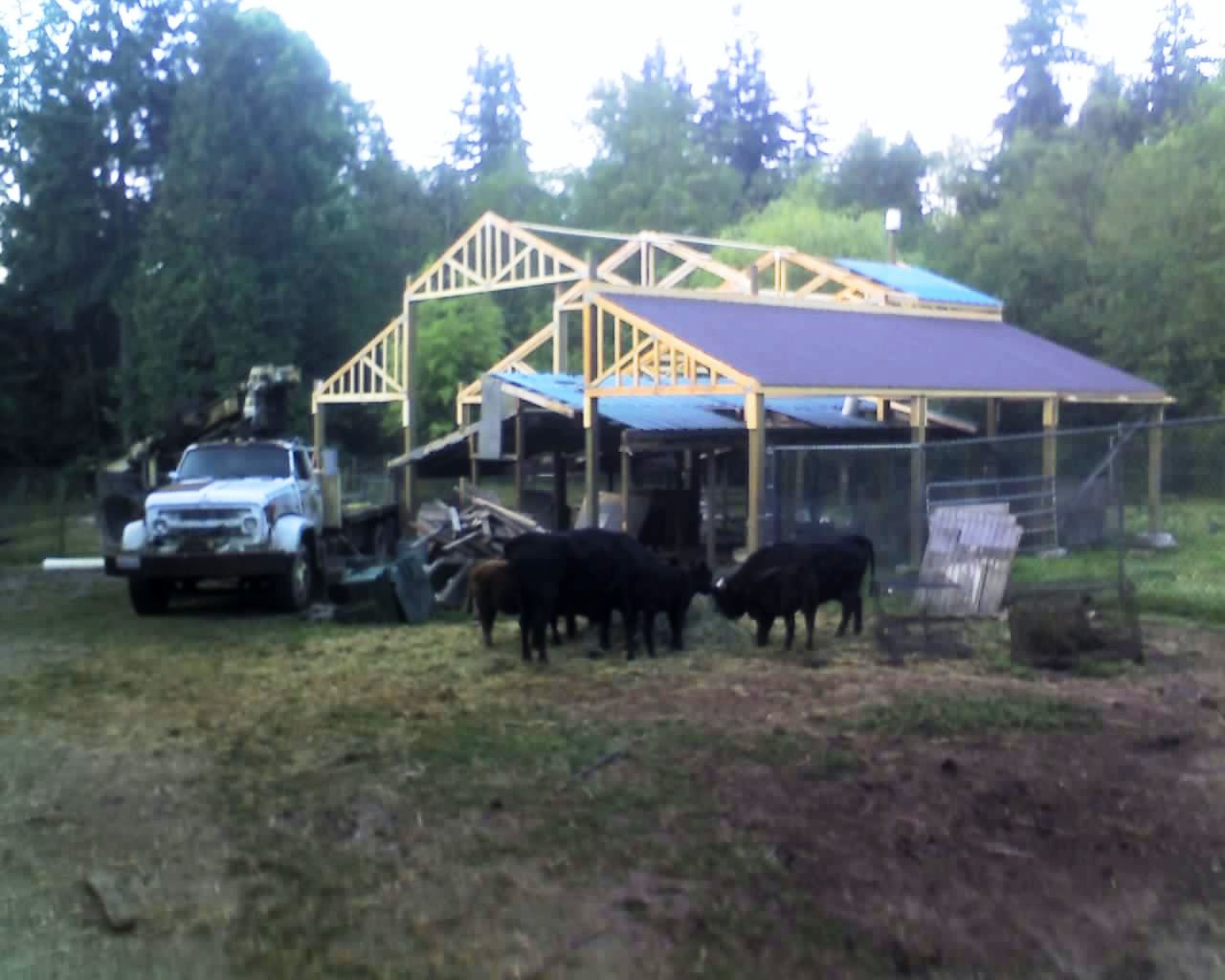

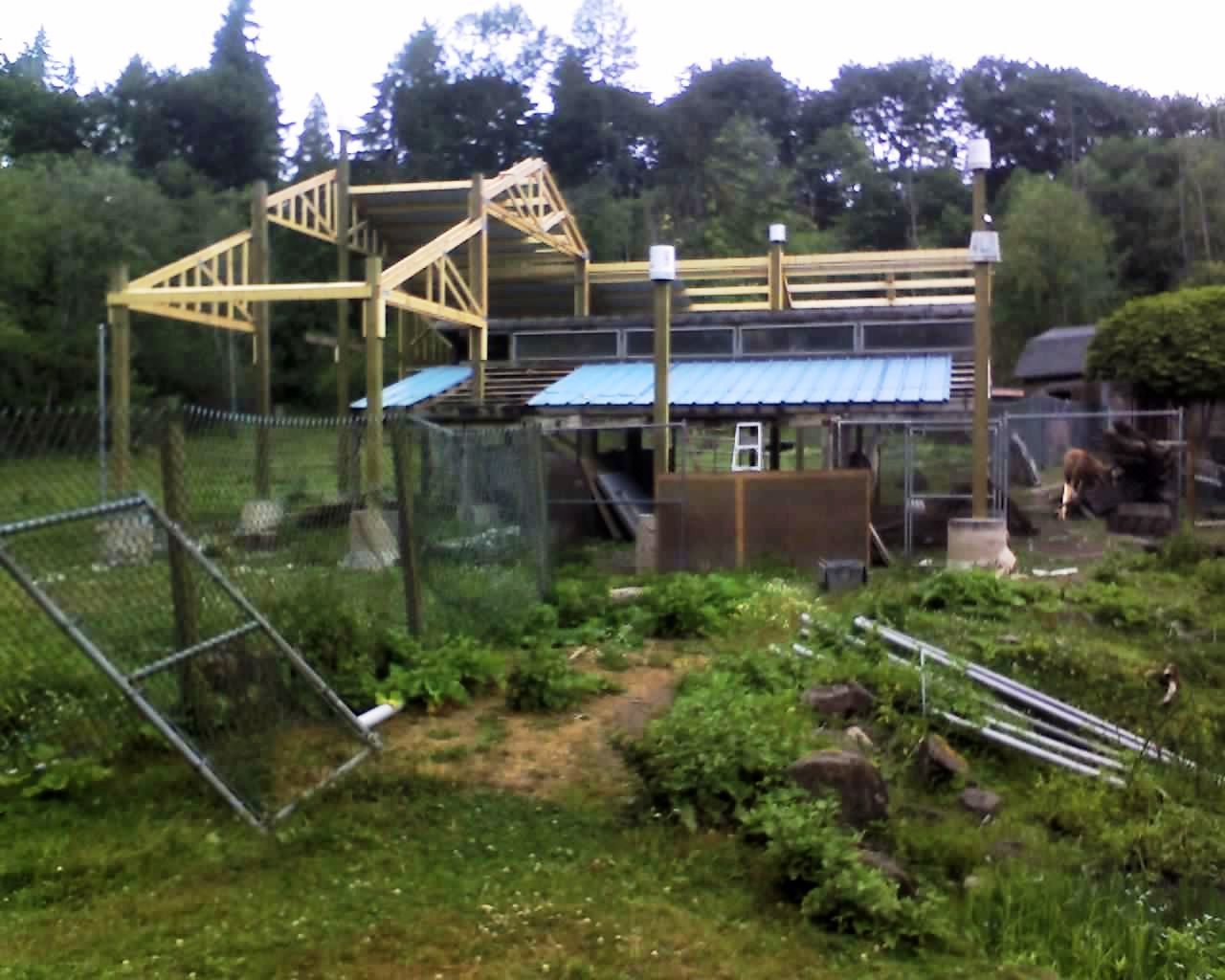

handirifle,
The upper trusses on my barn are an 18 foot clear span. Singles on the ends and doubles on the center posts (one attached to each side of the posts). These are engineered trusses. The third pic shows the taller post in the center to provide the lateral support. I set my posts tall and trimmed them to length after the trusses were set.

I see what you mean about the long posts but I have no idea how that could work on this setup. I understand about the lateral bracing, as well, since it is that way on my shop trusses.
I may have to go with a different truss design, one more like the semi cathederal ceiling. Has anyone here ever had the open truss design I am thinking of, and using X bracing? Not sure if that's the correct term, but thinking if a brace was run, say, from the bottom of the front truss, to the peak of the center truss, and vice versa. The same for the center to rear truss. Would that work?

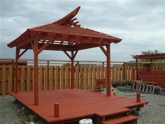

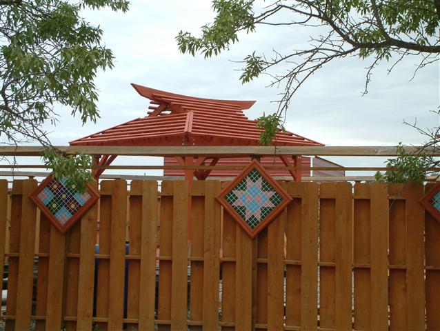

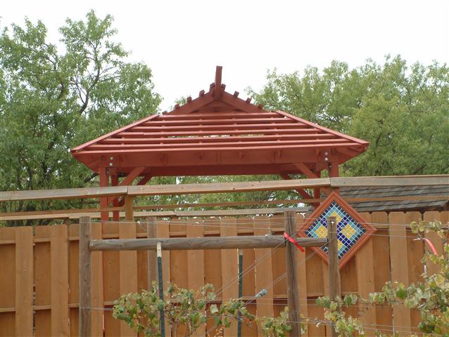

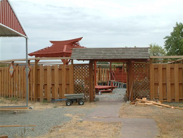

How about an Japanese look--like this pergola I finished last month for my bonsai garden. It's a 10' x 10' Dutch hip roof with a Japanese-style ridge board. Not too difficult to build--I did it myself and I'm 68 years old.
DSCF0002 (Small).JPGDSCF0001 (Small).JPGDSCF0003 (Small).JPGDSCF0005 (Small).JPG
You can add cedar shingles to make it a gazebo.
Add a roof and walls it becomes a Japanese tea house.
Have fun.

I see what you mean about the long posts but I have no idea how that could work on this setup. Just make your center post in the rear extend all the way to the peak of the truss.
I may have to go with a different truss design, one more like the semi cathederal ceiling. Has anyone here ever had the open truss design I am thinking of, and using X bracing? Not sure if that's the correct term, but thinking if a brace was run, say, from the bottom of the front truss, to the peak of the center truss, and vice versa. The same for the center to rear truss. Would that work?Yes. x-bracing will give the roof lateral support as well if you do it between all three trusses. (so you will have 2 x's.) but since you mentioned you wanted an open truss design, I did not mention bracing this way as it would just "clutter" your open design. Extending the rear post would solve this.

The only reason for the horizontal bracing is for support for the roof sheathing. I have measured the true distance between the posts and it will be 8'2" CTC. The spa pad is 18'x18', bot not the posts. With over 8ft between posts, and trusses, there is zero support for the sheathing.
The horizontal 2x4's will provide this, as well as a nailing surface.
As for a cathederal beam, there is no center post in the front, to place the load of the beam on. In the front, it is nearly an 18ft span.
