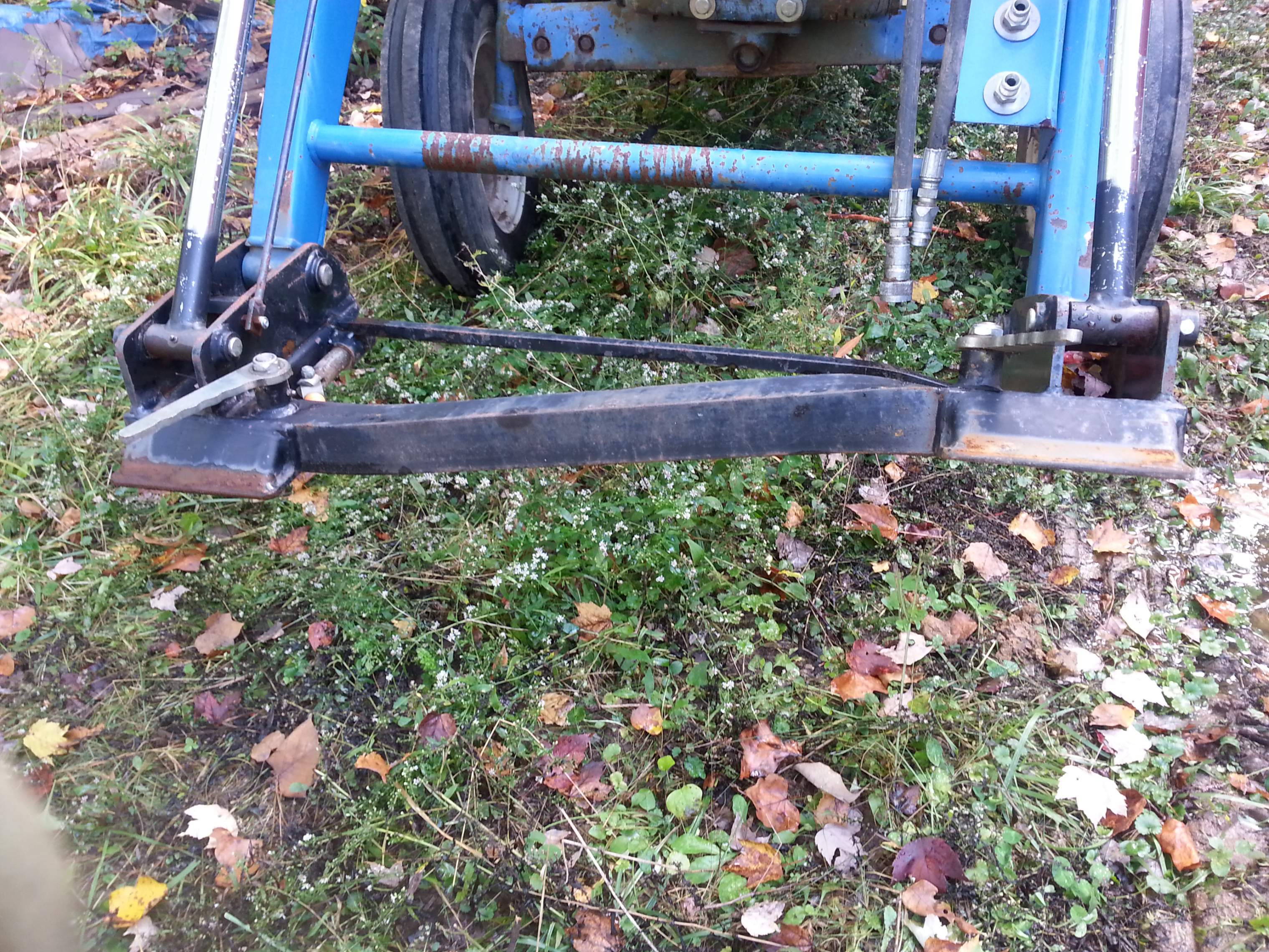

How would you fix this. (I DONT HAVE A WELDER)

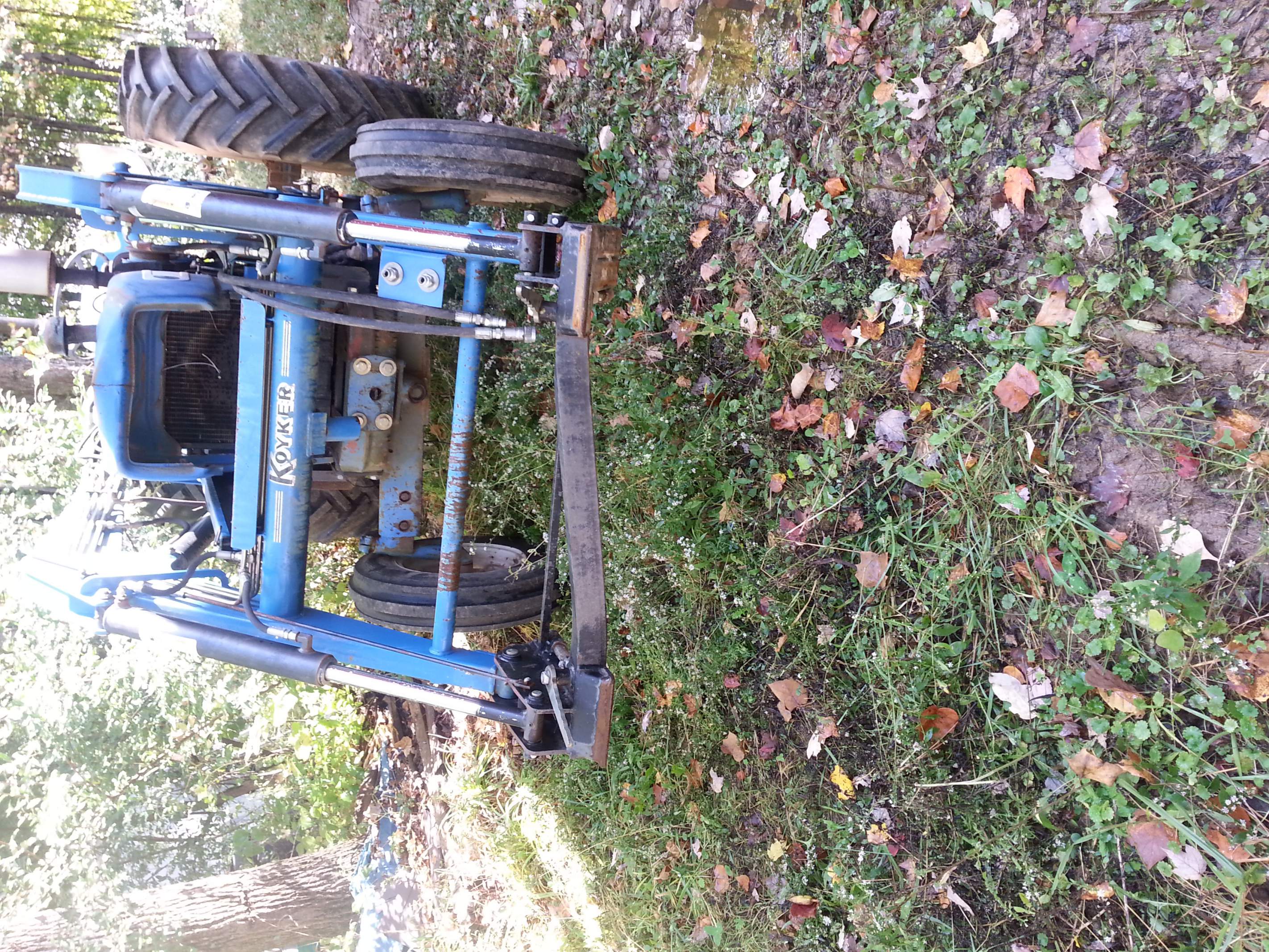

Look at the pics and see if you can suggest a method to fix the twist.
View attachment 393142View attachment 393141
Wedge
Raise the loader to about five feet high, fully retract the curl cylinders. Put the right side against a stout tree or large post. Uncurl until the plate is flush and wrap a chain around the bottom of the plate, so it can't move back. Slowly uncurl until the left plate is slightly past even with the right side, it will spring back some.

Cross couple the two cylinders (one retracts while the other extends) and see if there is enough twisting moment capability to realign the part. You just need to switch two hoses.

Back to the question though, I like the idea of maxing out the cylinders, or even swapping lines if it comes to that. I doubt however that it will get it straight enough to fit right again. If you lived near me, I'd tell you to bring it over... maybe in exchange for drywall work :laughing:

Using the tractors hydraulics to bend it back may give useable results.
Switching hoses, or disconnecting one cylinder might work.
Removing and replacing would be the best
