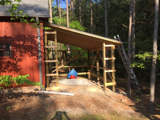

I thought I'd give an update on how I ended up doing this.

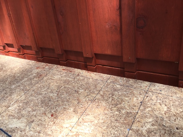

After thinking it through, I decided it would be overkill to cut a huge hole in the siding for the ledger/header, since it was supported external to the barn, and didn't need to tie into internal framing. So I waited until I had the lean-to roof framed and sheathed, and used an undercut saw (aka, "jamb saw" to a floor installer) to rip a groove through the siding that could take the flashing.

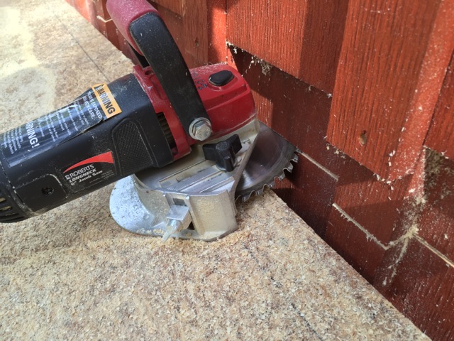

Here's a shot of the saw doing its thing. I set it to cut the bottom of the groove about 1/4" above the sheathing, to account for the thickness of shingles:

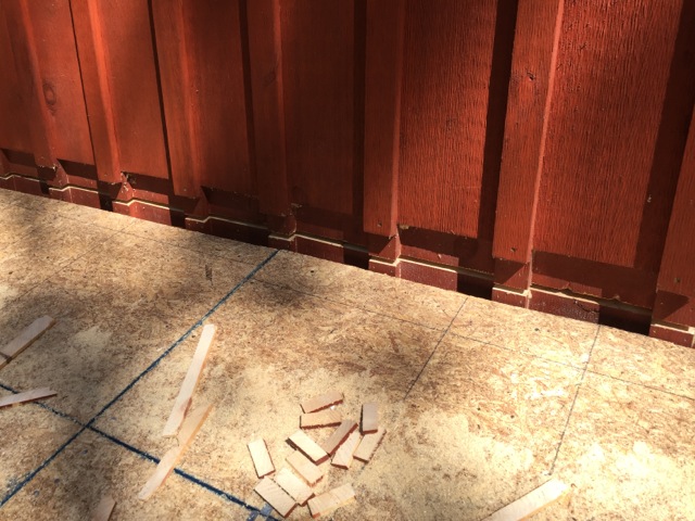

The blade was sharp and left a nice crisp cut through the pine siding and battens, perfectly aligned with the roof pitch. I went over each batten and nailed the cut ends down with my brad gun to keep them in place, and made another pass with the saw, raising the blade to widen the groove. These type of saws give very precise control over blade height, so I was able to cut a very nice straight 3/8" groove:
After this, I cleaned up all the sawdust and hit the sawn edges of the siding with some stain to neaten it up:

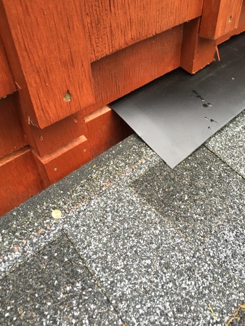

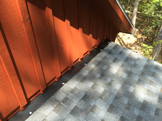

After the roof shingles were installed, I bent up my flashing and fed it through from inside the barn for a test fit:
Looked good, so I nailed it down, sealing each nail hole with some Henry flashing caulk:
Next up is siding!

It's really intended for flooring install, to undercut door jambs, doors, baseboard trim, etc... Basically, it's a lot faster/easier than how I'd normally under cut a jamb with a hand saw or vibrating saw. It can get down flush if needed, or be adjusted to cut up to about 1" off the floor. Also has a depth gauge to limit depth of cut, so you won't saw into framing (I removed it for the flashing cuts, since I wanted to go clear through the battens and siding boards).
They make a masonry blade for these saws that can be used to undercut brick/etc -- say if you were installing flooring up to a hearth/chimney and wanted to tuck it under. I have only ever used them on wood though, so I can't say how well they work on masonry.
I rented this one for $25/day. Most rental places have them, including Home Depot rental. I think they are around $150-250 to buy new. If you do a lot of flooring installs, it might be worth it.
