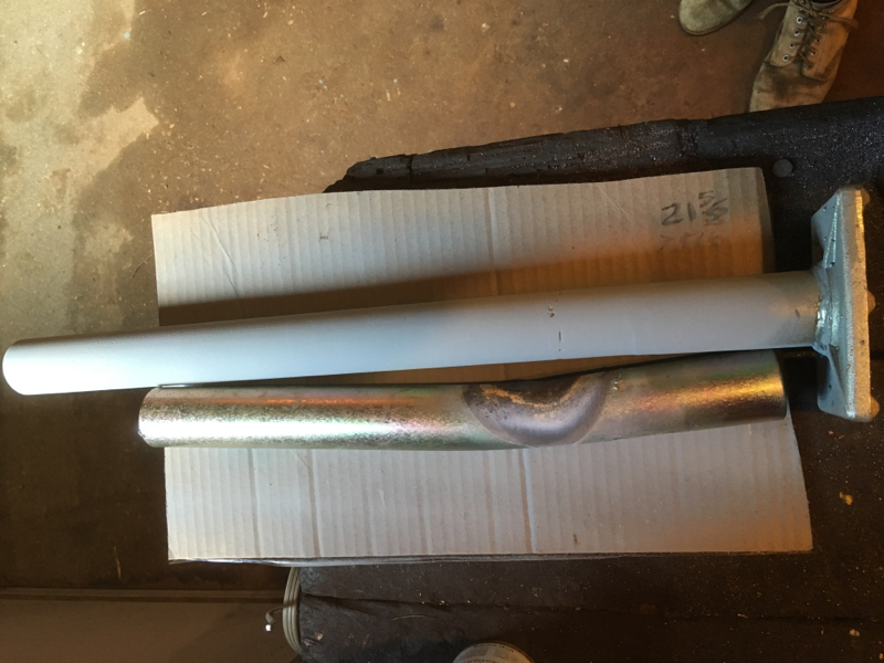

How would you straighten this?
   / How would you straighten this? #41
Has no one thought about just putting it back in the jack stand facing the opposite direction and then drag the trailer forward just like you did to bend it the first time. Go slow and have a flagger to stop when it gets straight. If that doesn't work, just fab up a new piece of pipe. You may not want to go stronger because the next time it may break the mounting attachment rather than just bending the foot.
What about doing this but use a screw-type chain binder (or twisted chain) attached to the bottom plate to pull it back straight. If it slides thru then you're done, right?
I wouldn't use heat, you will burn all the galvanize off. Maybe that gets it straight but you just traded one problem for another.

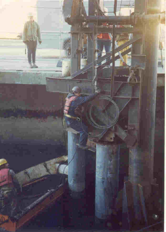

When we built the galvanized steel docks, Pier 69 down town Seattle. And the Alaska ferry terminal in Bellingham. Where the galvanize was burned off, either by welding, or just damage. We were required to replace the galvanize with these. Heat the area with a torch, rub these rods over the area, and wire brush the galvanize smooth.

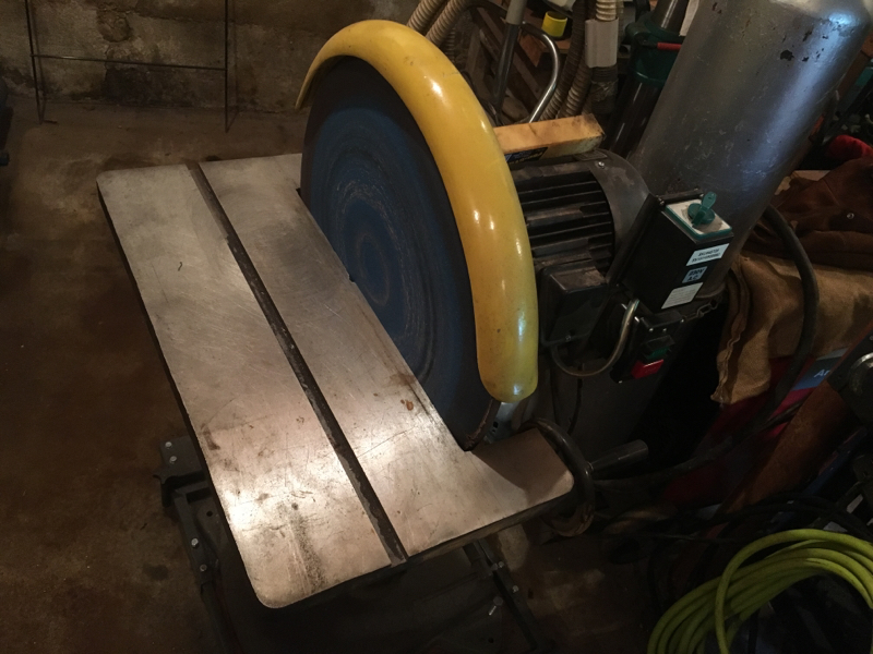

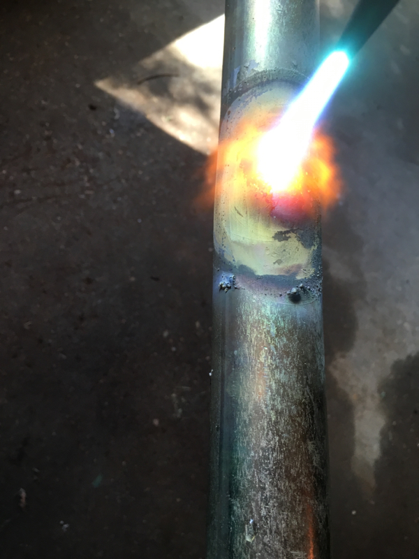

Well, I tried the heat/quench a couple times. It didn't move much, probably because as SA said there's a kink in the pipe. image-4221532402.jpg I found an old piece of similar od steel pipe, cleaned and beveled it with a 20" disc sander, cleaned and beveled the foot I had cut off the bent part. image-4205191924.jpg Butt migged and ground a bit, then painted w cold galvanized rattle can. Doesn't look like the original color, so I hop it reminds me not to forget to remember not to forget it's down. When it is.
Anyway thanks for the suggestions. This one should last me. Jim

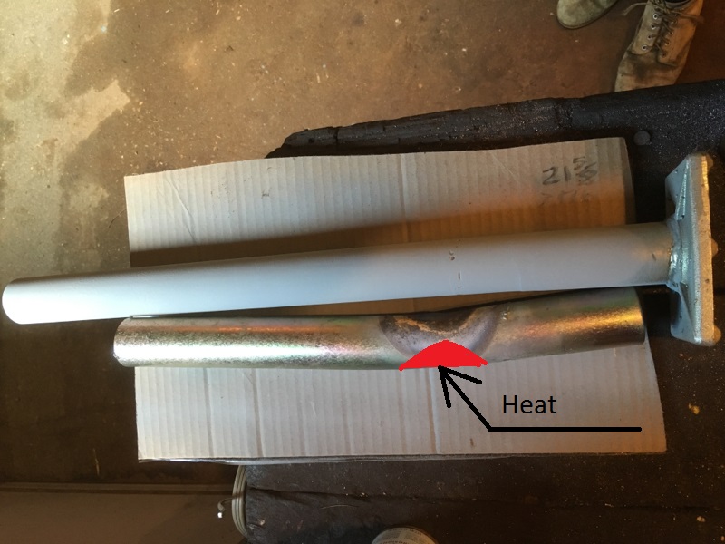

Looks like you heated the wrong side. :confused:

Heated up wrong side ;)
edit: SA beat me too it ..

I just always heat the side that I want to push. The first time someone tries this I can see the confusion, because the bend becomes much worse as the heat is applied. It's like a one step backward, two steps forward progress.
   / How would you straighten this? #50
Yeah it seems counter intuitive. The heat expands it and heals the permanent stretch, but the cooling brings it back to a better state with molecular redistribution.
