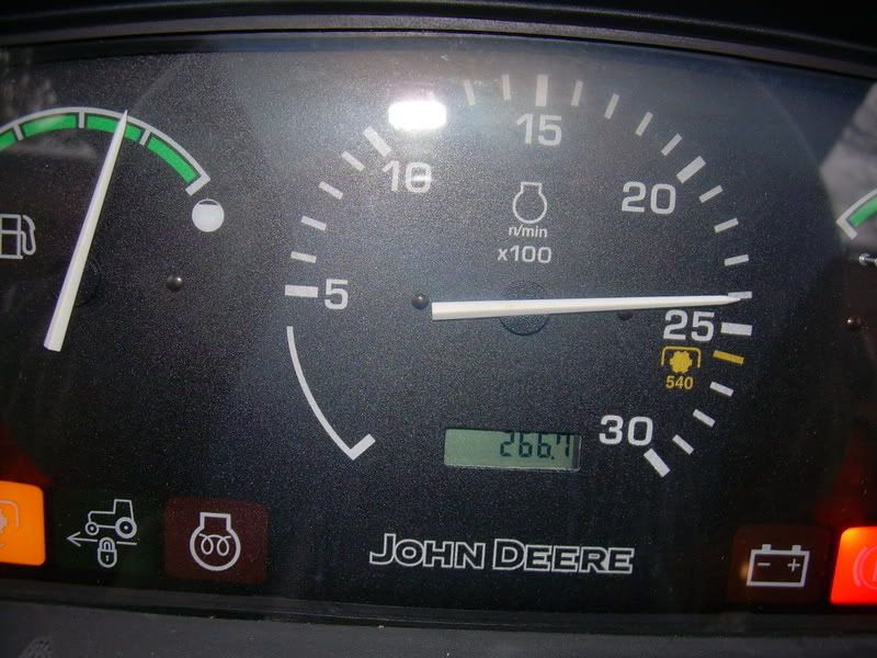

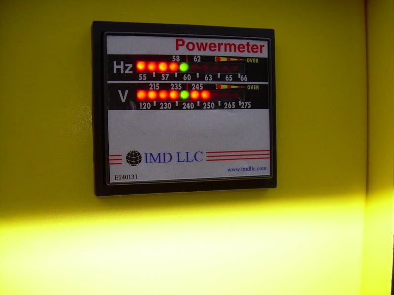

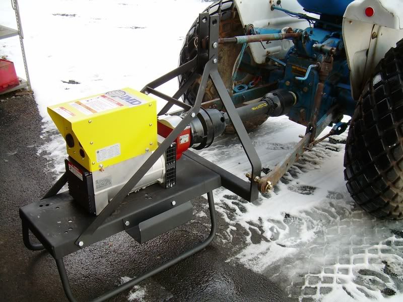

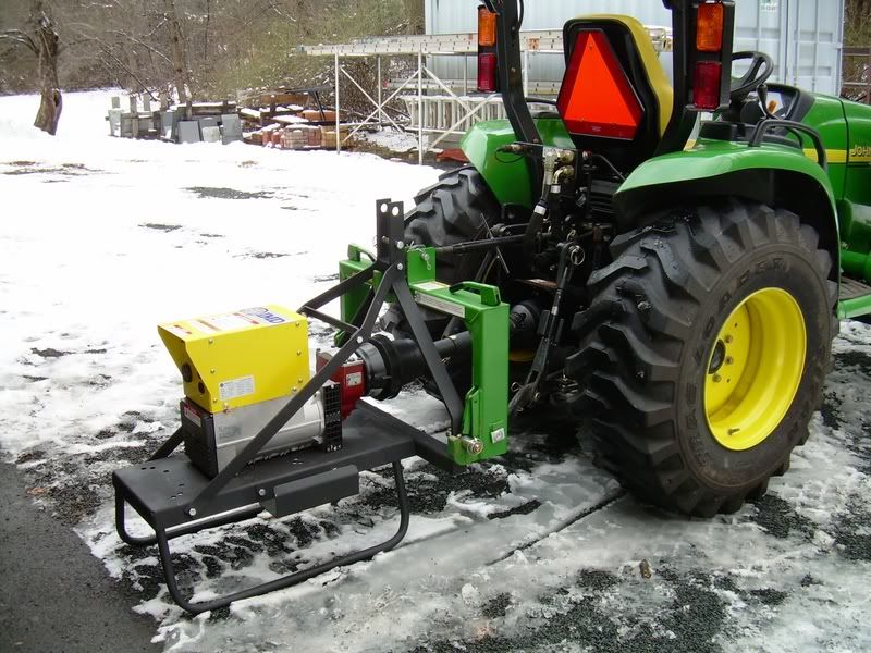

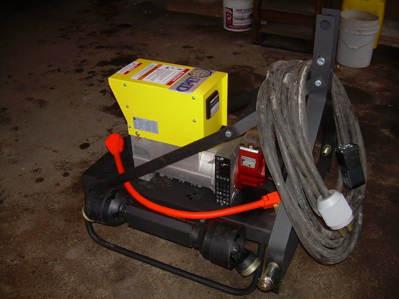

I just had a specific question about PTO generators.
The better backup generators work with more poles to decrease the RPMs needed from the engine. Lowering the RPMs by half increases engine life by about four times, it seems reasonable to apply the same logic to PTO generators.
Where I live, when the power goes out, the weather is not generally condusive to human health. You want something that you can start and will run as long as posible before you have to go out into the elements again.
I'm not looking for recomendation about what type of generator to buy, but I am still interested in the answer to the question. However, some of the other responses makes it pretty clear that the answer is no.
