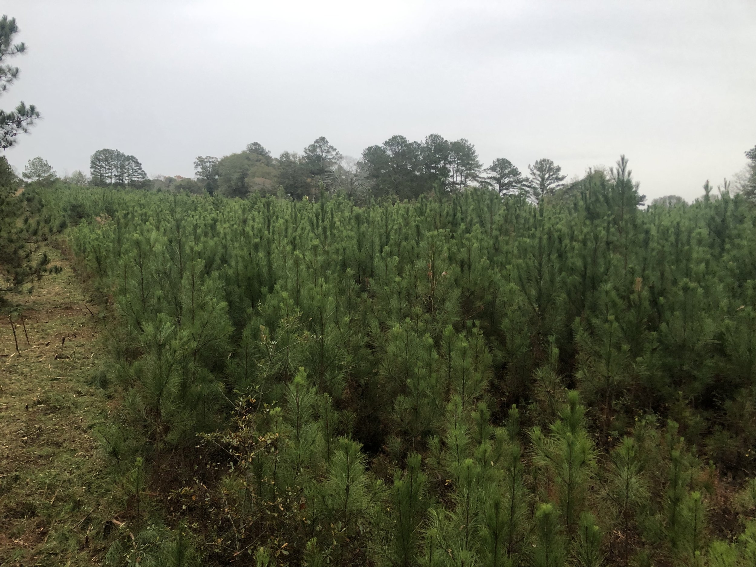

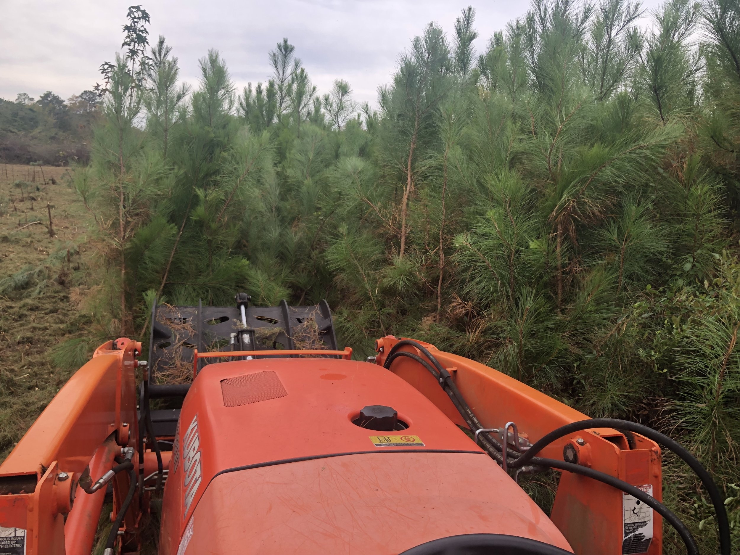

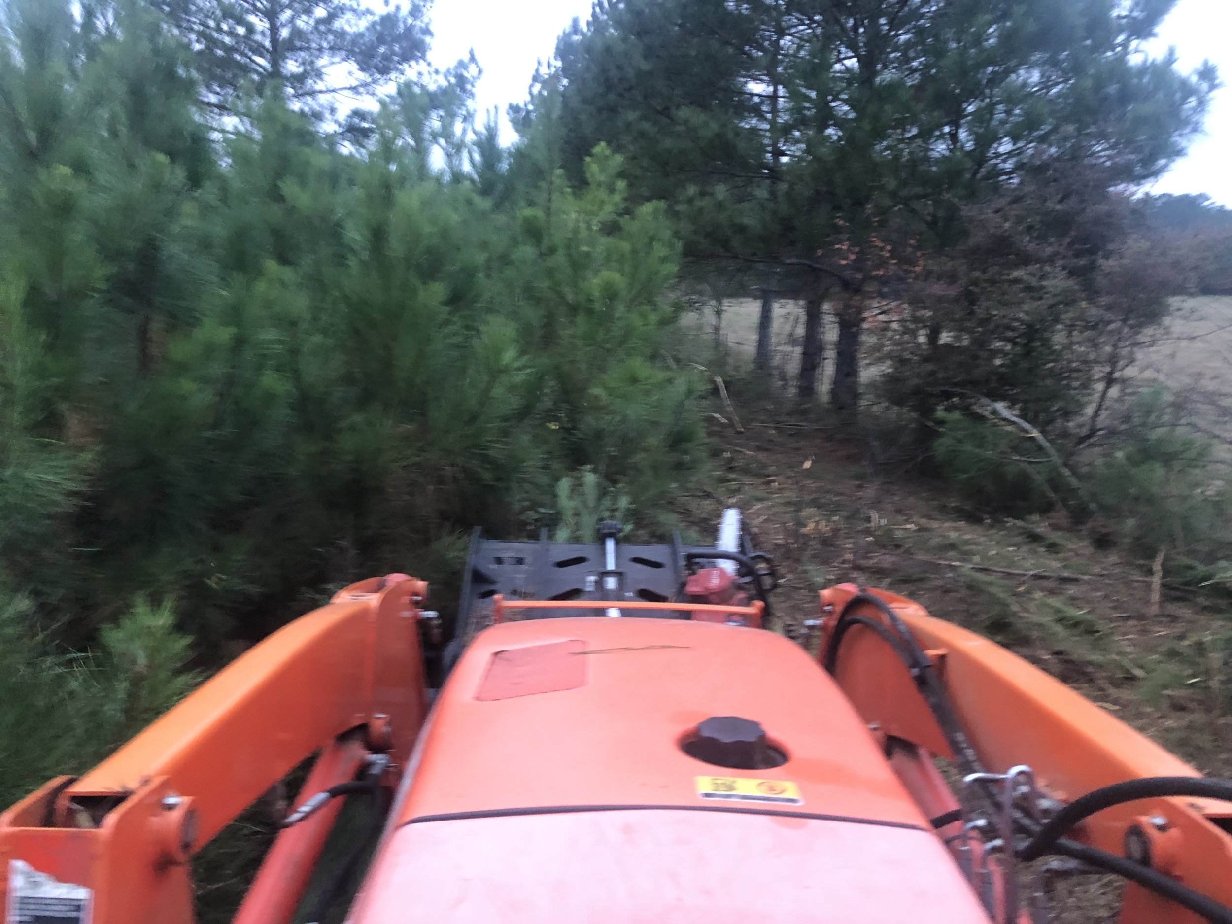

I mow stuff frequently that is taller than my hood. Most jobs in fact. Sometimes I mow stuff taller than my cab. Totally not kidding. I've got the pics...
I'm able to take full passes with my 6' mower at a quick walking speed (don't have a speedometer) and that's working with 32 pto hp. Tractor only starts getting warm once the radiator & coolers start plugging up with chaff.
I'm unwilling to drive it faster than that when I can't see the ground, or what's possibly lurking in the grass/brush in front of me. I use my bucket low in front of me to hopefully "feel" any hazards before I hit them with either the tractor or the mower. Plus most of the fields I cut are rougher than a cob. No way am I interested in going flying across some field, when I can't see the ground in front of me, and there could be who-knows-what lurking ahead. Even if it is shorter than hood height, if it's thick, you can't see down into it anyway. Hazards are real, especially mowing fields I haven't been on before, or that only get mowed every few years.
But mowing at a fast walking speed, I don't have any issues with losing power.
So in what way is your tractor "working too hard"?

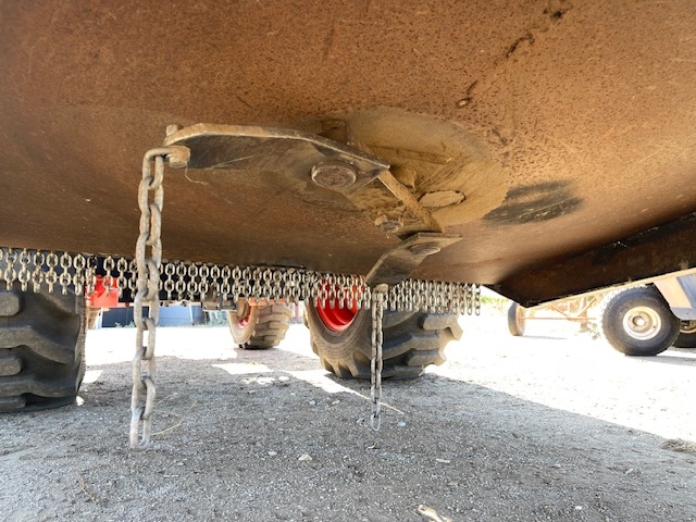

When I was young I was impatient and mowed too fast. Now that I'm older I mow slower and get a much better cut. The Hydrostatic trans is also a big help because I can set the cruise control and then slow whenever the brush get too thick for the current speed. Keeping the blades in good shape helps alot too. Every winter I hoist the mower up in the barn and touch up the cutters on my flail.
This year I will be doing the thickest of it with the modified brush hog. We cut half the blade length off and added chains. I think they call it a slasher. works like an industrial weed eater.
