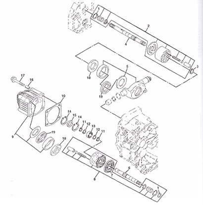

On the Deere there are directional control valves located in the valve block along with "valve plates" for both the pump and motor. Changing the position of the swash plate uncovers different slots in the valve plate.
In your drawing I would think those would be control valves. I see that your oil filter is located after the charge pump too.

The way I understand it is that when the plate is flat, you are not moving, even though the engine is spinning the shaft. If you move the plate in one direction, you go forward. As you bring it back towards flat, you slow down and stop. If you keep the plate moving past flat in the other direction, you go backwards.
Does that sound correct?
/ HST - How Does It Work? #43
That's right, MossRoad. When the swashplate is in the neutral position. there is no stroke of the pump pistons, so no volume to the motor. I found the answer to my question. If you compare the attached diagram to the previous one I posted, you will see that the fluid follows a different direction depending on the tilt of the swashplate. What was the discharge stroke when the swashplate is tipped one way becomes the suction stroke when tipped the other. This changes the direction of the flow of the fluid which changes the direction of rotation of the hydraulic motor. No valves needed. Now that is neat!
