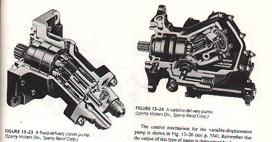

Here is a pic of a turbine engine hydro pump with variable displacement. Imagine two pumps, one fixed output and another variable driven as a motor from the fixed, then you have tractor HST.
J

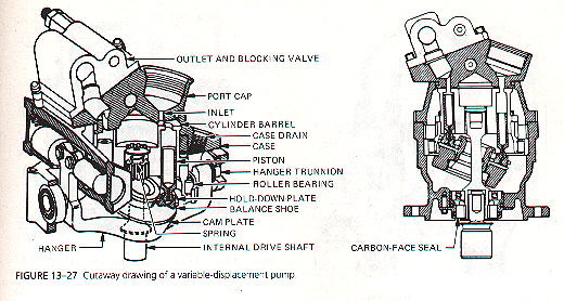

Another pic of hydro pumps, one fixed and the other variable. The variable changes output by changing the angleof the piston body, a swashplate works in a similar fashion.
J
