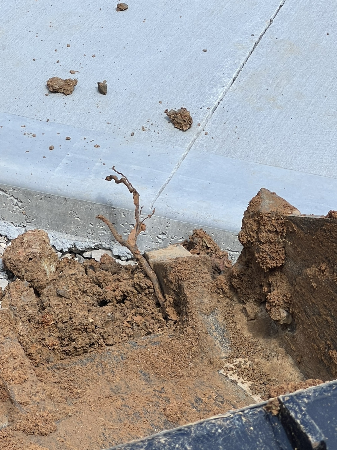

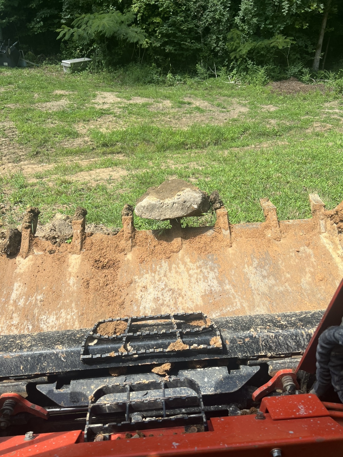

How many gear tractor guys would spread dirt right against a sidewalk? I do this all the time and I’ve never had to buy a sidewalk. Can you run it smooth enough to flip rocks in the bucket without scooping a bunch of dirt with it?

How many gear tractor guys would spread dirt right against a sidewalk? I do this all the time and I’ve never had to buy a sidewalk. Can you run it smooth enough to flip rocks in the bucket without scooping a bunch of dirt with it? View attachment 3815764View attachment 3815765
Looks like you’re using a skid steer. Entirely different conversation. I presume you’ve used a tractor mounted front loader before and you know the drastic difference in visibility of the work area. I suspect that your skill in juggling rocks and placing dirt is more related to the machine and not the transmission
