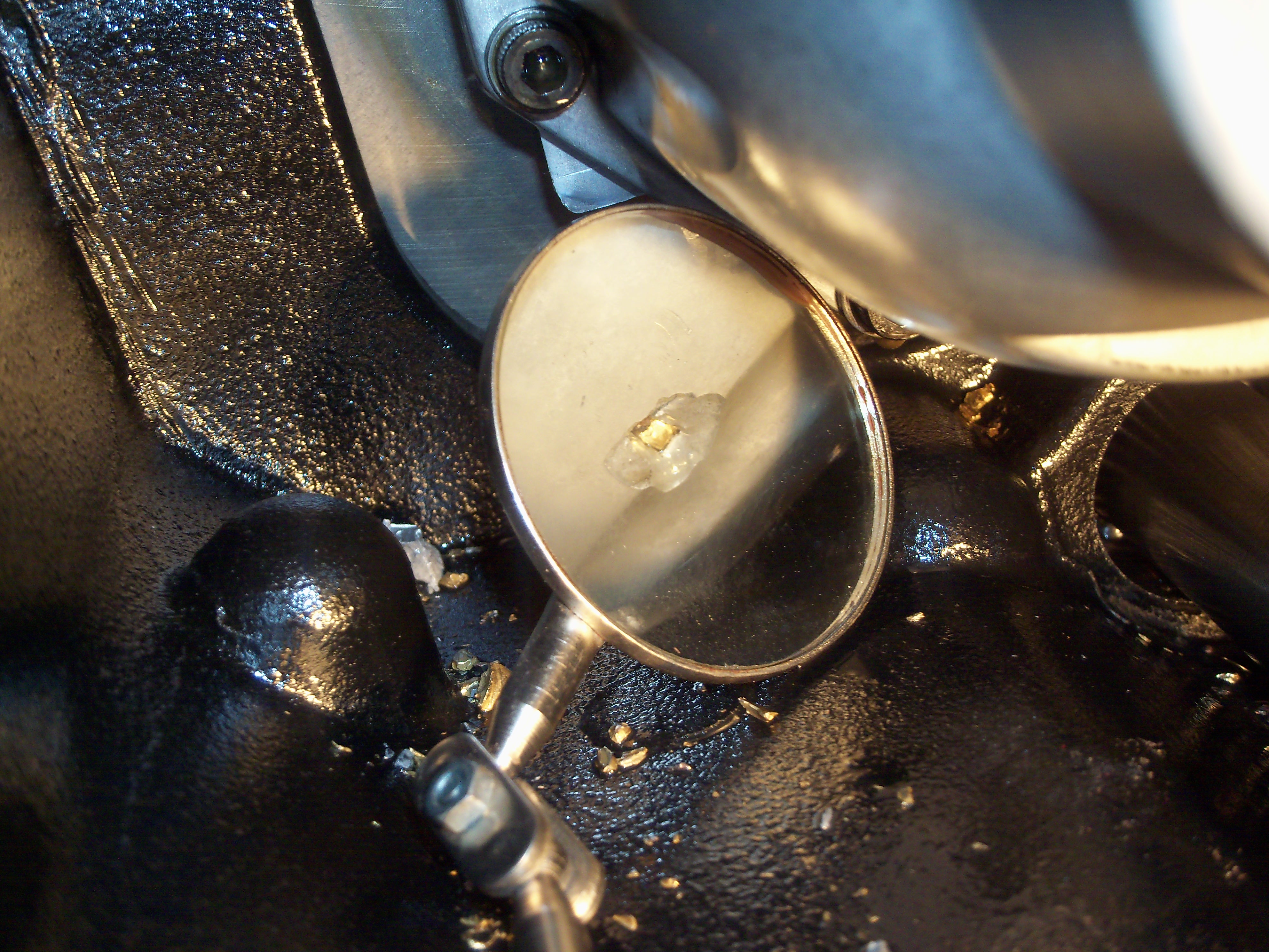

As I mentioned in part 2, I could see metal chips in the tunnel section. There is an inspection window in the side of the tunnel. I removed the cover and took a look inside by sticking my smart phone through the window (window is only about 2" x3") and using the camera to snap a few shots of the inside. The gears on the front end of the range trans are undamaged. Notice the metal chips along the bottom of the tunnel. They appear to be aluminum and brass.
I realized that the damage must be further forward. I feared that the hydro motor could be damaged. So, on with the split. I supported the front of the tractor with jack stands positioned under each of the FEL mount pedestals. I used my cherry picker/engine hoist and a sling to lift the rear section.
After splitting I was able to get a better look inside the tunnel. What a mess. Metal chips and chunks were scattered along the bottom of the tunnel.
I looked forward at the Hydro motor and I didn't see any damage. Now I'm really puzzled. Where are all those metal chunks coming from? I used an
inspection mirror to get a better look at the motor, and that's when I found a nickel size hole on the bottom side of the hydro motor housing - my worst fears are confirmed.
OH CRAP, THIS IS GOING TO BE EXPENSIVE !!

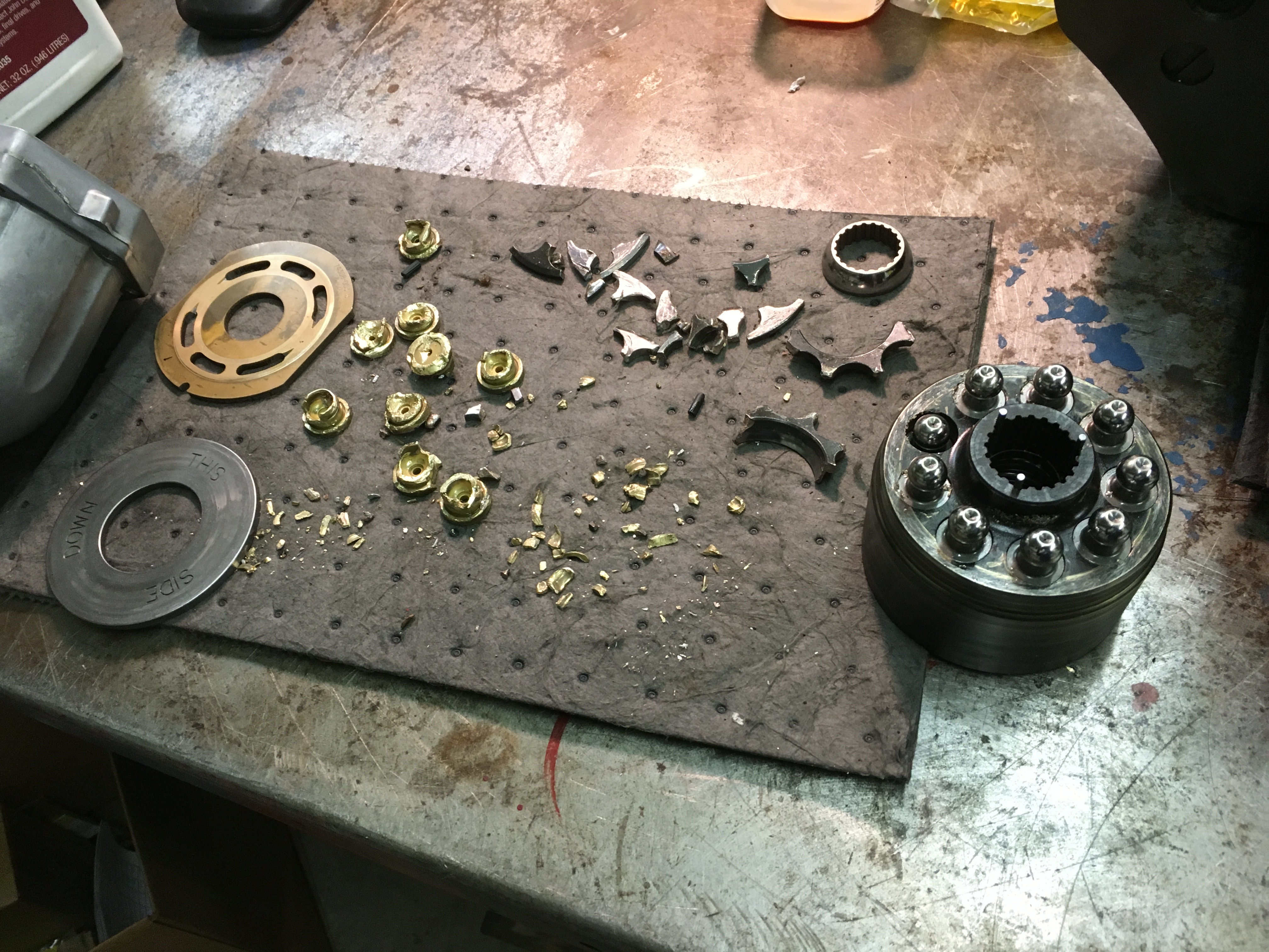

So now I have to split the tunnel from the front section in order to access the hydro unit. Once it was split, I removed the hydro unit and tore it down.
The hydro unit is made up of three parts. The hydro pump, a backing plate, and the hydro motor. The pump mounts on the front side of the backing plate, and the motor on the backside. The backing plate is about 2 inches thick and contains several pressure relief valves, oil passages, and pressure test ports. First I removed the motor. As soon as it was loosened, parts fell out all over the bench. Now I know where the metal chunks came from.
It appears that the motor experienced a catastrophic hydro lock. When the tractors rear wheels hit the ground and tried to roll, all of that force went through the gears and tried to turn the hydro motor which was idle and full of oil. Oil doesn't compress and it had to go somewhere. It couldn't go backwards into the backing plate and pump, so, it blew a hole through the side of the motor housing to relieve the pressure. The housing was the weakest link. Everything inside of the motor housing was totally destroyed. Can you imagine the amount of pressure that must have built up in that split second!
I made a list of parts needed and began searching. I couldn't find a complete hydro motor, either new or rebuilt, so I had to order every piece individually. I also ordered a few seals and bearings that weren't damaged or leaking, but I felt that since the tractor has 17xx hours, and as long as I was in there, I might as well be pro-active for a change, and replace them. All together, I ended up ordering a little over $2000.00 worth.
The parts have arrived, and in part 4 I'll start the re-assembly.

Make sure it's squeaky clean when you put it back together flush everything and anything out of the housing. Hopefully you've ordered a new wear plate for the slippers to ride on. If you get any scrubbing/debris between those two you'll be back to square one again. Make sure the barrel and port plate look good and mate well.That's the other trouble spot (bronze & steel)with a Axial Piston Motor / Pump. They're a great design but are susceptible to foreign debris getting between those two ares. Cleanliness cannot be overstated.
Change the hydraulic filters and hope none of the debris travels upstream to the pump when you light it up.
Good luck.

You cannot believe how careful/clean you have to be with axial piston pumps & motors. The slippers in both have to ride on a thin film of pressurized oil on the wear plate to keep from scrubbing. The cylinder barrel and port plate mating surfaces are the same. You loose that microscopic film of oil and start metal to metal contact, and it's just a matter of time before it's toast again.
When those units are assembled, they'll be run on a test stand going through the different pressures etc, the end of the test there will be an oil sample taken while its running and do a particle count, to see if anything is breaking down (scrubbing). If the sample is within acceptable specs, the unit is passed on to assembly. If its not, its rejected, tore down, faulty parts replaced and back to test.
Gear type units are more tolerable to debris then the axial piston type. You can get the high pressures with the axial piston pumps/motors that you cannot get with any other style. But the main culprit in them is foreign particles.
If he's already up and running I wish him well, and would advise changing out the hyd filter a couple times just in case. If any debris has found it's way to the pump it's already too late.
