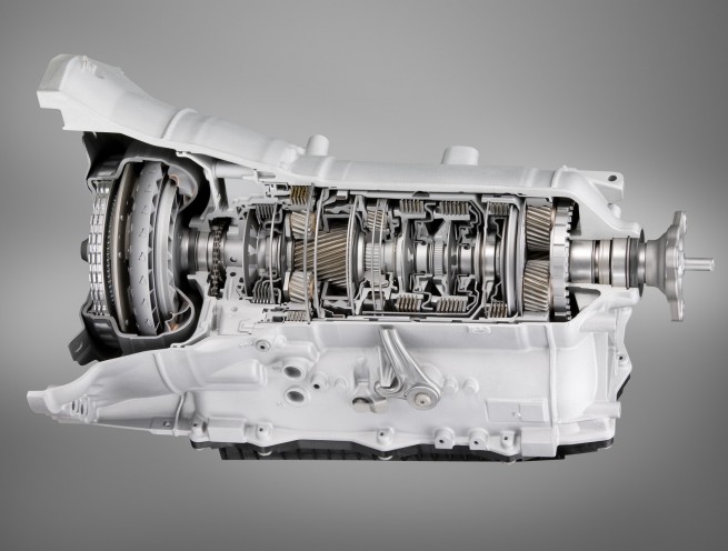

Agreed - I wasn't saying CVT, I said "more continuously variable" which in my mind means more gears with intermediate sliding-ratio planetary sets - like the ZF 8-speed now offered on high-ticket cars. (no rubber-coated wheels).
A proper 8 or 12 speed auto trans for a CUT would need a stronger and shorter case. The market is small - so it will be pricey if we ever see it.

Agreed - I wasn't saying CVT, I said "more continuously variable" which in my mind means more gears with intermediate sliding-ratio planetary sets - like the ZF 8-speed now offered on high-ticket cars. (no rubber-coated wheels). A proper 8 or 12 speed auto trans for a CUT would need a stronger and shorter case. The market is small - so it will be pricey if we ever see it.
My wife has the zf 8 speed in her grand Cherokee and it is a sweet transmission, something like it in a cut would be very interesting.
