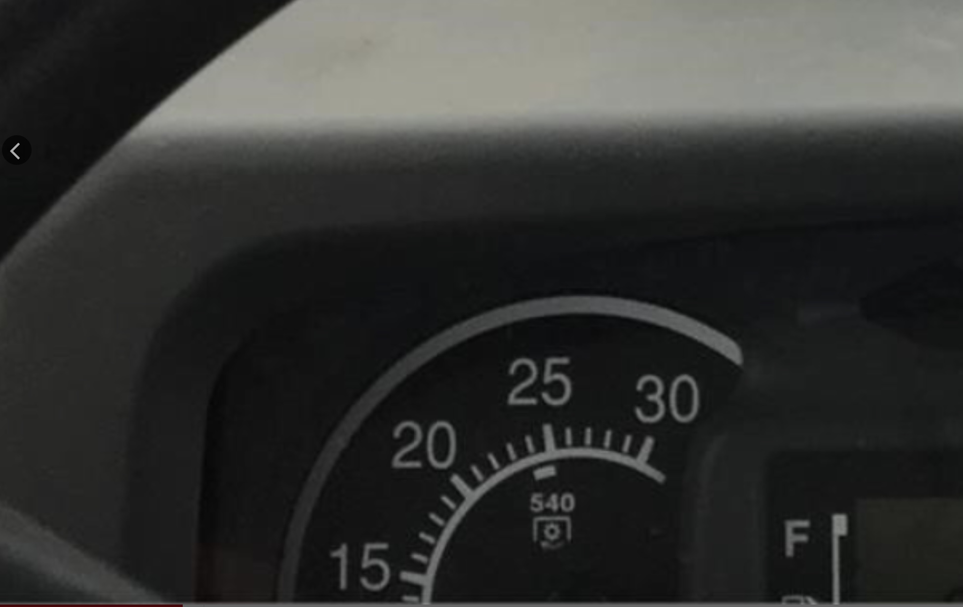

On this tractor they are pretty much the same thing. PTO rpm's according to the owners manual is 2500 rpm (there is no marking on the tach like my previous tractor) and the max I can get with the hand throttle is about 2505 or 2510. But yes I have pushed it to the max when working it hard.
You should have a line indicating the rpm required for 540 PTO rpm
My previous tractor had the same thing. A band of green showing the PTO range but this one does not. I haven't had a need for using the PTO at speed yet so I wasn't concerned about it. I checked today and found that the PTO revs are shown on the digital display. There is a button to toggle the display between PTO speed and the Soot level. Not sure what the right engine rpms are to achieve a PTO speed of 540 but I will find out some time.
As far as the proper engine speed for the HST, the owners manual states that the HST works best at 2400 rpm and higher.
