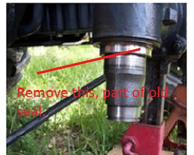

NOTE TO ADD TO MY 1ST POST ABOVE...One thing I didn't say about the seal above and I hope it is noticed in this post... The seal is a 2 piece design. When dropping the hub, the one piece will stay on the axle, you must "slowly" work that seal off because it is a tight fit over a polished machined surface.

Shaya99... I think one of two things could have happened here. Either the bearing is not seating on the axle correctly (you say it is) or the more then likely problem, you didn't remove the "2nd" piece of the seal on the axle and that is stopping the bearing from riding all the way up, (because you are saying the seal looks different, it really isn't, you just didn't get the other piece off)... When I say axle, I am referring to the dropped polished piece that everything mounts to.
Here is a quote from a few post down from me on the 1st page, I wasn't able to edit my 1st post at the time to add this info...
Found a missing photo to point out what needs to be removedUntitled.jpg And looking at your photo blown up, it sure looks like that seal piece is still there... It might be worth buying another seal if you put as much force trying to seat everything as you said you did, I would be shocked if the new seal wasn't damaged. Let us know how you make out.
Found a missing photo to point out what needs to be removedView attachment 534067 And looking at your photo blown up, it sure looks like that seal piece is still there... It might be worth buying another seal if you put as much force trying to seat everything as you said you did, I would be shocked if the new seal wasn't damaged. Let us know how you make out.
Thank you, I had called local dealer today and he explained it veryt well. Yes I did not remove the top part of that seal that was stuck onto the axle. Makes sense now....Your new photo helps....I will check for damage when I complete the job, if it is damaged, I did buy a second seal for the other side if I ever need it (that one not leaking now...).
