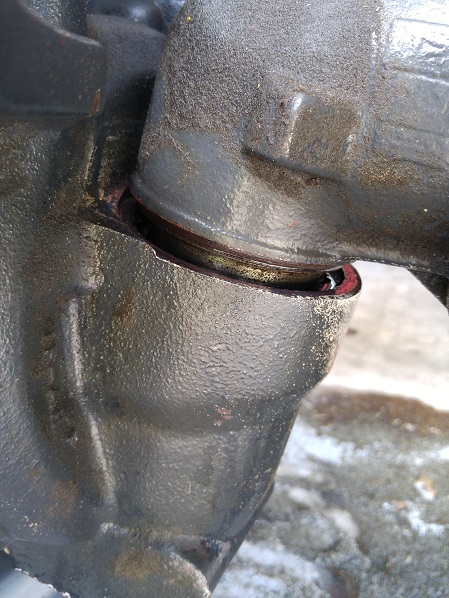

Got the seal replaced.
Forgot tires are loaded....that tiny little front wheel weighs a good bit so putting it back on caused a bit of a headache (out at the farm with minimal tools), but the biggest headache came when trying to pop the snap ring off that apparently holds the hub on. Got it undone and with it, came the hub. Luckily, buddy's head was pretty much out of the way when it fell...knicked him right above the eye, though, so he has a nice bump on it today. He said it didn't think that was all that was holding it on, but in retrospect, most of the pressure/weight goes the other way on the hub.
Lessons learned!
Thanks for all the help, too.

Something is going on with the gallery on this web site, so I posted the photos on another site and link them here...
Missing, #2
Missing, #9
#2 was just showing the tractor on jack stands.
#9 I believe I was just pointing out to make sure the old seal (inner part of that seal, if you look real close you can see the old inner part of the seal is still there, that rust is the old seal liner and not the spindle) was removed from the top of the drop spindle and to make sure to clean and lube with a bit of axle lube/oil on the new seal before putting everything back together.
Sorry for the pics not showing in my 1st post, not sure what is going on with the gallery on this web site.
