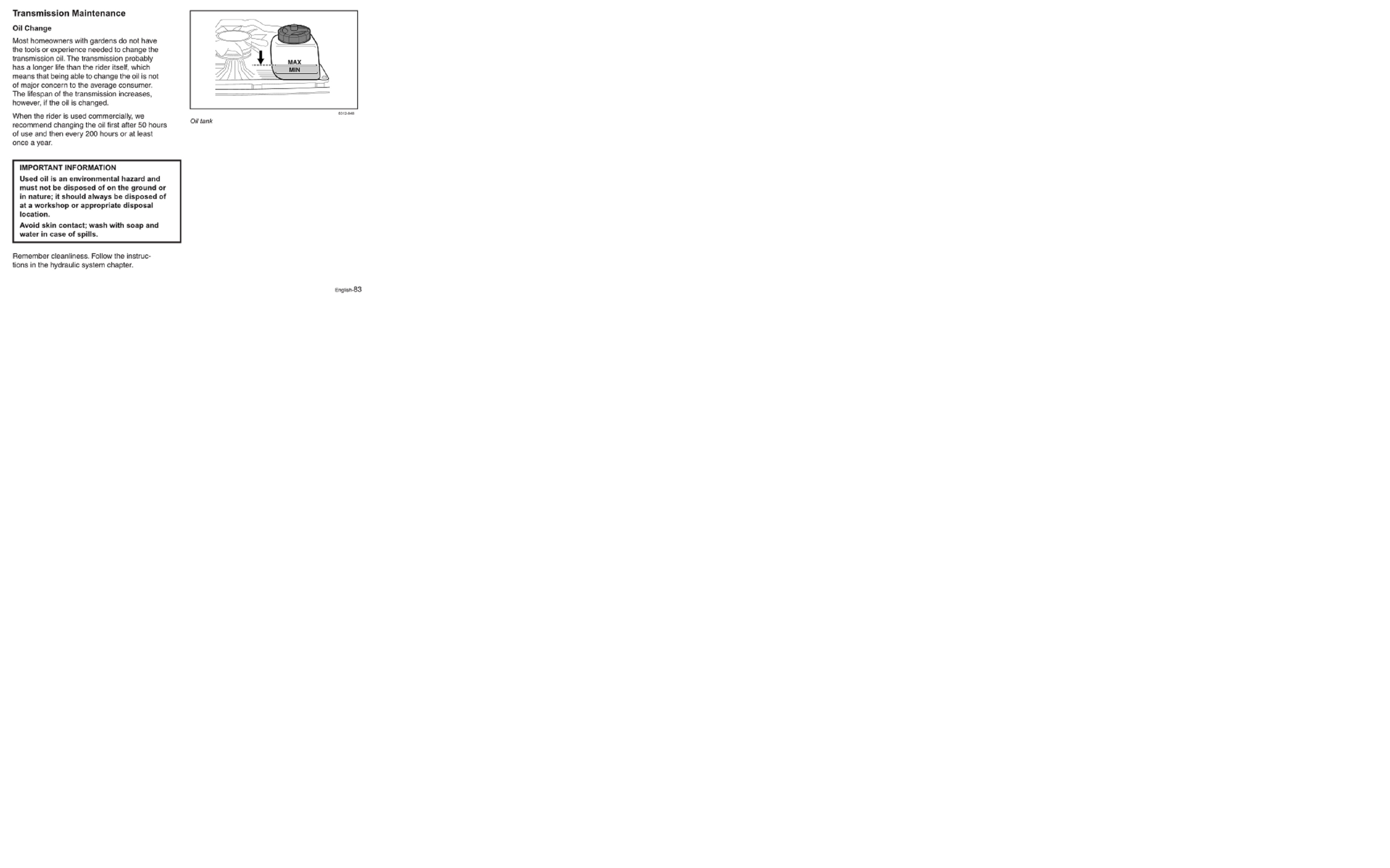

Hello guys, I just received my brand new R322T AWD and did test mowing and cant reverse if there is any incline behind me... Is this normal? I contacted dealer but they need to call husqvarna with that because they don't have much experience with Raiders. Thanks for any advice.
Max
/ Husqvarna 322T AWD #67
Not being able to back up an incline is not normal.
You may want to check your transmission fluid level.
This is what my transmission fluid level was when I received my brand new R322T from the dealer.
(Fluid level is just below the low line.)

I checked and my fluid level is exactly at low level mark. Manual says that it needs to be 10W-50 but it doesn't confirm correct level. I assume that it has to be in the middle?

Here is what my Work Shop Manual shows as the proper oil tank level.
Sorry for the tiny image, but it should magnify to a larger image as you click your left mouse button.
If you are going to be doing you own maintenance on your R322T you may want to see if your Husqvarna Dealer can get you a Workshop Manual.
There is no WSM for the R322T, but there are a couple of different WSM of other Husqvarna Riders that work very well, because they use similar engines and transmission systems.
I use a Workshop Manual for the Rider 175 AWD.
My dealer was able to get it as a .pdf file.
the part number of the manual is 115 03 16-26
