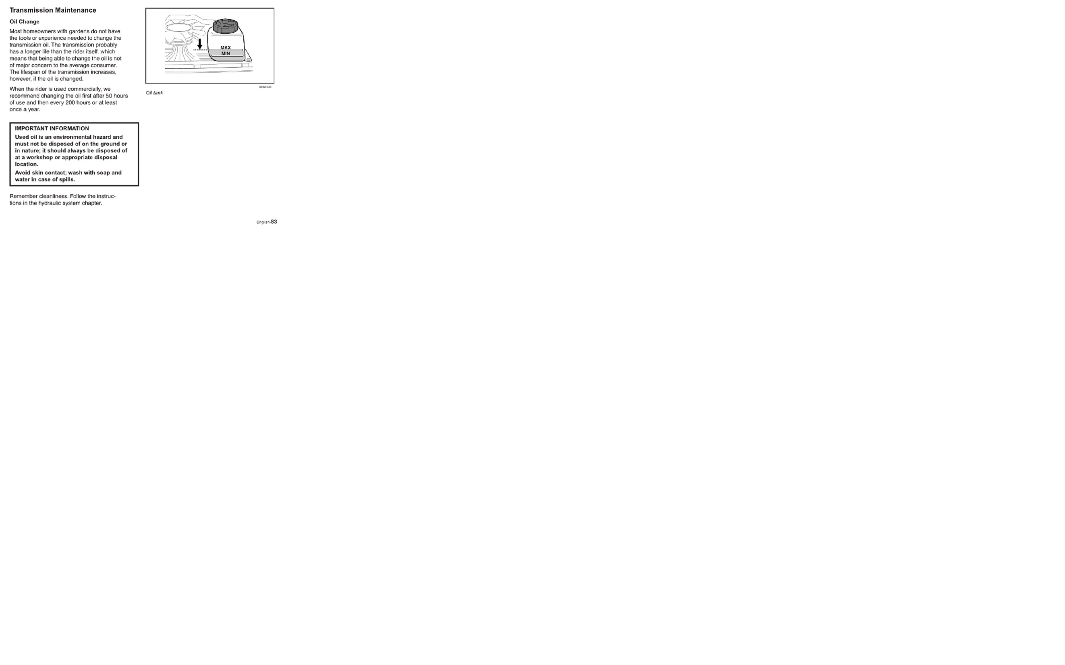

Here is what my Work Shop Manual shows as the proper oil tank level.
Sorry for the tiny image, but it should magnify to a larger image as you click your left mouse button.
If you are going to be doing you own maintenance on your R322T you may want to see if your Husqvarna Dealer can get you a Workshop Manual.
There is no WSM for the R322T, but there are a couple of different WSM of other Husqvarna Riders that work very well, because they use similar engines and transmission systems.
I use a Workshop Manual for the Rider 175 AWD.
My dealer was able to get it as a .pdf file.
the part number of the manual is 115 03 16-26
   / Husqvarna 322T AWD #72
