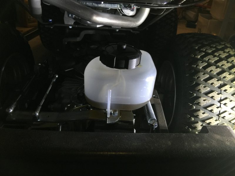

Hello guys, I just received my brand new R322T AWD and did test mowing and cant reverse if there is any incline behind me... Is this normal? I contacted dealer but they need to call husqvarna with that because they don't have much experience with Raiders. Thanks for any advice.
Max
   / Husqvarna 322T AWD #67
Not being able to back up an incline is not normal.
You may want to check your transmission fluid level.
This is what my transmission fluid level was when I received my brand new R322T from the dealer.
(Fluid level is just below the low line.)

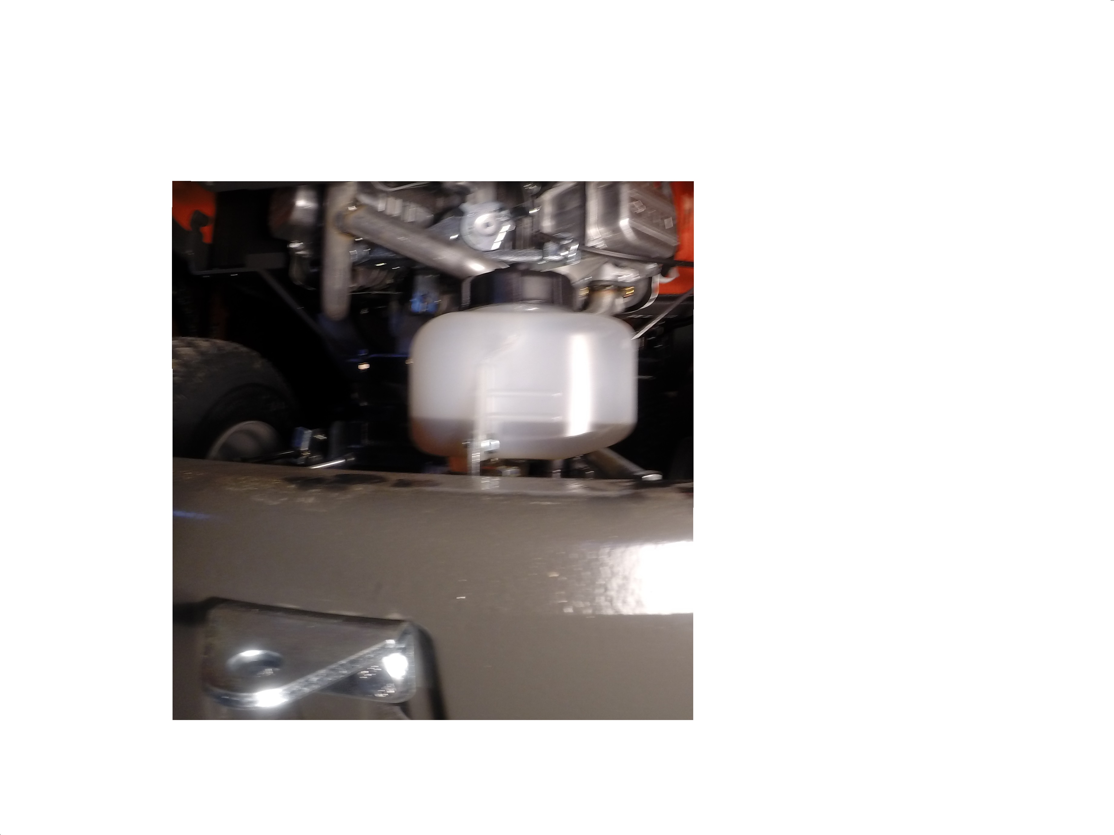

I no longer own my R322T, but when I had it I could go forward and reverse up and down very steep hills in my yard.
   / Husqvarna 322T AWD #69
Thanks for advice, will check it when I come back home.
   / Husqvarna 322T AWD #70
I checked and my fluid level is exactly at low level mark. Manual says that it needs to be 10W-50 but it doesn't confirm correct level. I assume that it has to be in the middle?
