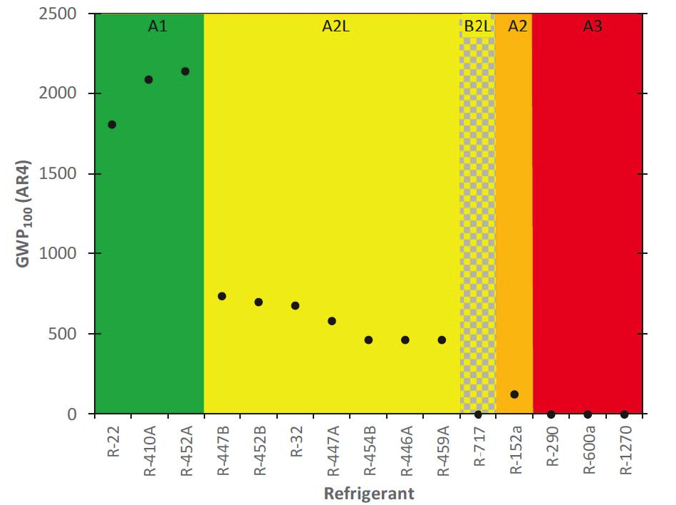

Cheat sheet;

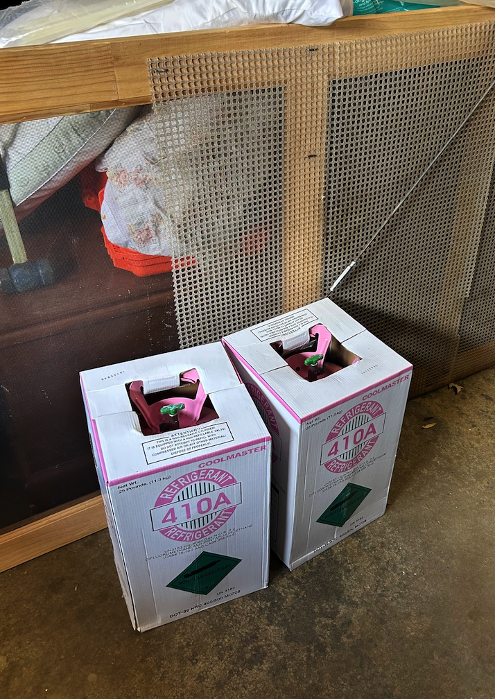

I will replace two systems next year. This is what I stocked up on for my own house for all 3 potential systems LOL
I still have a jug of R22 on one system I replaced around 2003 because I didn't trust the R410A systems when they first came out LOL (now, I have two systems using R410A).

R454B and R32 is considered a A2L refrigerant. R410A is considered a HFC refrigerant.
The new A2L compatible HVAC equipment will have a mitigation device in the indoor air handler or coil as well as "spark proof" electrical connections in the outdoor unit.

HFC is in the A1 catagory, and likewise, numerous refrigerants are in the A2L catagory.
ponytug, for whatever reason, your cheat sheet dosen't include the A2L's, which is what manufacturers will be using to produce equipment. Keep in mind, you can find R454B and R32 equipment in the wild now.
