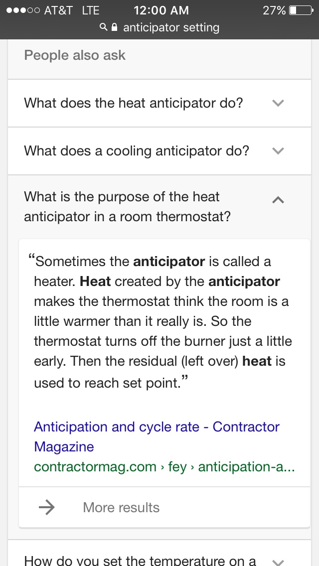

Please describe exact location you are reading 18v.ie. r-y1, c-y1, grnd.-y1? Lack of info. Btw. who did the start-up reports for warranty issues. All thermostats have anticipator settings for heating and cooling. Cooling are usually fixed. These help to minimize over and under shooting setpoint. Call the installing contractor back for this.

I am the installer/contractor. Not sure what anticipator setting is. Didn't see that anywhere in the program or user manual. I linked the exact t-stat. Perhaps there are some hidden functions that only "experts" are aware of?

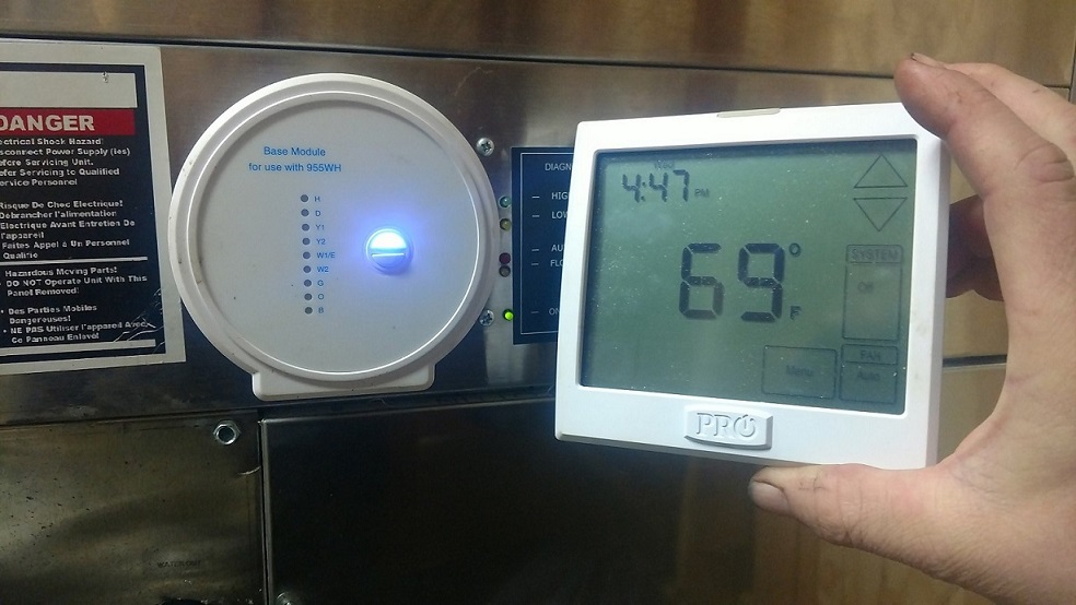

Here is what the T-stat looks like
With the base module popped off, this is what we look like

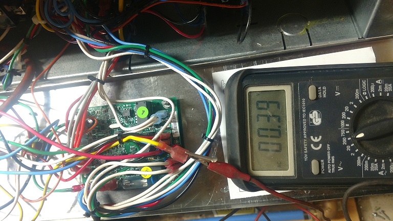

And here is the voltage reading on the Y1 terminal of the control board in the furnace

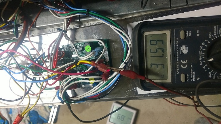

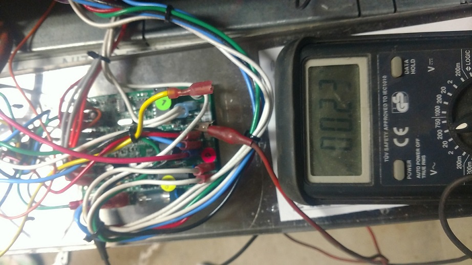

And here is the voltage of Y1 coming off the t-stat. The yellow wire goes ONLY to the t-stat and is hooked to nothing else
And here is the same reading, only with the base module pulled out as pictured in pic 2. This leaves all the wiring attached. So this confirms there is no shorted wires. There are no wires at all in the base module or t-stat that are separated. Only circuitry

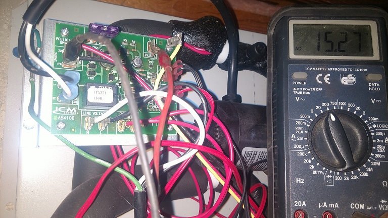

Here is the bard. Furnace is running. Currently measuring 28v being supplied to the bard, and getting 15v on the t-stat terminal. Causing it to cycle even with the t-stat wire unhooked.
So I am thinking that maybe the 32v coming out of the transformer toasted something?? In both the bard and t-stat?
