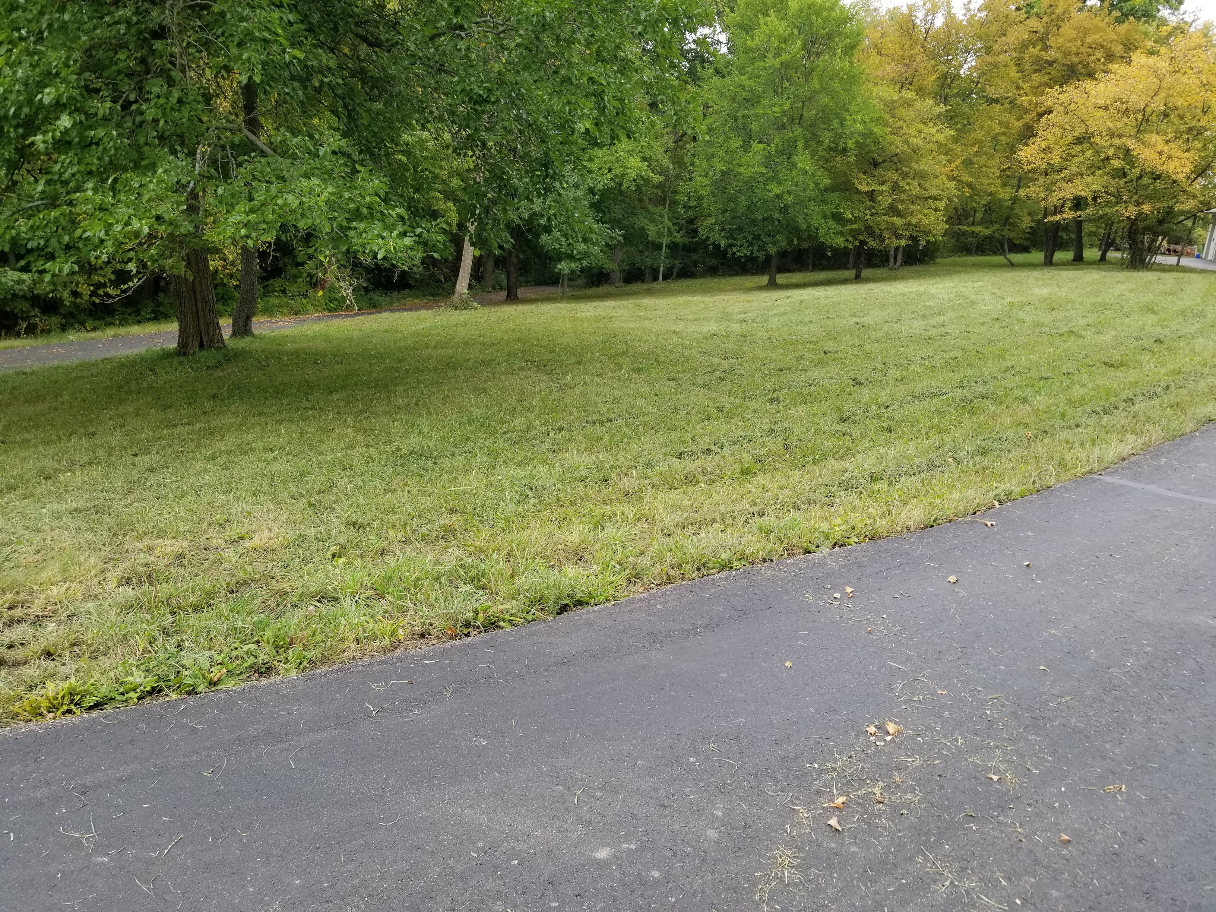

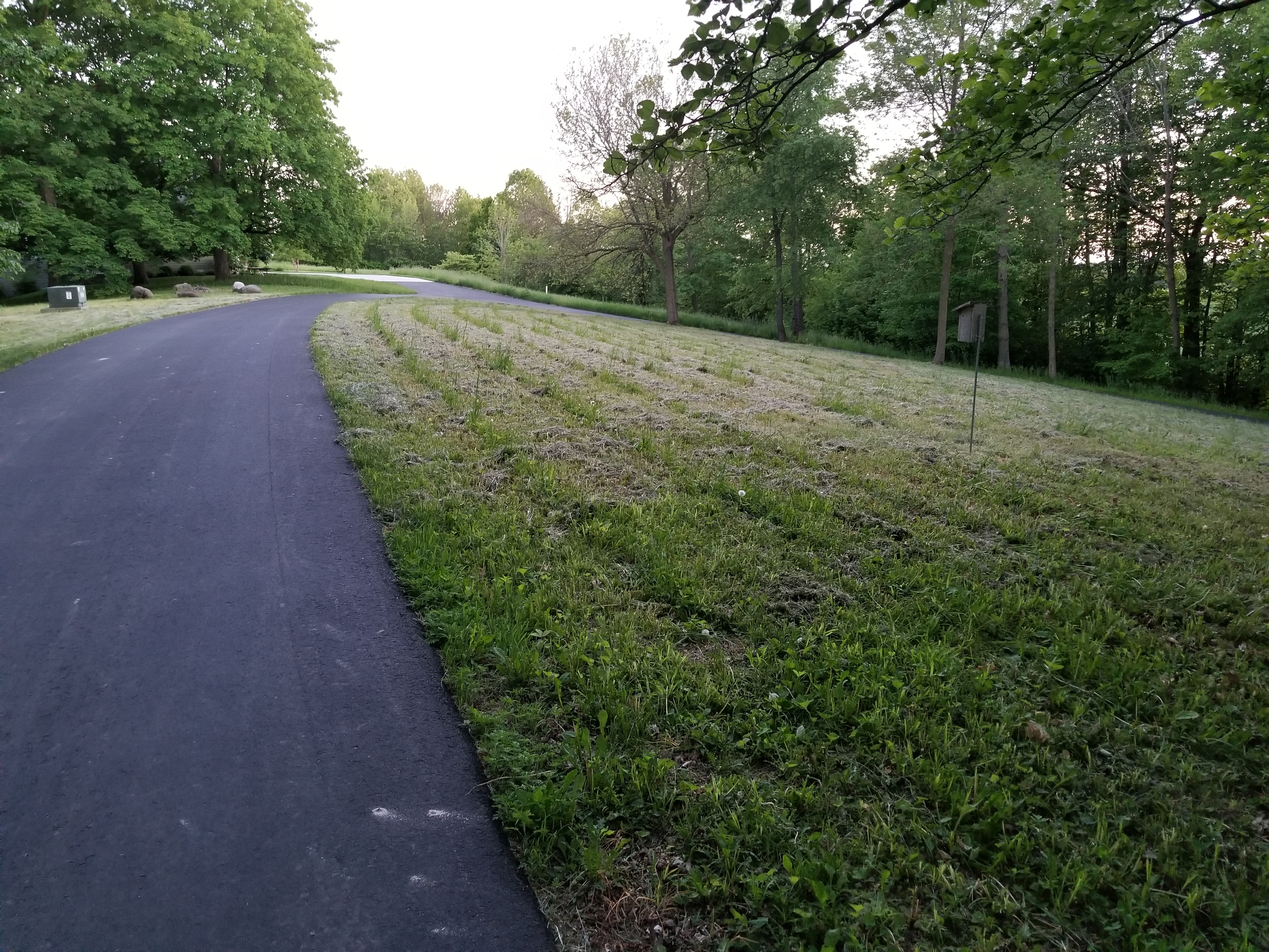

Great point! Not easily done with just one tractor. It really cuts better (I think). Here is a little area I cut last year with my 5 foot single spindle (first Spring cutting so  wimpy grass).
This was cutting 20" to 4" with minimal overlap (2 1/2' cut widths)... no matter how hard I try, i still get into the rh tire track!
Same area this year, 20" to 4", cutting full width:
Just like you said though... a mower comparison should be done side-by-side, same HOC, same speed. Kind hard for me with one tractor though!
Ok, I did visit Woods. I sent them a longer version of the video; they invited me down. Wonderful people! Know that I dont want money... I just want somebody to improve their offerings! We spent the day talking and mowing. We did some side-by-side cutting in some of the toughest 24" fields I ever seen! Woods used their smallest tractor: a 24hp pto NH and a 6' HD single spindle and a 6' rear finish. I used my JD and concept mower. The finish mower could barely get through a pass. Their 6' single was impressive but still had rh tire track. My mower did great! They showed interest; especially with its lower power consumption. Electric compacts are coming people 8<(

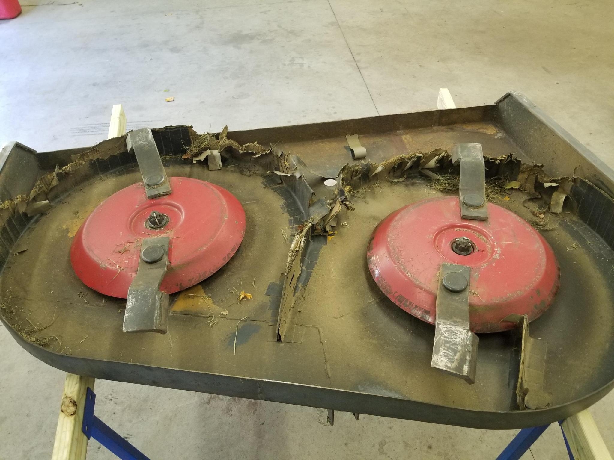

Just like we used to design finish mowers, I started with no baffles underneath.... and just like every conventional rotation 2 spindle mower I've ever seen: the front spindle wanted to hand off all of its discharge to the back spindle! Baffles were needed. I started adding baffled using cardboard and duct tape and testing until the cutter started to behave. Then the baffles were reproduced in steel.

How did you go about doing that?
Looks like a fun project.
I remember new engineers at Deere commenting "I went through 4 years of engineering school to play with cardboard???" Yup. I used to laugh and tell them "This is all covered in chapter 6 of my duct tape book. You'll be expected to read it." They'd just stare 8<[
Yes, ugly. Wish I had a "before" pic! You start by "shingling" the cardboard with duct tape. Shingled so airflow behaves like water down a roof... then shingle it onto the deck. I started with the bare minimum baffling... then into the grass for a test run. Soon it was apparent that full skirts would be necessary. Once the test cut looked good I went right off cutting a larger area... didnt hold up too well did it? ;<)
The baffles not only channel material, they add lift. Note the ring baffles were held just into the blade wing height. Just like radiator fan shrouds, maximum flow is found there.
