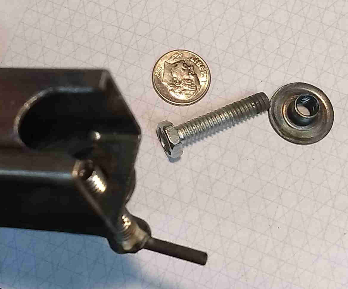

/ Hyd quick disconnect
Thanks for all the replies.
I decided to try and make a tool. This is what I came up with so far.
I used a 1" OD square tube to start and notched it out. Then welded a weld-nut to the pilot hole I drilled a little more than 1/4" from the end.
My only complaint with the tool is that the hyd. coupler is a little squirrelly in the slot but not too bad.
