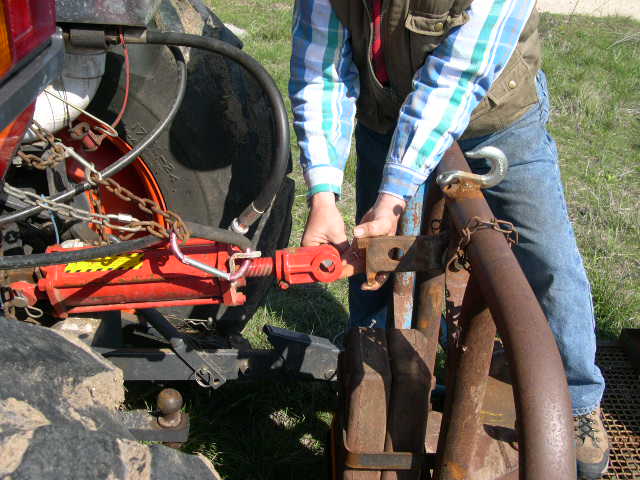

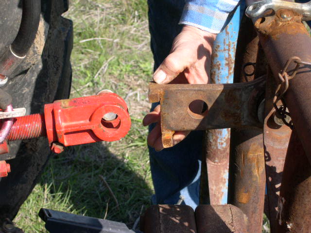

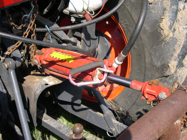

I don't know what bushing you used but Surplus Center has a perfect bushing for those cylinder. I installed two of them in my cylinder that I got from Surplus Center. They are driven in and stay in place. If anyone else does get a cylinder from SC, get the bushings from them also.

I have very little drift if any. They only thing that I don't like about the Surplus cylinder is that the ball on the cylinder end is to close to the cylinder. I have to put the cylinder in the top hole on the tractor to keep the cylinder from turning into the tractor bracket and cutting into the cylinder. I may at a later date, buy a cylinder from Mark.
