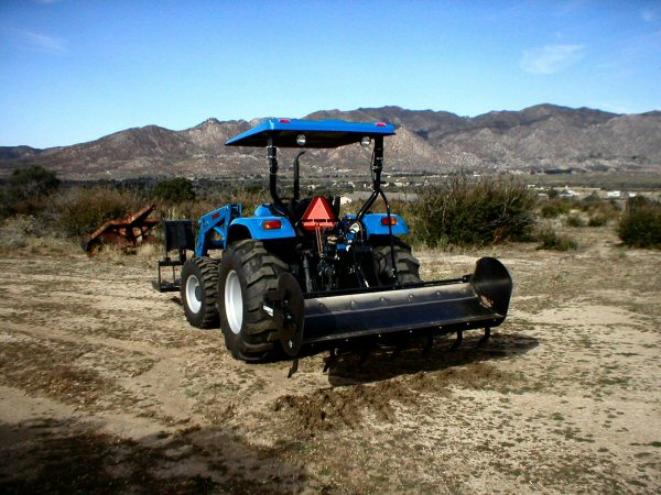

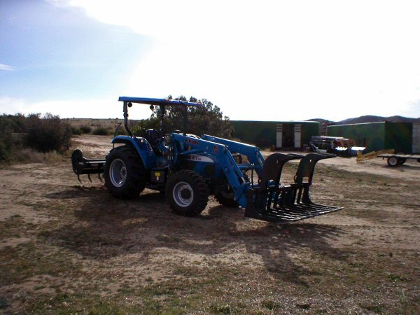

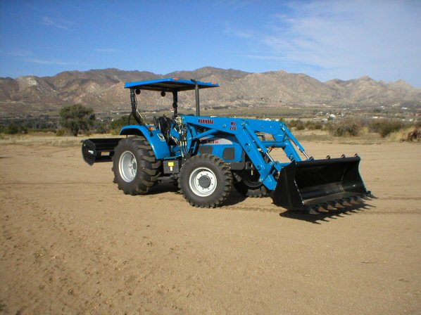

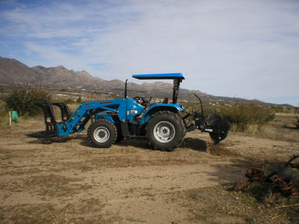

Chuck, here is the information that I have that you asked for. Unfortunately I do not have any specific pictures of my rollover scraper.:( Here is a link to Gannon's industrial scraper. I have a few pics that do have my scraper shown, but only in 2 of the 3 positions. Sorry but I have none with the scraper in the back fill position,:eek: which also is used to pull forward and smooths very very good.:) The scarifiers go into the ground 10" :eek: and depth is controlled by the 3PH. If the ground is right, it will stop my 10,000lb tractor cold.
Radman1, you have both types of scrapers, if you were to have only one, which one would you prefer?
Anyway, here are a few pics.:D
