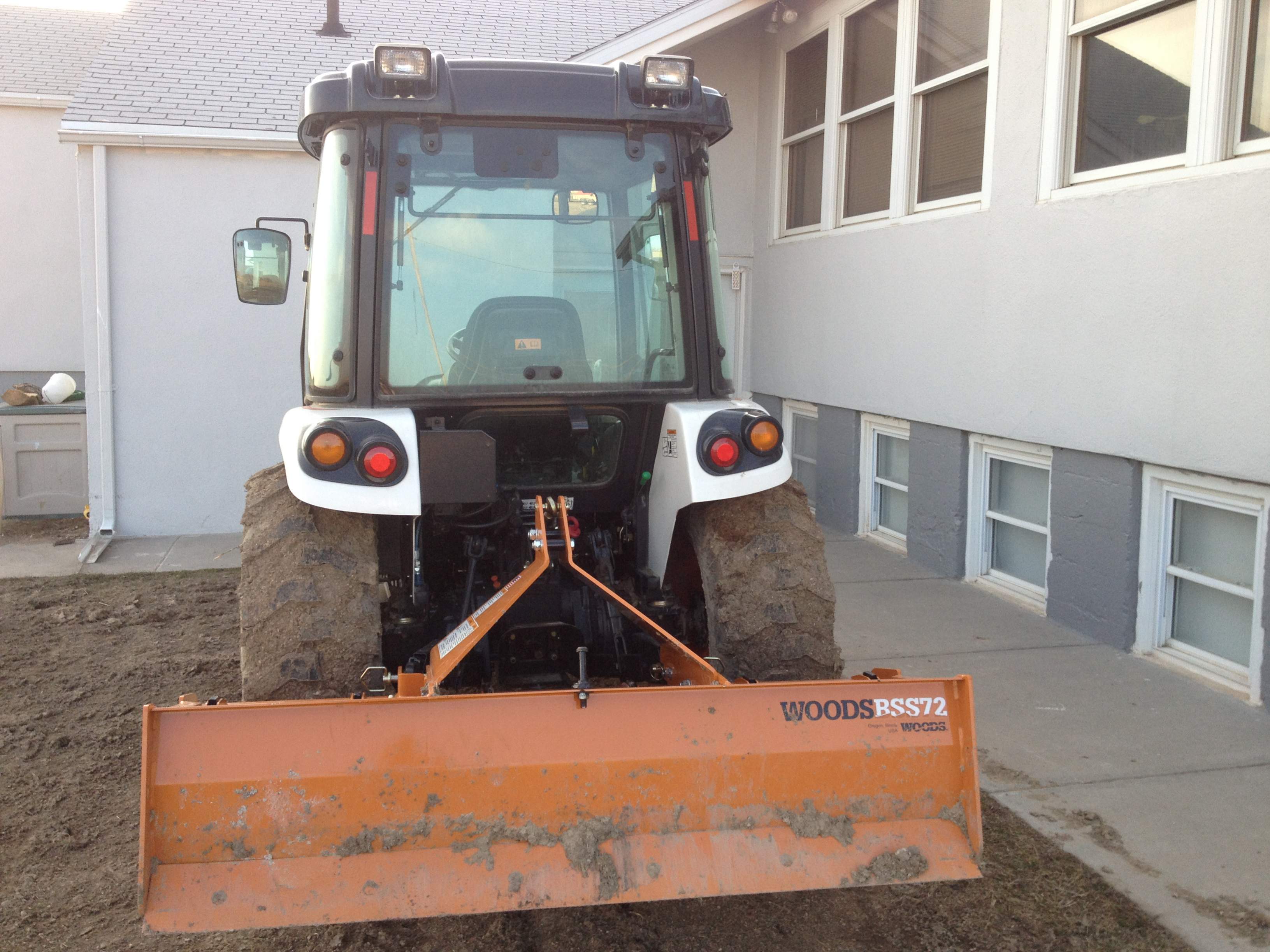

I ran across a Stanley CS06 hydraulic chainsaw that I was interested in using with my tractor, 45 HP Bobcat. I believe I have around 8 GPM and 2,000 psi at my auxiliary hydraulics which falls within the 7-9 gpm range and 1500-2,000 psi for the saw.

Not sure if this is even possible but if so the question is what size and how long could I go with the hoses to run the saw without really hurting performance? The saw comes with a short sub hose that is 1/2" but it has a 3/8 npt fitting that goes into the flat face QC. Essentially they hook directly to the saw and are about a foot long. The QC fittings are on the end.
I was thinking I could use 1/2 hose but after seeing the 3/8 NPT fitting on the QC I wasn't sure if that was necessary. I figured that the fitting would essentially act as a restrictor making the use of 1/2 hose unnecessary but OTOH I wasn't sure that it might not be a good thing for a longer run. I'd like to run at least 15-20 ft of hose and probably more like 25-30 if possible to have some range from the tractor. What size and length would you recommend for this application?

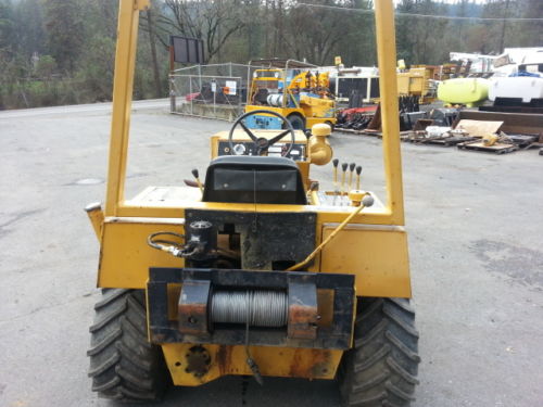

I was looking at a little vermeer 430a trencher turned skidder I recently purchased and wondered if there was any possibility of putting a diverter on the line that feeds the hydraulic winch to feed the saw? And if so do you have any idea what kind of flow this machine might make, it has a 20 hp deutz? The winch is a ramsey 5,000 pound.

Look at your saw and see if it is open center hyd or closed center hyd.
In an open center hyd system, all the valves should be in series,
In a closed center hyd system, all the valves are in parrallel.
20 HP can drive a 10 GPM pump at 3000 psi if that is all it did.
Depends on your system whether you can use a diverter.
A diverter can make your valve operate two independent operations.

roadhunter,
I found out the difference about the open and closed center hyd.
If there is an adjustable screw slot, you can select the open or closed center setting by turning the screw.
The letters stamped might be X for closed and O for open center hyd system.
If no screw selection, look at the saw input area for the letters O or X.
I have a hyd chain saws that is closed center.
I also have about 7 or the hyd cutters with about a 2 in cut the tree trimmers use.
I also have a backpack hyd unit for a hyd rotary saw.
You also need a relief valve set for around 2000 psi.
