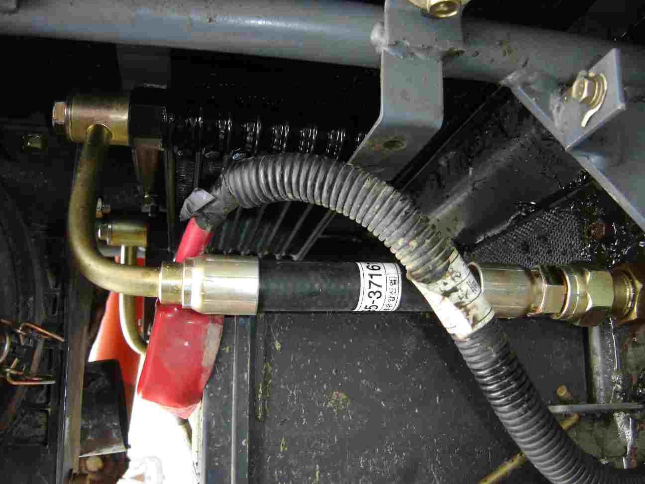

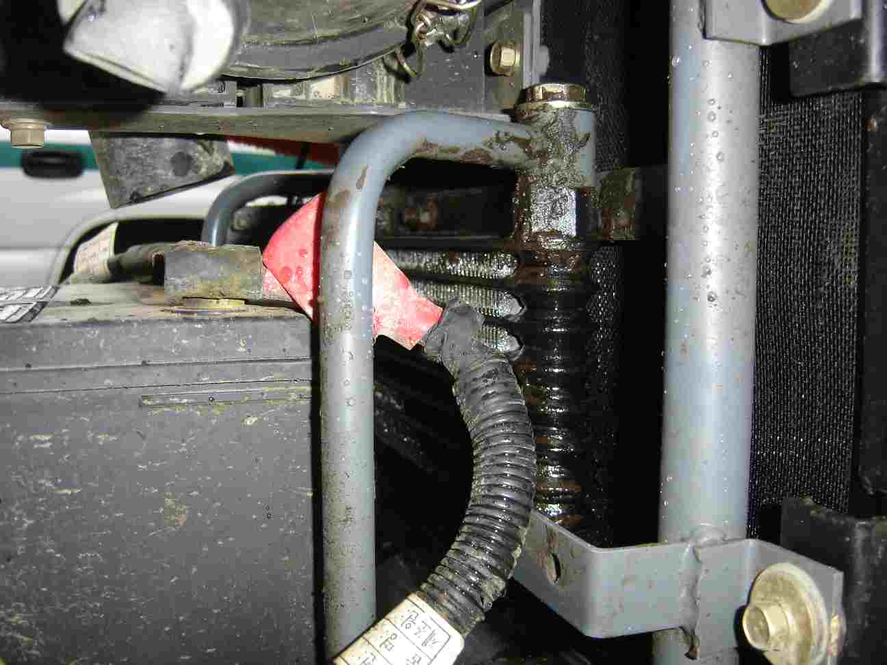

Here's before and after pics so you can see the different hoseline.

Brad, my hose line is the same as your before line change. I believe I could do the replacement as you did but I will give the dealer another chance. I will call the more flexable line to his attention. Thanks again for the info.
   / Hydraulic cooler on my CK25 #8
Kioti Daedong heard you and fixed it, at least on the new CK30 HSTs. They now have the flex lines to the cooler. Since they know it was a prob, your dealer should fix it and try to get reimbursed fm the manf'r.
