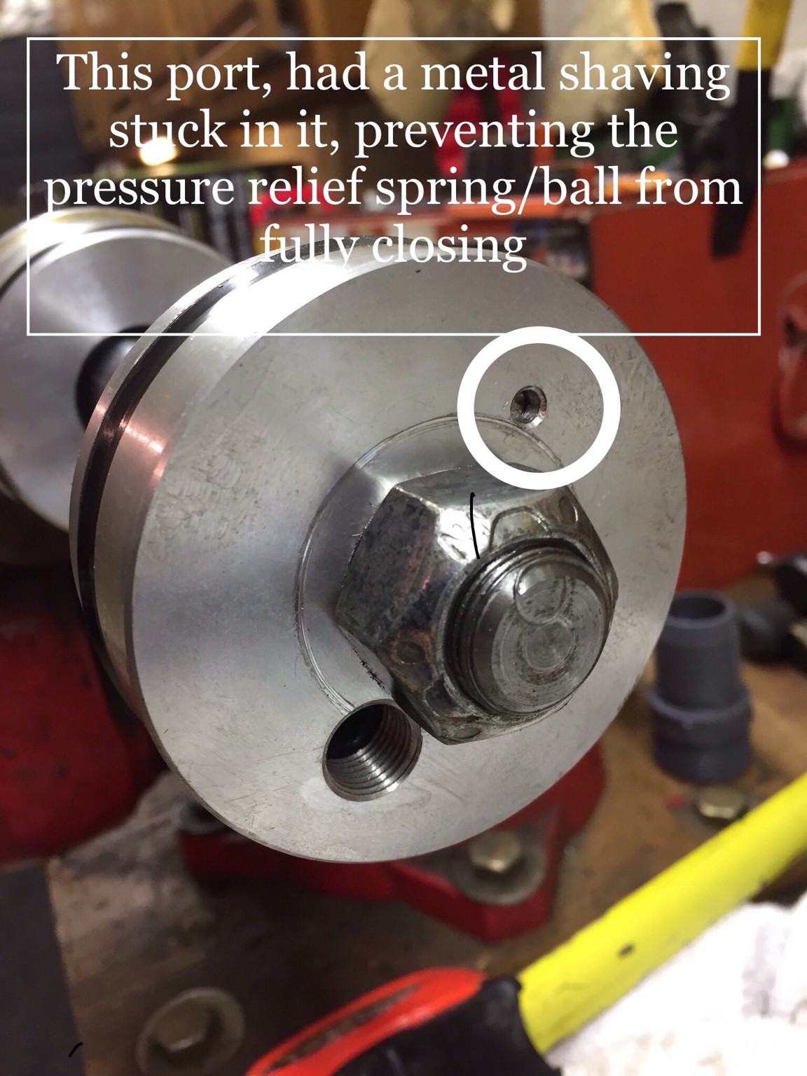

Well, it wasn't a leaking seal.
I did replace all the seals thinking that it was the problem originally, after tearing into it the originals appeared fine. On top of that, the exact same thing was happening before and after the new seals. This pretty much ruled out the seals.
I tried bleeding the air out and functioning the cylinder numerous times. I really didn't think there was air in there but wanted to make sure.
What the problem was, was a small metal shaving (I think it was a piece of the threads that must have stripped somewhere) that got stuck in one of those really small ports that the spring/ball check valve normally closes off.
That small shaving wasn't allowing the steel ball to seat and seal the port closed. I took it out and it probably would have been fine, but I ended up JB Welding those ports closed permanently.
I put it back together and tested it out, instantly it did feel better and a lot more solid. It didn't have any give in it. I know I don't know a lot about hydraulic cylinders but I'm fairly certain that neither the seals, or air entrapment was at all a contributing factor. However, all the tips and advice pointing to those is what ultimately led me to find the actual problem.

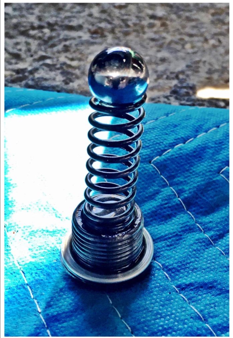

The rod end cap (the "inner" one, or whatever it's called) has two pressure relief ports in it. The pressure relief is made up of a stainless steel ball, a spring, and a set screw.
Like this...
I imagine the pressure relief is adjusted by screwing this set screw in/out to compress the spring more/less. The ball seats against the backside of the small hole that you see in the picture below...
Since the metal shaving was preventing the ball from seating, it was partially open all the time, allowing free communication of the hydraulic fluid to flow from one side of that cap, to the other.
Basically, it's as if I drilled a 3/16" hole in that rod end cap, leaving an easy way for the fluid to flow back and forth. This is why I think the cylinder was extending on it's own so quickly, even when the hoses were disconnected from the tractor.
I could be COMPLETELY wrong with this, but it's how I understand it.

It's entirely possible that it was just air, I just don't think it was. Here is my (not very confident :)) explanation....
Like this...
