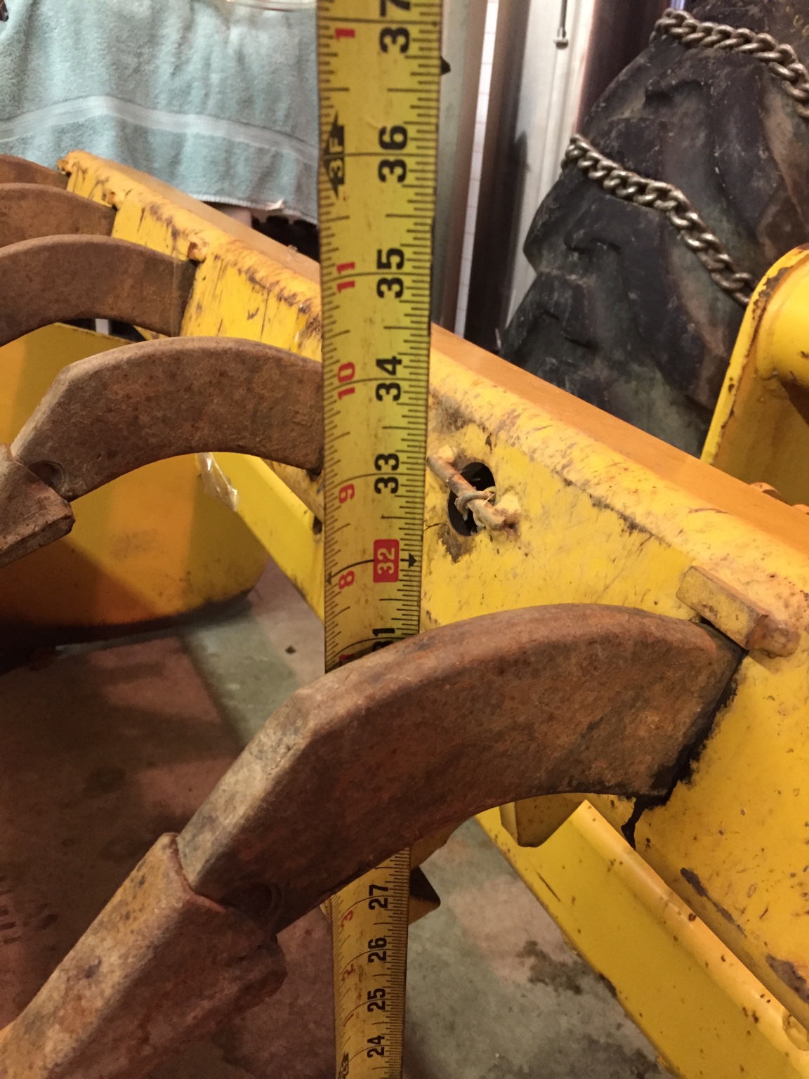

You already proved it. You rebuilt the cyl and got rid of the air and it started working.
   / Hydraulic Cylinder Leak Down on Box Blade??? #84
Since a small shaving was stuck in the piston valve it is feasible that the shaving was holding the valve "cracked open" so the fluid exited through this valve slowly. Air space on the back side of the system allowed this fluid to escape. That is my opinion or gut feeling as to why the cylinder retracted slowly along with simple friction.
Very possible.

If the flow through the hydraulic system is higher than the flow thru the piston holes you can develop back pressure and have a limited amount of force. Gravity does most of the work lowering the rippers, you only need a small amount of force to latch the rippers in place. The rippers need to be clear of the ground to latch properly, the cylinder does not develop enough force to push them through the ground or raise the box blade. This is to prevent damage to the linkage imo.
I have to say after participating in the thread that I went out and played with my box blade (same identical model) which is in good working order. It is obvious to me that the purpose of the valves or holes in the cylinder piston is to limit the force the cylinder has on the linkage. With the rippers down in the latched position the cylinder is fully retracted. If you miss the latch and drive forward the rippers will swing up instantly at the same time the cylinder is extending with the oil moving from the rod side to the back side. This will happen with the spool valve in neutral position. With the piston ports blocked if you miss the latch and drive forward as above the linkage rods are being compressed and will bend up.
All of that said the piston valves or holes (probably one way check valves) are there to protect the linkage from damage.
I have no comments about the JB weld as I have no experience with it.
