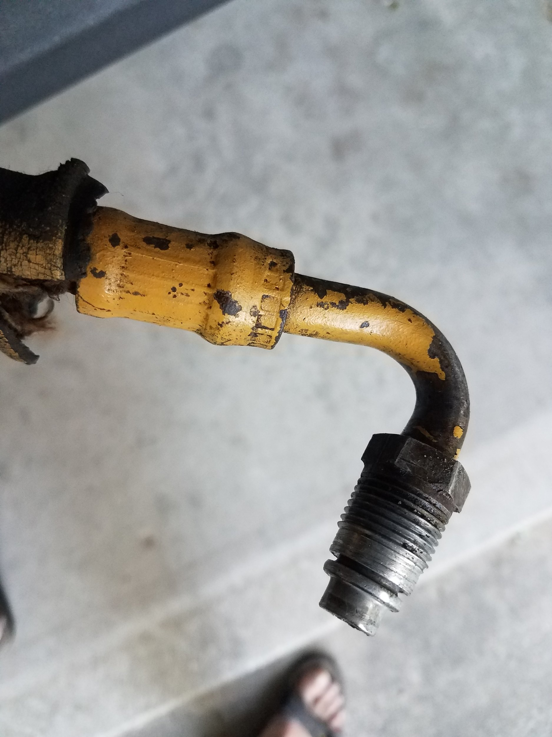

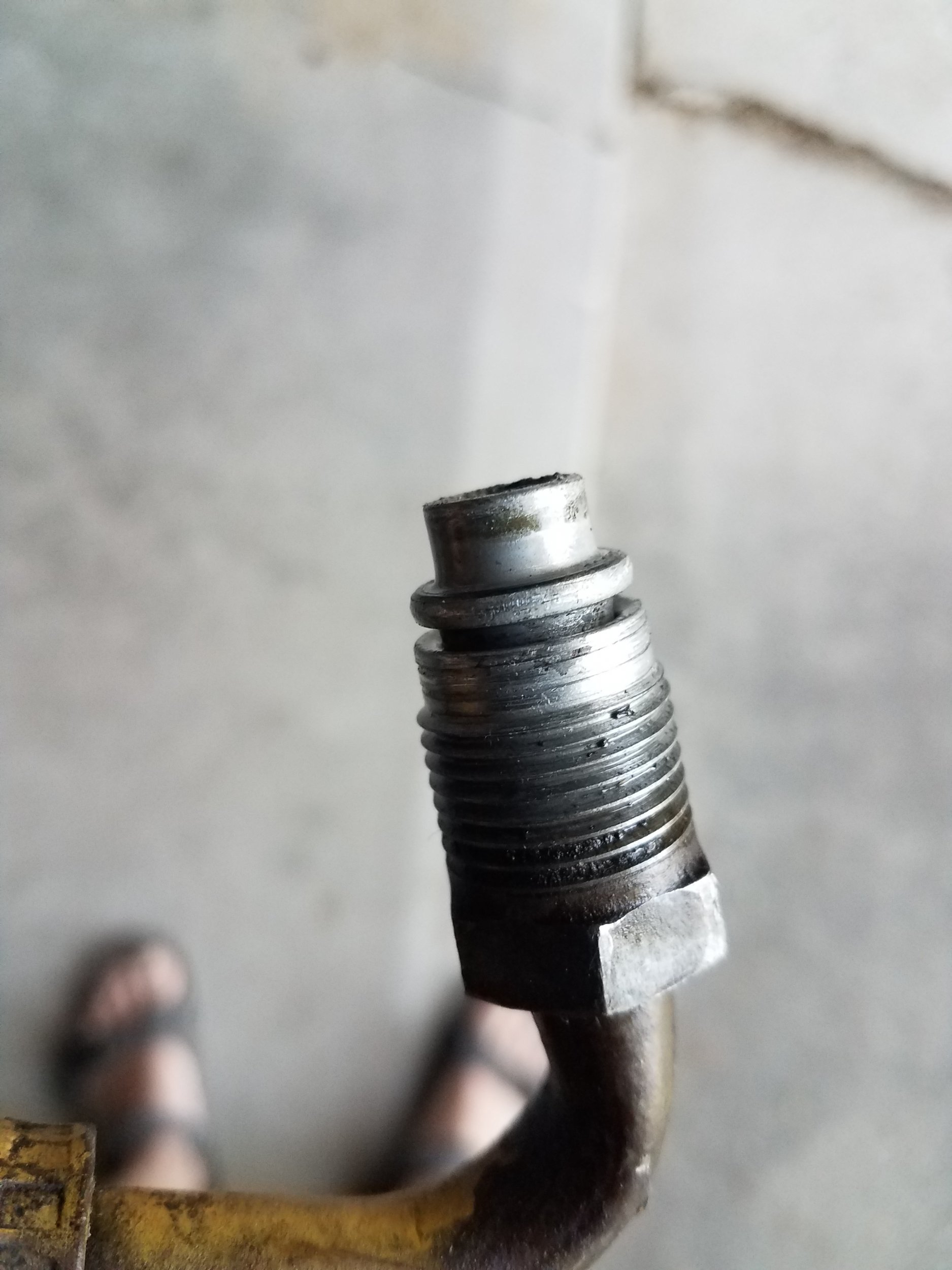

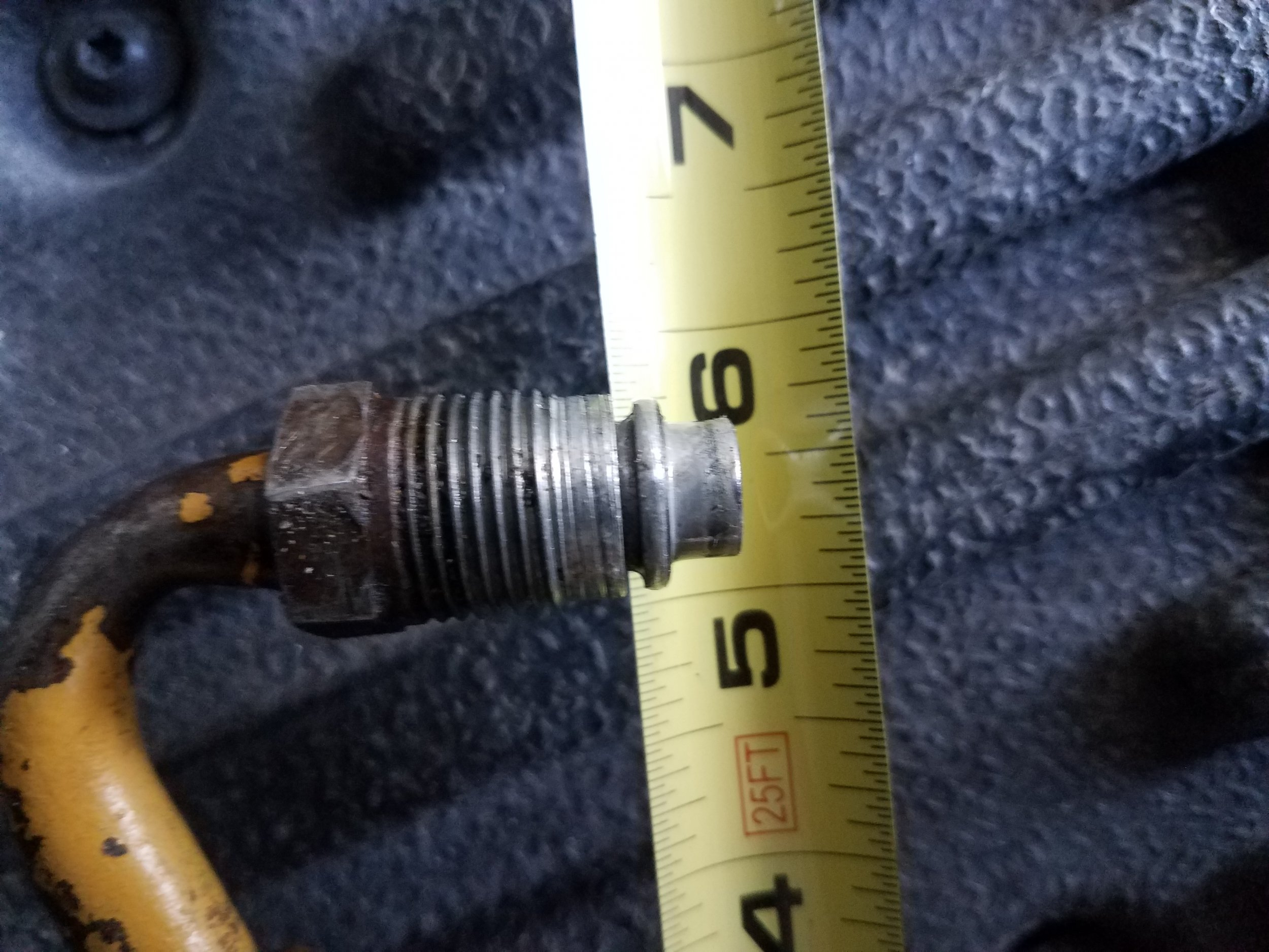

I blew a hydraulic line on my old Massey Ferguson loader. I believe it is a Model 100 loader.
None of my local shops can ID nor do they have one of the fittings.
I'm hoping someone here can give me an ID?

It looks like some type of flare rather than a separate fitting...
   / Hydraulic Fitting ID?
I'm not sure I follow?
It does look like some sort of flare, but it is all one piece crimped onto the hose.
Here is a pic of the entire thing.
   / Hydraulic Fitting ID? #4
Looks more like an automotive oil fitting than hydraulic. Merc oil cooler lines
   / Hydraulic Fitting ID? #5
Is there an o ring in the female end? I've seen stuff like this in oil and AC applications just not in hydraulic, but there is always a first.

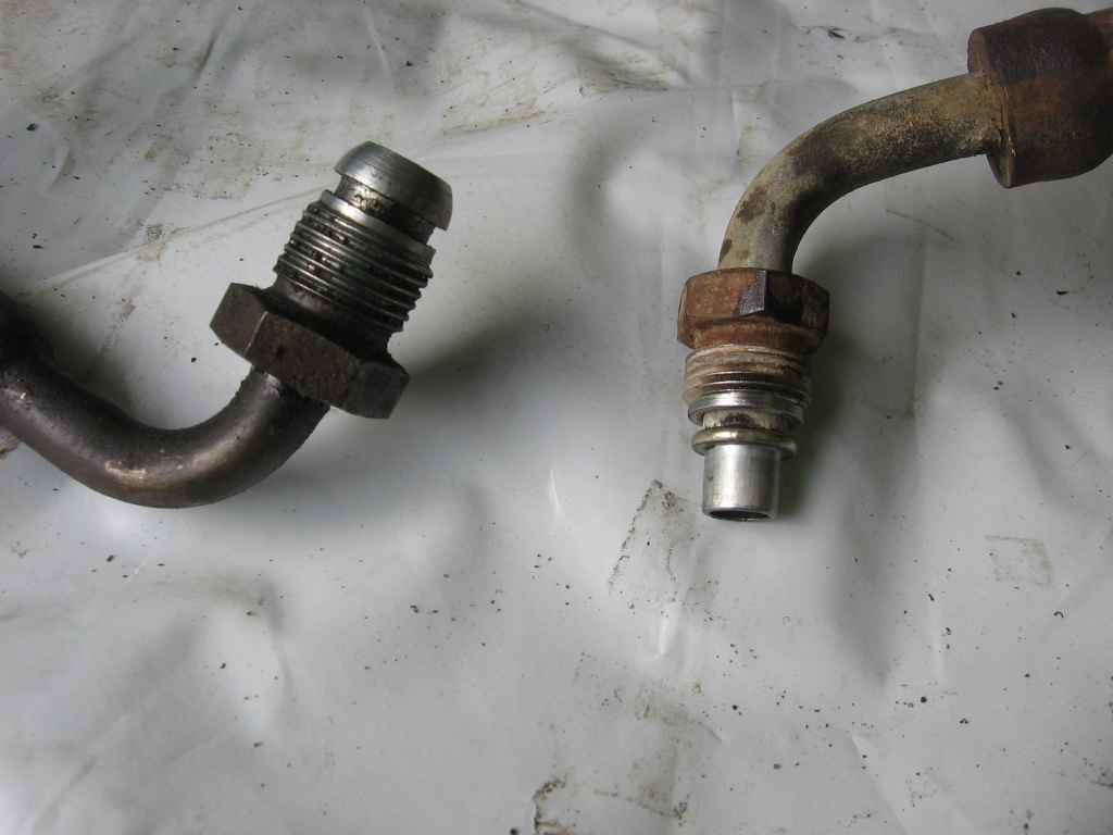

I did find this but it's aluminium and for AC I believe. Now they "may" been made in steel years ago and work for Hydro. I don't know and YMMV but it may provide a clue.
Boy, that does look similar. Mine is steel.
There was no o-ring on it when I took it apart.
That does not mean it should not have though. Some one in the hydraulic shop asked the same thing.
   / Hydraulic Fitting ID? #9
If you have to improvise...compression type fittings may be an option using the original end...If the tube part is a typical size...
I have a feeling that someone "improvised" on this already. That is how this part got in there. :)
