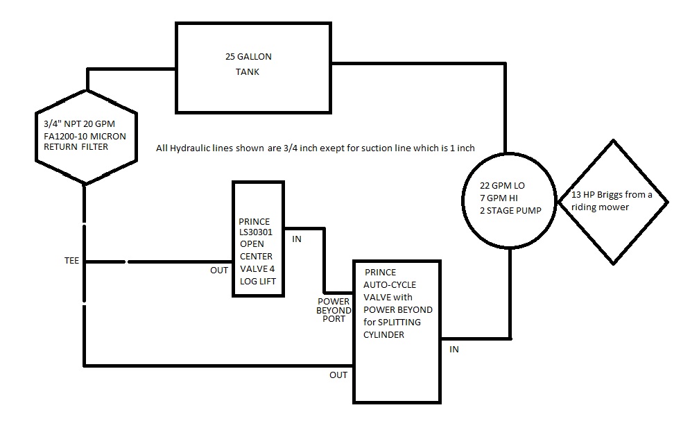

I found some information at surplus center which now has me confused regarding the fittings I need to use for my log splitter project. So here are some questions about hydraulic fittings.
1. whats the difference between NPT & NPTF ?
2. the surplus center information said the best connection should be with SAE o-ring not with NPT.
3. can you get cylinders and valves with SAE o-ring ports ? I only see them with NPT or NPTF ports.
4. does everyone just convert at the connector NPT to SAE and then back again ? this doesn't make sense.
5. what do you guys do ?
I can go on and on with the stupid questions in my novice lay person knowledge of the subject matter so I will stop as I think you all understand my confusion by now. :confused:
Please help.
Thanks,
-unixkid

Here's a BIG start -
http://www.discounthydraulichose.com/v/vspfiles/downloadables/thread_guide.pdf
NPT is National Pipe Tapered - NPTF is National Pipe Tapered Fuel - compatible enough to interchange, but needs sealant or it will leak.
SAE O-ring, aka ORB, are much better than NPT - with a 90 deg. fitting, you can point it whatever direction you want and THEN tighten the lock nut which pushes against a flat washer which pushes against the O-ring which makes a leak proof seal pointed the direction you need it. Try that with NPT, it'll almost never point where you want it and seal.
Some cylinders come with SAE/ORB fittings, some with BSPP (British Standard Parallel Pipe), some with NPT, some may even come with JIC 37 deg. fittings. Last two I bought, one was BSPP with an included adapter to ORB, other was NPTF and I'll add NPTF to JIC straights and JIC male/female elbows so I can point them where I need them.

On a lot of my stuff, I like to have my hoses wind up being JIC female. So frequently regardless of the connections of components, I find adapters that match the component threads, but have JIC male on the other end. That's just me. I keep spare hose and a spare reusable female JIC fitting around of each type in case I break one. That way, I can usually fix any busted hose issue without having to go to town. I do keep some JIC male reusable in case I have to cut out a piece of hose and patch temporarily, but I really don't see that happening.

1 See BukiCase's post
2 Agree. NPT ok- SAE/ORB superior. JIC great-ORFS superior.
3 Yes. You can find cylinders with SAE ports at Surplus Center and other places.
4 Some use NPT since it's the least expensive. I think adapters make sense. I use them.
5 I tend to avoid NFT fitting, but if a cylinder or valve had them I would use an adapter so I only put the adapter into the cylinder or valve once and leave it. Same as EE_Bota I like hoses with female JIC swivel fittings. Easy to find, can be taken a part multiple times, seal better than NPT. So I would use adapters. Next step up from JIC fittings are ORFS fitings.

for those of you NPT haters.. they do make swivels with a sealing shoulder.. so once you get the taper section secured and not leaking int he parent material.. then you can tighten the swivel yo your hose and go.

The dash "-4,-6" is the diameter in 16 ths of an inch. Also next time your in a pinch and all you have Is a jic fitting and an orb/sae port just grab a bonded washer or oring and your back in business, they both have sae threads just the sealing surface is different.

Unixkid:
Think of hydraulic fitting types in the same manner as the numerous flavors of UNIX/LINUX out there...confusing as he!!. My only advice is to avoid NPT fittings if at all possible as NPT is evil in my book. Also, don't make the mistake of using NPT plumbing fittings from Home Despot in your hydraulic system. Plumbing fittings aren't made to the same exacting standards as hydraulic fittings are.
